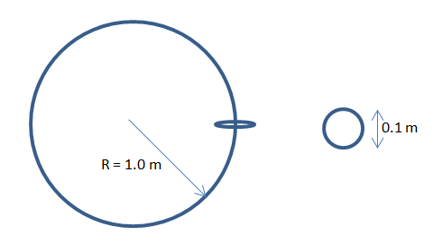

SS-V: 2080 Circular Ring - In-plane and Out-of-plane Vibration
Test No. VM09 Perform normal mode dynamic analysis of an unconstrained circular ring.
Definition
The units are SI.
- Properties
- Value
- Modulus of Elasticity
- 2e11 N/m2
- Poisson's Ratio
- 0.3
- Mass density
- 8000 kg/m3
