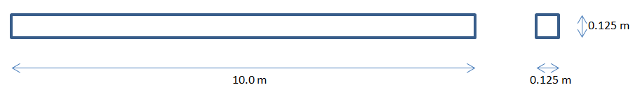

SS-V: 2070 Cantilever Beam
Test No. VM08 Perform normal mode dynamic analysis of a cantilevered beam.
Definition
The left end is fully constrained; the back face has a slider constraint to remove the third dimension.
The units are SI.
- Properties
- Value
- Modulus of Elasticity
- 2e11 N/m2
- Poisson's Ratio
- 0.3
- Mass density
- 8000 kg/m3
Results
Reference Solution | SimSolid | % Difference | |
Mode 2 [Hz] | 6.327 | 6.323 | -0.06% |
Mode 3 [Hz] | 17.720 | 17.683 | -0.21% |
Mode 4 [Hz] | 34.720 | 34.594 | -0.36% |
Mode 5 [Hz] | 57.390 | 57.063 | -0.57% |
Mode 6 [Hz] | 85.730 | 85.017 | -0.83% |
