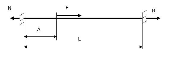

Bar dimensions are 10 x 10 x 200 mm. Distance between loaded point and left end A=50 mm. Strain-stress curve of the bar material is defined by the power law:(1)

One-dimensional analytical reference solution is described here.
The length of the bar does not change under the load.(2)
A0ε1dx  LA0ε2dx = 0
or,(3)
A0nN/(K*A)dx  LA0n(FN)/(K*A)dx = 0
Where,
ε1
Tensile strain at the left span of the bar.
ε2
Compressive strain at the right span of the bar,
N
Reaction force at left end of the bar.
R=FN
Reaction force at the right end of the bar.
A
Bar cross-section area
From this equation you can find the reaction at the left end of the bar.(4)
N = F/(1+(a/b)n)
and R = FN at the right end.

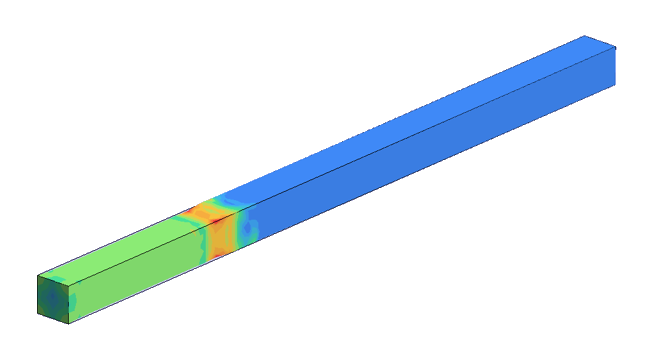

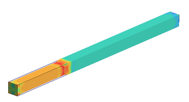

Typical von Mises stress distributions are shown in Figure 4 and Figure 5. The distribution has high gradients at load application lines; yet the reactions values correlate to the 1D solution because the reactions are applied far from the active force.
Figure 4. von Mises stress distribution at load F=30000 N
Figure 5. von Mises stress distribution at load F=60000 N
