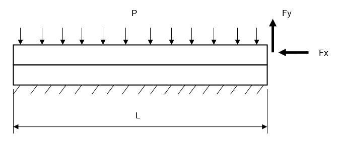

Two similar beams with dimensions 10 x 10 x 100 mm are in contact (Figure 1).

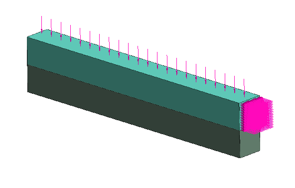

Five load cases are considered. In all load cases the lower beam bottom is fixed, the upper beam is loaded on its top with total vertical load of 2 N uniformly distributed over the surface. The right end of the upper beam is loaded either with vertical load Fy or with horizontal load Fx uniformly distributed over the surface.
Load Case Fx, [N] Fy, [N]
1 0 1
2 0 0.9
3 0.3 0
4 0.31 0
5 0.29 0
Beams were simulated as two solids (Figure 2). Contact condition at the connection was set to "Separating" with friction coefficient 0.15.

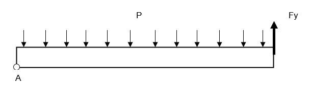

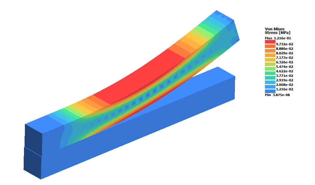

    Consider the equilibrium of the upper beam. If Fy =0, then force N is equilibrated by the reaction force in contact. As Fy grows, the beam deforms, and the contact separation starts at its right end and expands to the left. Ultimately, the contact fully separates and contact area degenerates into a line (point A in Figure 3). The value of force Fy which results in full separation can be found from moments equilibrium equation.(1)
    M(A)=P*(L2) Fy*L=0
    This ultimate value is Fy =1 N.

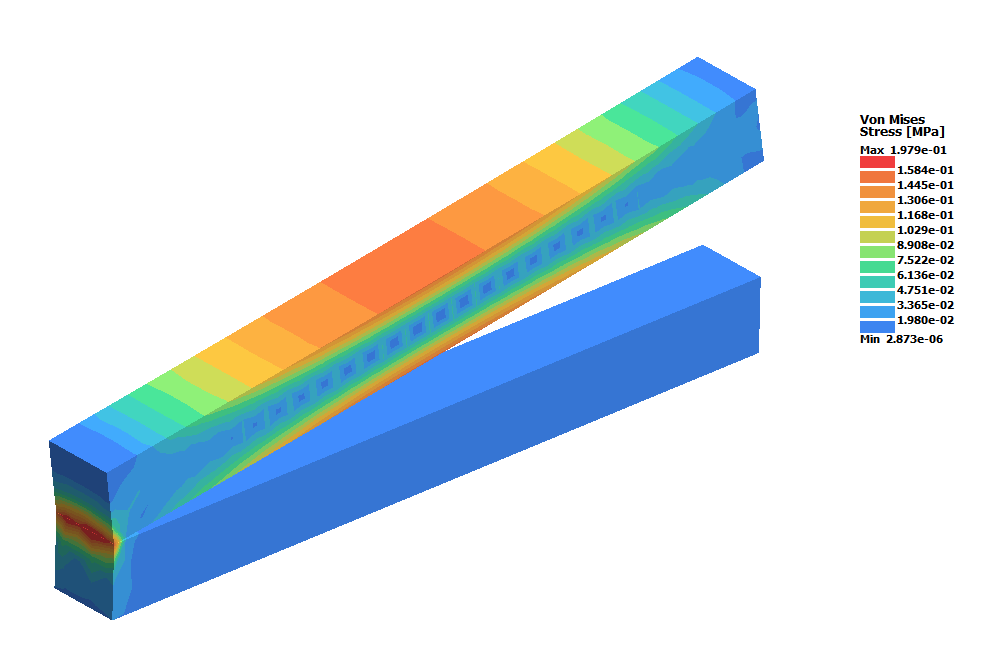

    SimSolid result for this value of Fy is shown in Figure 4. Full separation occurred and the contact occurs only along the single edge which causes stress concentration at the beam corner.

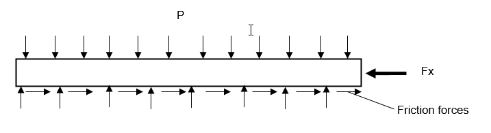

    In this load case, normal separation does occur because there is no detaching force - Fy =0. Shear force Fx tends to cause beam slippage which is resisted by friction forces distributed over the contact area. In equilibrium the force projectes onto the horizontal axis:(2)
    FFx=0
    Where, F is total friction force.
    Maximum total friction force is:(3)
    F=fP
    Total slippage (or total tangential separation) starts when Fx f*P . When Fx< f*P , only partial slippage is possible. Maximum total friction force is Fmax=0.15*2=0.3 N .

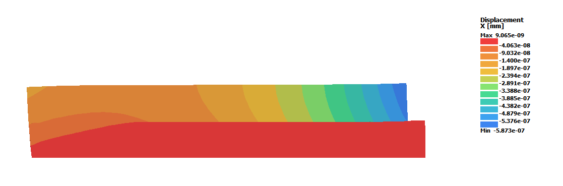

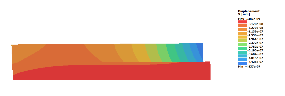

  • Case 4:
    In this load case the shifting force Fx is increased to 0.31 N. The force exceeds the maximum friction force and the upper beam not only deforms but also starts moving as a rigid body.
    Figure 8.

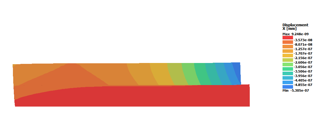

  • Case 5:
    In this load case the shifting force Fx is decreased to 0.29 N in order to not exceed the maximum friction force. Only partial slippage occurs in this case. There is a clear "sticking" contact area at the left end of the beams.
