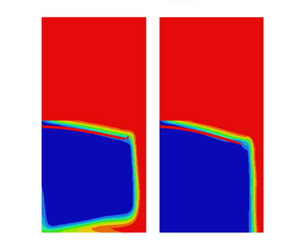

Model Description
In this model the top chamber is air, the lower chamber is water, and the bottom row of elements is the inlet. LAW51 is used for air, water and inlet. Boundary conditions are applied on each surface of fluid in its normal direction. An interface between fluid and rubber (CEL) is defined to manage the contact.
図 1.
  • UNITS: Length (mm), Time (ms), Mass (kg), Force (kN) and Stress (GPa)
  • Simulation time:
    Engine [0 – 50]
  • Fluid material (include water inlet and outlet) with /MAT/LAW51 (MULTIMAT)
