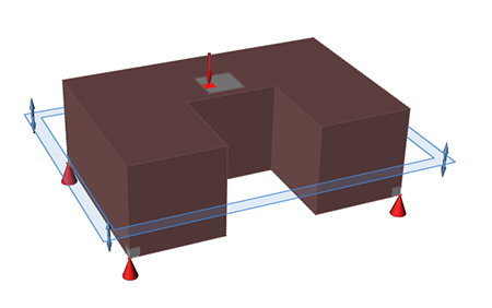

Figure 1. Design Space

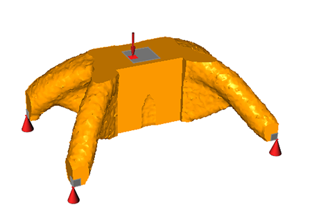

Figure 2. Optimized Shape with Split Draw Direction Applied

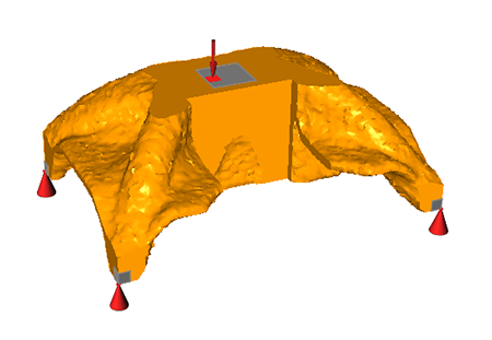

Figure 3. Optimized Shape with Split Draw Direction Applied and No Holes
