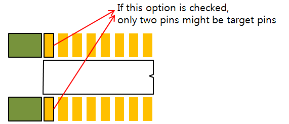

- Relative SD: Option to select target components pins after
considering soldering direction. If this option is not checked,
components’ all pins are checking target.
Figure 1. - Neighbor Dummy Pad: Pass if a neighbor pin of the target pin has a
dummy pad. Only applicable when a component is placed vertically
compared to the soldering direction.

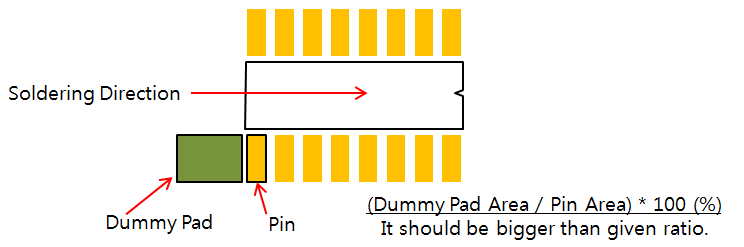

- Dummy Pad / Pin Area: Option to turn on/off “ad/Pin Area Ratio
Checking.
Figure 3. - Min Ratio (%): Set the minimum ratio of dummy pad against pin area. It means tool small dummy pads will be fails.
