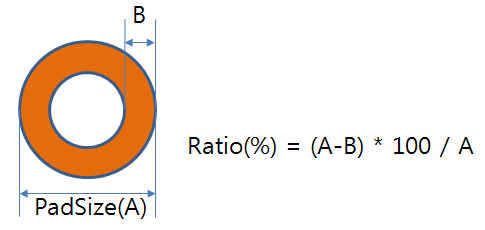

- Check Type: You can define checking type between Thickness and Ratio.
- Thickness: Use the target via annual rings minimum size in checking.
- Ratio: Use the target via minimum annular ring ratio in
checking.
- Value: Set the target thickness or ratio value of annual ring.
- Remainder: For vias, not defined in the table, you can check as
following option conditions.
- Minimum Annual Ring Thickness: Set the target via annual rings minimum size in checking.
- Minimum Size Ratio (Thickness x 100 / Pad): Set the target via minimum annular ring ratio in checking.
