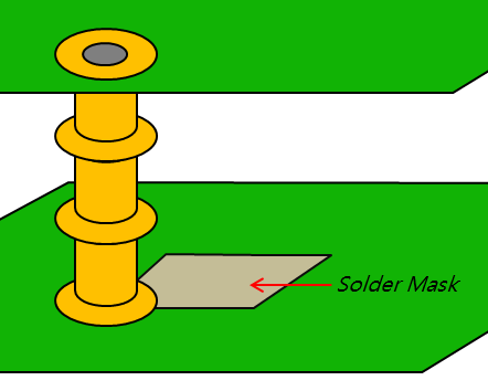

- Check Existence of Solder Mask in Via’s region at
reverse Side of Thermal Pad: Check if solder mask is
overlapped with via on reverse side of thermal pad
placed layer. If so, it is a fail.
Figure 1. - Check co-Existence of Solder Mask and Metal Mask in Thermal Pad: Check if solder mask and metal mask exist at the same time. If one of them is not in thermal pad, it is a fail.
