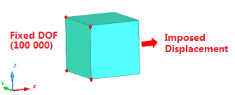

Uniaxial tensile one brick element with imposed displacement and fixed in other side only in X direction.
図 2. Problem description

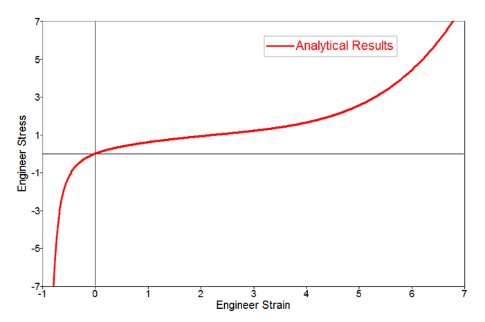

    The engineer stress is:(6) σ 1 _ e n g = σ 1 ( ε 1 _ e n g + 1 ) MathType@MTEF@5@5@+= feaagKart1ev2aqatCvAUfeBSjuyZL2yd9gzLbvyNv2CaerbuLwBLn hiov2DGi1BTfMBaeXatLxBI9gBaerbd9wDYLwzYbItLDharqqtubsr 4rNCHbGeaGqiVu0Je9sqqrpepC0xbbL8F4rqqrFfpeea0xe9Lq=Jc9 vqaqpepm0xbba9pwe9Q8fs0=yqaqpepae9pg0FirpepeKkFr0xfr=x fr=xb9adbaqaaeGaciGaaiaabeqaamaabaabaaGcbaGaeq4Wdm3aaS baaSqaaiaaigdacaGGFbGaamyzaiaad6gacaWGNbaabeaakiabg2da 9maalaaabaGaeq4Wdm3aaSbaaSqaaiaaigdaaeqaaaGcbaGaaiikai abew7aLnaaBaaaleaacaaIXaGaai4xaiaadwgacaWGUbGaam4zaaqa baGccqGHRaWkcaaIXaGaaiykaaaaaaa@495B@
    In this example, three material parameters are defined below: (7) C 10 =0 .18 C 20 =-2e-3 C 30 = 5 e − 5 MathType@MTEF@5@5@+= feaagKart1ev2aaatCvAUfeBSjuyZL2yd9gzLbvyNv2CaerbuLwBLn hiov2DGi1BTfMBaeXatLxBI9gBaerbd9wDYLwzYbItLDharqqtubsr 4rNCHbGeaGqiVu0Je9sqqrpepC0xbbL8F4rqqrFfpeea0xe9Lq=Jc9 vqaqpepm0xbba9pwe9Q8fs0=yqaqpepae9pg0FirpepeKkFr0xfr=x fr=xb9adbaqaaeGaciGaaiaabeqaamaabaabaaGceaqabeaacaWGdb WaaSbaaSqaaiaaigdacaaIWaaabeaakiaab2dacaqGWaGaaeOlaiaa bgdacaqG4aaabaGaam4qamaaBaaaleaacaaIYaGaaGimaaqabaGcca qG9aGaaeylaiaabkdacaqGLbGaaeylaiaabodaaeaacaWGdbWaaSba aSqaaiaaiodacaaIWaaabeaakiabg2da9iaaiwdacaWGLbGaeyOeI0 IaaGynaaaaaa@49BB@
    図 3. Engineer stress-strain curve

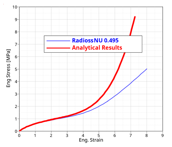

Compare the above results, then show the difference with analytical results especially in high deformed area.
図 4.

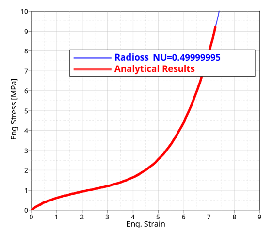

In order to match the incompressible hyperelastic analytical results, the Poisson’s ratio needs to be defined as close to 0.5 as possible, but can not be simply defined as ν =0 .5 MathType@MTEF@5@5@+= feaagKart1ev2aaatCvAUfeBSjuyZL2yd9gzLbvyNv2CaerbuLwBLn hiov2DGi1BTfMBaeXatLxBI9gBaerbd9wDYLwzYbItLDharqqtubsr 4rNCHbGeaGqiVu0Je9sqqrpepC0xbbL8F4rqqrFfpeea0xe9Lq=Jc9 vqaqpepm0xbba9pwe9Q8fs0=yqaqpepae9pg0FirpepeKkFr0xfr=x fr=xb9adbaqaaeGaciGaaiaabeqaamaabaabaaGcbaGaeqyVd4Maae ypaiaabcdacaqGUaGaaeynaaaa@3A8A@ , which will lead to infinite small time step in numerical computation. In this example ν = 0.49999995 MathType@MTEF@5@5@+= feaagKart1ev2aaatCvAUfeBSjuyZL2yd9gzLbvyNv2CaerbuLwBLn hiov2DGi1BTfMBaeXatLxBI9gBaerbd9wDYLwzYbItLDharqqtubsr 4rNCHbGeaGqiVu0Je9sqqrpepC0xbbL8F4rqqrFfpeea0xe9Lq=Jc9 vqaqpepm0xbba9pwe9Q8fs0=yqaqpepae9pg0FirpepeKkFr0xfr=x fr=xb9adbaqaaeGaciGaaiaabeqaamaabaabaaGcbaGaeqyVd4Maae ypaabaaaaaaaaapeGaaGimaiaac6cacaaI0aGaaGyoaiaaiMdacaaI 5aGaaGyoaiaaiMdacaaI5aGaaGynaaaa@4009@ is used. It shows Radioss results are well matched with analytical results.
図 5.

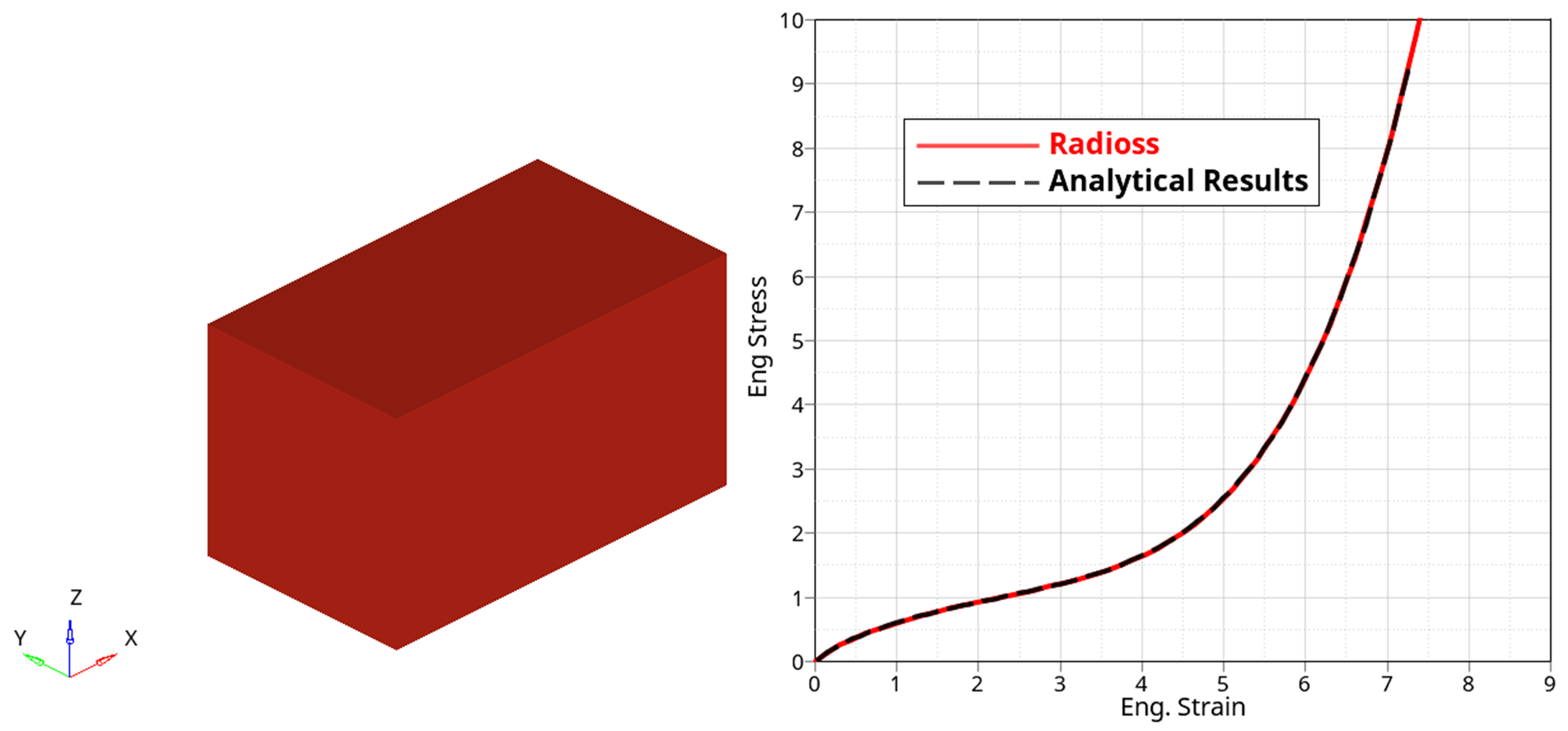

Since material incompressible is assumed in analytical calculation., Poisson’s ratio closer to 0.5 is better, but the computation time will increase. Just one element tension model from ν =0 .495 MathType@MTEF@5@5@+= feaagKart1ev2aaatCvAUfeBSjuyZL2yd9gzLbvyNv2CaerbuLwBLn hiov2DGi1BTfMBaeXatLxBI9gBaerbd9wDYLwzYbItLDharqqtubsr 4rNCHbGeaGqiVu0Je9sqqrpepC0xbbL8F4rqqrFfpeea0xe9Lq=Jc9 vqaqpepm0xbba9pwe9Q8fs0=yqaqpepae9pg0FirpepeKkFr0xfr=x fr=xb9adbaqaaeGaciGaaiaabeqaamaabaabaaGcbaGaeqyVd4Maae ypaiaabcdacaqGUaGaaeinaiaabMdacaqG1aaaaa@3BFD@ to ν = 0.49999995 MathType@MTEF@5@5@+= feaagKart1ev2aaatCvAUfeBSjuyZL2yd9gzLbvyNv2CaerbuLwBLn hiov2DGi1BTfMBaeXatLxBI9gBaerbd9wDYLwzYbItLDharqqtubsr 4rNCHbGeaGqiVu0Je9sqqrpepC0xbbL8F4rqqrFfpeea0xe9Lq=Jc9 vqaqpepm0xbba9pwe9Q8fs0=yqaqpepae9pg0FirpepeKkFr0xfr=x fr=xb9adbaqaaeGaciGaaiaabeqaamaabaabaaGcbaGaeqyVd4Maae ypaabaaaaaaaaapeGaaGimaiaac6cacaaI0aGaaGyoaiaaiMdacaaI 5aGaaGyoaiaaiMdacaaI5aGaaGynaaaa@4009@ run time is more than 20 times increased. In this example, use ν =0 .4997 MathType@MTEF@5@5@+= feaagKart1ev2aaatCvAUfeBSjuyZL2yd9gzLbvyNv2CaerbuLwBLn hiov2DGi1BTfMBaeXatLxBI9gBaerbd9wDYLwzYbItLDharqqtubsr 4rNCHbGeaGqiVu0Je9sqqrpepC0xbbL8F4rqqrFfpeea0xe9Lq=Jc9 vqaqpepm0xbba9pwe9Q8fs0=yqaqpepae9pg0FirpepeKkFr0xfr=x fr=xb9adbaqaaeGaciGaaiaabeqaamaabaabaaGcbaGaeqyVd4Maae ypaiaabcdacaqGUaGaaeinaiaabMdacaqG5aGaae4naaaa@3CBB@ ; therefore, set D1=0.003334.
