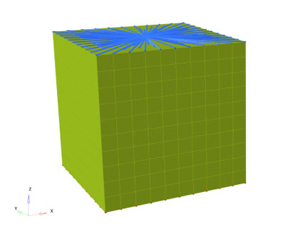

A cube (100mm*100mm*100mm) modeled with solid elements (/PROP/SOLID) and foam material (/MAT/LAW70) is compressed or extended in the vertical direction.
The nodes of the cube top surface are defined in a rigid body (/RBODY) with a vertical imposed displacement defined with a smooth function (/FUNCT_SMOOTH).
The nodes of the cube lower surface are also defined in a rigid body and its main node is clamped using a boundary condition (/BCS).
The secondary nodes of the rigid bodies are selected with a node set (/GRNOD) defined by box (/BOX).

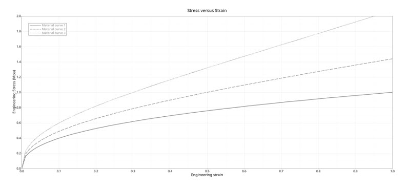

The material is defined with engineering stress versus engineering strain with several curves for the strain rate dependency.

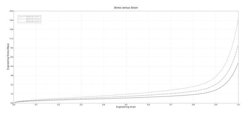

The tensile behavior is defined with the scaling factor versus engineering strain curve multiplied by the compression engineering stress versus engineering strain curve(s).
図 2. Compression engineering stress versus engineering strain curve
図 3. Compression curve multiply by the tensile scaling factor curve

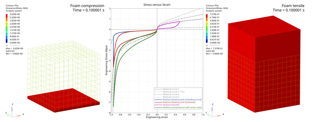

Results
図 4. Results
The engineering stress versus engineering stress computed from the rigid body force and nodal displacement give results which overlay exactly the input curve from the material.
The unloading behavior with model with the unloading curve (0220_foam_LAW70_0) is less realistic than the model with hysteresis behavior (0220_foam_LAW70_1).
