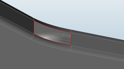

Use the Patch tool to fill in missing surfaces, or to remove and remake bad or problematic surfaces.
If the Patch tool finds a group of open edges that define a closed loop, clicking a red edge will close the hole.
![](../../../images/figures/inspire/patch_patch.png)
Figure 1. Patched Surface

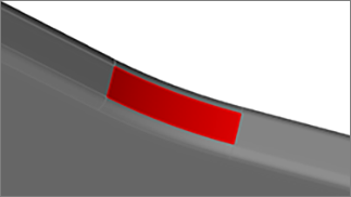

If you select two groups of edges or lines that do not define a closed area, the Patch tool will create a surface between the groups.
![](../../../images/figures/inspire/patch_bridge.png)

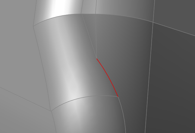

Define an Area to Patch
Select open edges individually to define an area to patch.
