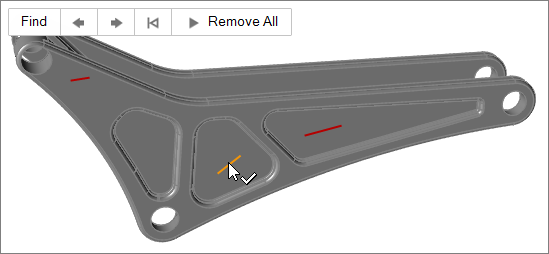

Remove Imprints
Find and remove imprints from a model. An imprint is an edge or a point that appears on a surface that can be removed without changing the underlying integrity of the surface, such as scratches or trimmed points.
- It is recommended that you remove imprints before applying other geometry simplification tools.
- To review each selected imprint located by the search, click
and
on the guide bar.
- Some geometry tools automatically detect relevant features when the tool is opened. You can disable this behavior in the Preferences under .

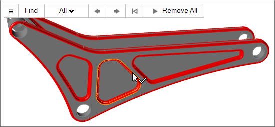

Remove Rounds and Fillets
Find and remove both round (convex) and fillet (concave) surfaces.
The Rounds tool allows you to select a round or fillet and find all that are larger, smaller, or similar (±5%) in size. It will also attempt to identify chains of rounds or fillets, although these chains may not be removed successfully all at once. In general, it is best to remove small fillets first, then larger fillets, then rounds. When you get to a point where you cannot remove any more, it is time to use other modeling tools and strategies to complete the geometry simplification.
- To review each selected round/fillet, click
and
on the guide bar.
- If there are several contiguous rounds or fillets, double-click one to select the entire chain. Selecting an adjacent round/fillet will add to the chain. When removing a round/fillet that is part of a chain, the entire chain will be removed.

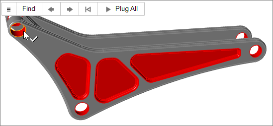

Plug Holes and Pockets
Find holes and pockets, and plug them by filling the area with a new part.
The Plug tool will attempt to identify chains of connected holes or pockets by searching upward, toward the outer face.
- To review each selected hole or pocket located by the search, click
and
on the guide bar. Clicking a selected hole/pocket plugs it, and the view automatically zooms in on the next selected hole or pocket.
- If there are several contiguous holes or pockets, selecting an adjacent hole or pocket will add it to the chain. When plugging a hole or pocket that is part of a chain, the entire chain will be plugged with a single part.
