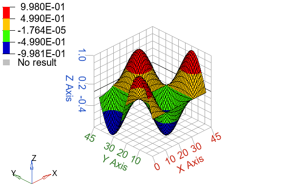

Figure 1. 3D contour plot

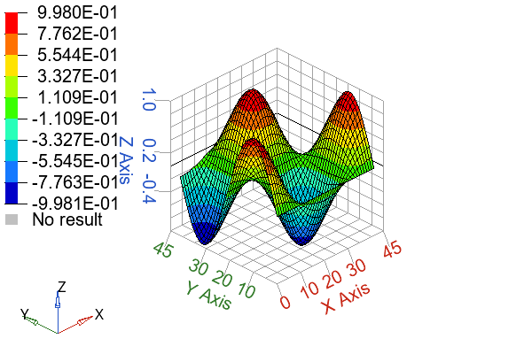

Figure 2. 3D contour plot with four color levels
