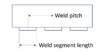

                Activate the Intermittent weld checkbox to specify
                    intermittent welds.
                Note: Two parameters, weld pitch and weld segment length, are required for intermittent welds. the pitch must be greater than the segment length.
