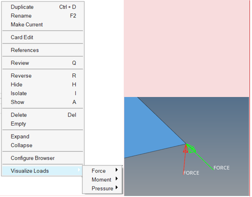

Load Visualization

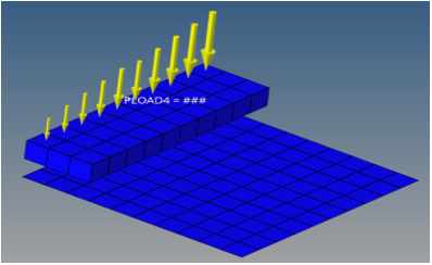

- Vector Plots – display value distribution with the direction of the load

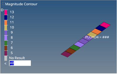

図 1. - Advanced Contour Plots – display value distribution with interactive filters

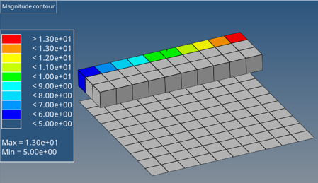

図 2. - Contour Plots – display value distribution with respect to the entire model
図 3.
図 4.
Load values can be plotted at specific time stamps for curve-based time dependent loads.
