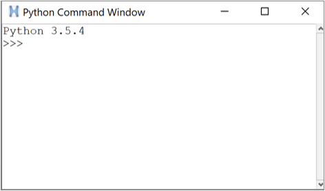

Launch the Python Console in MotionView
- Launch a new MotionView session and right-click in the Projectブラウザ.
- Click on the Python Window option.
図 1.The MV Python Console is launched.
図 2.

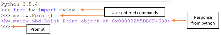

Python Console Conventions
図 3.
Importing mview Package
>>> from hw import mview
