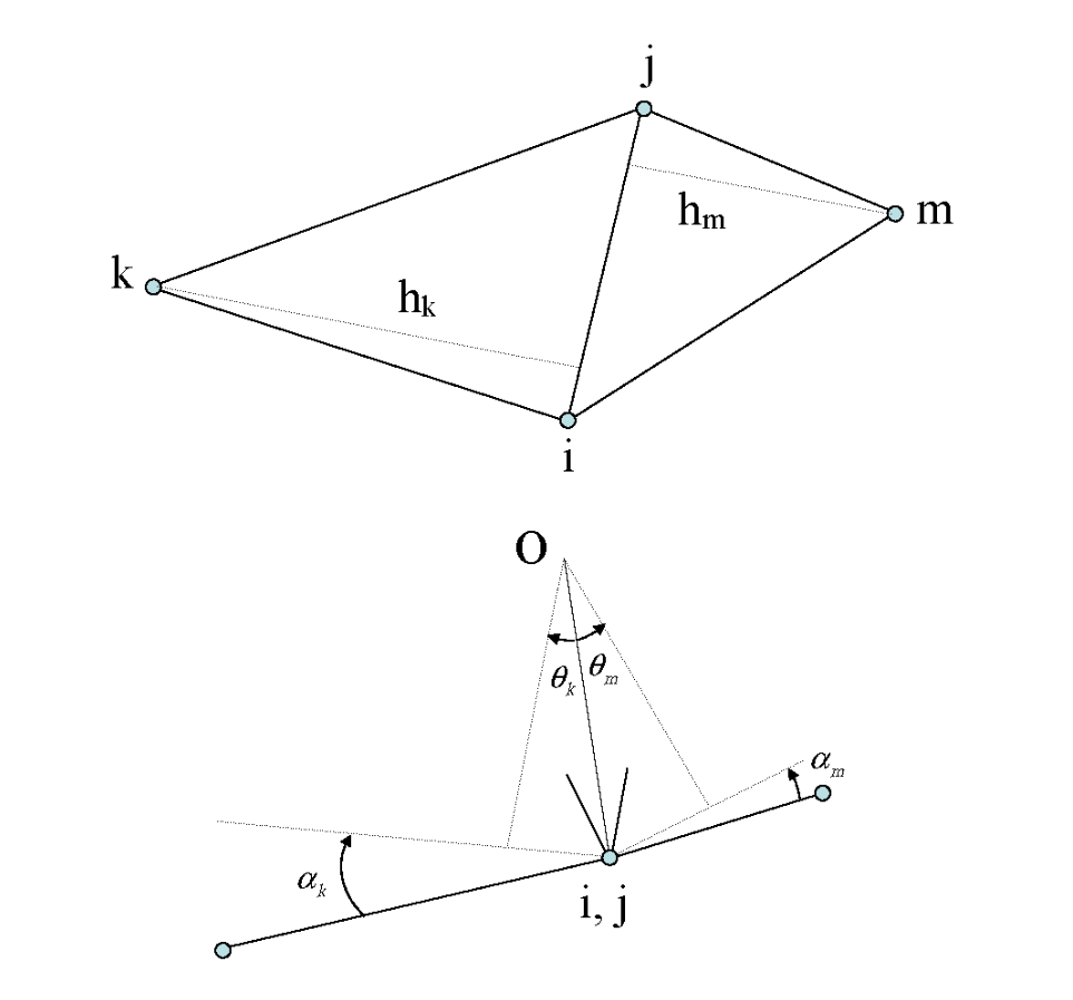

Consider two adjacent coplanar elements with a common edge i-j as shown in 図 2. Due to out-of-plane displacements of nodes m MathType@MTEF@5@5@+= feaagKart1ev2aaatCvAUfeBSjuyZL2yd9gzLbvyNv2CaerbuLwBLn hiov2DGi1BTfMBaeXatLxBI9gBaerbd9wDYLwzYbItLDharqqtubsr 4rNCHbGeaGqiVu0Je9sqqrpepC0xbbL8F4rqqrFfpeea0xe9Lq=Jc9 vqaqpepm0xbba9pwe9Q8fs0=yqaqpepae9pg0FirpepeKkFr0xfr=x fr=xb9adbaqaaeGaciGaaiaabeqaamaabaabaaGcbaGaamyBaaaa@36E8@ and k MathType@MTEF@5@5@+= feaagKart1ev2aaatCvAUfeBSjuyZL2yd9gzLbvyNv2CaerbuLwBLn hiov2DGi1BTfMBaeXatLxBI9gBaerbd9wDYLwzYbItLDharqqtubsr 4rNCHbGeaGqiVu0Je9sqqrpepC0xbbL8F4rqqrFfpeea0xe9Lq=Jc9 vqaqpepm0xbba9pwe9Q8fs0=yqaqpepae9pg0FirpepeKkFr0xfr=x fr=xb9adbaqaaeGaciGaaiaabeqaamaabaabaaGcbaGaamyBaaaa@36E8@ , the elements rotate around the side i-j. The angles between final and initial positions of the elements are respectively α m and α k for corresponding opposite nodes m MathType@MTEF@5@5@+= feaagKart1ev2aaatCvAUfeBSjuyZL2yd9gzLbvyNv2CaerbuLwBLn hiov2DGi1BTfMBaeXatLxBI9gBaerbd9wDYLwzYbItLDharqqtubsr 4rNCHbGeaGqiVu0Je9sqqrpepC0xbbL8F4rqqrFfpeea0xe9Lq=Jc9 vqaqpepm0xbba9pwe9Q8fs0=yqaqpepae9pg0FirpepeKkFr0xfr=x fr=xb9adbaqaaeGaciGaaiaabeqaamaabaabaaGcbaGaamyBaaaa@36E8@ and k MathType@MTEF@5@5@+= feaagKart1ev2aaatCvAUfeBSjuyZL2yd9gzLbvyNv2CaerbuLwBLn hiov2DGi1BTfMBaeXatLxBI9gBaerbd9wDYLwzYbItLDharqqtubsr 4rNCHbGeaGqiVu0Je9sqqrpepC0xbbL8F4rqqrFfpeea0xe9Lq=Jc9 vqaqpepm0xbba9pwe9Q8fs0=yqaqpepae9pg0FirpepeKkFr0xfr=x fr=xb9adbaqaaeGaciGaaiaabeqaamaabaabaaGcbaGaamyBaaaa@36E8@ . Assuming, a constant curvature for both of elements, the rotation angles θ m and θ k related to the bending of each element around the common side are obtained by:(1)
θ k = h k 2 R and θ m = h m 2 R
However, for total rotation you have:(2)
θ k + θ m = α k + α m
which leads to:(3)
θ k = ( α k + α m ) h k ( h k + h m ) and θ m = ( α k + α m ) h m ( h k + h m )
図 1. Computation of Rotational DOF in SH3N6

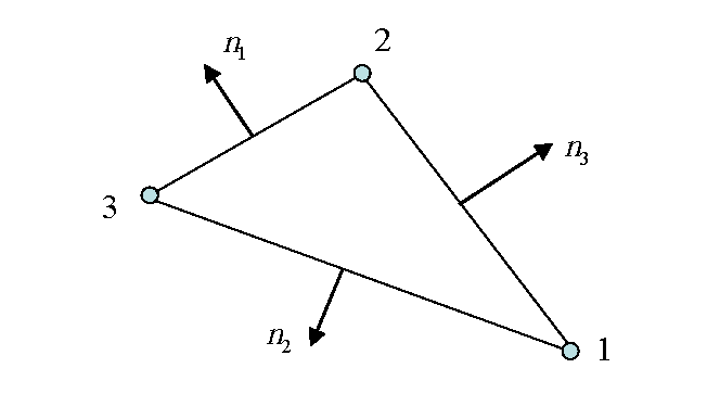

Consider the triangle element in 図 2. The outward normal vectors at the three sides are defined and denoted n 1 MathType@MTEF@5@5@+= feaagKart1ev2aaatCvAUfeBSjuyZL2yd9gzLbvyNv2CaerbwvMCKf MBHbqefqvATv2CG4uz3bIuV1wyUbqedmvETj2BSbqefm0B1jxALjhi ov2DaebbnrfifHhDYfgasaacH8srps0lbbf9q8WrFfeuY=Hhbbf9v8 qqaqFr0xc9pk0xbba9q8WqFfea0=yr0RYxir=Jbba9q8aq0=yq=He9 q8qqQ8frFve9Fve9Ff0dmeaacaGacmGadaWaaiqacaabaiaafaaake GabaaVqiaad6gacaaIXaaaaa@3B54@ , n 2 MathType@MTEF@5@5@+= feaagKart1ev2aaatCvAUfeBSjuyZL2yd9gzLbvyNv2CaerbwvMCKf MBHbqefqvATv2CG4uz3bIuV1wyUbqedmvETj2BSbqefm0B1jxALjhi ov2DaebbnrfifHhDYfgasaacH8srps0lbbf9q8WrFfeuY=Hhbbf9v8 qqaqFr0xc9pk0xbba9q8WqFfea0=yr0RYxir=Jbba9q8aq0=yq=He9 q8qqQ8frFve9Fve9Ff0dmeaacaGacmGadaWaaiqacaabaiaafaaake GabaaVqiaad6gacaaIXaaaaa@3B54@ and n 3 MathType@MTEF@5@5@+= feaagKart1ev2aaatCvAUfeBSjuyZL2yd9gzLbvyNv2CaerbwvMCKf MBHbqefqvATv2CG4uz3bIuV1wyUbqedmvETj2BSbqefm0B1jxALjhi ov2DaebbnrfifHhDYfgasaacH8srps0lbbf9q8WrFfeuY=Hhbbf9v8 qqaqFr0xc9pk0xbba9q8WqFfea0=yr0RYxir=Jbba9q8aq0=yq=He9 q8qqQ8frFve9Fve9Ff0dmeaacaGacmGadaWaaiqacaabaiaafaaake GabaaVqiaad6gacaaIXaaaaa@3B54@ . The normal component strain due to the bending around the element side is obtained using plate assumption:(4)
{ ε n 1 ε n 2 γ n 3 } = [ 2 ( h 1 + h 5 ) 0 0 0 2 ( h 1 + h 5 ) 0 0 2 ( h 2 + h 6 ) 0 0 0 2 ( h 2 + h 6 ) 0 0 2 ( h 3 + h 4 ) 2 ( h 3 + h 4 ) 0 0 ] { α 1 α 2 α 3 α 4 α 5 α 6 }

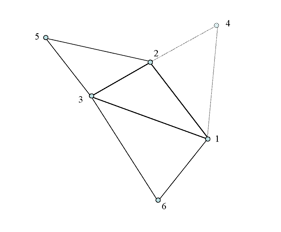

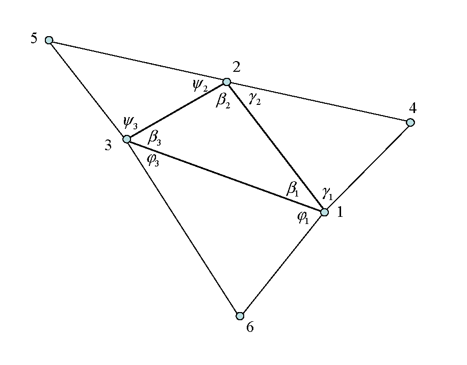

The six mid-side rotations α i are related to the out-of-plane displacements of the six apex nodes as shown in 図 3 by the following relation:(5)
{ α 1 α 2 α 3 α 4 α 5 α 6 } = [ 1 h 1 cos β 3 h 2 cos β 2 h 3 0 0 0 cos β 3 h 1 1 h 2 cos β 1 h 3 0 0 0 cos β 2 h 1 cos β 1 h 2 1 h 3 0 0 0 cos γ 2 q 1 cos γ 1 q 2 0 1 h 4 0 0 0 cos ψ 3 r 2 cos ψ 2 r 3 0 1 h 5 0 cos φ 2 s 1 0 cos φ 1 s 3 0 0 1 h 6 ] { w 1 w 2 w 3 w 4 w 5 w 6 }
Where, ( h 1 h 2 h 3 ) , ( q 1 h 4 q 2 ) , ( r 2 h 5 r 3 ) and ( s 3 h 6 s 1 ) are respectively the heights of the triangles (1,2,3), (1,4,2), (2,5,3) and (3,6,1).
図 2. Normal Vectors Definition
The non-null components of strain tensor in the local element reference are related to the normal components of strain by the following relation: 1 3(6)
{ ε x x ε y y γ x y } = [ ( y 3 y 2 l 1 ) 2 ( y 1 y 3 l 2 ) 2 ( y 2 y 1 l 3 ) 2 ( x 2 x 3 l 1 ) 2 ( x 3 x 1 l 2 ) 2 ( x 1 x 2 l 3 ) 2 2 ( y 3 y 2 l 1 ) ( x 2 x 3 l 1 ) 2 ( y 1 y 3 l 2 ) ( x 3 x 1 l 2 ) 2 ( y 2 y 1 l 3 ) ( x 1 x 2 l 3 ) ] { ε n 1 ε n 2 γ n 3 }
図 3. Neighbor Elements for a Triangle
