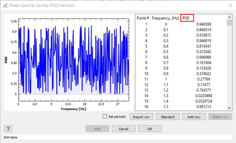

(1) Where, is the frequency response function.Let us take an example of base excitation as an input to a random response analysis.
The base excitation with amplitude is used to define the input for frequency response analysis, so the units of the acceleration excitation type would be any of the below highlighted units- m/sec2
 - mm/sec2
 - cm/sec2
 - G
 - in/sec2
Units for PSD function depend on the boundary condition. In this example, as base excitation is given as acceleration, the unit for PSD is (mm/s2)2/Hz.
Figure 1.Note: Only immovable and general constraints can be used as the source location. Hinges, springs and sliders are not supported at this time.
