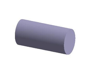

Cylindrical

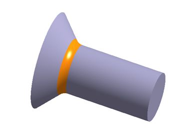

Conical

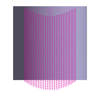

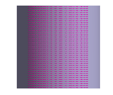

You can apply loads on multiple faces of the same part. You can
apply bearing loads as forces in radial and axial directions, and as torque to the
selected faces.
Radial Force
Axial Force
Torque

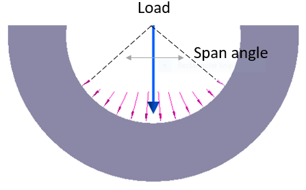

The faces may be concave (as shown in Figure 1) or convex (as shown in
Figure 2). Figure 1. Figure 2.

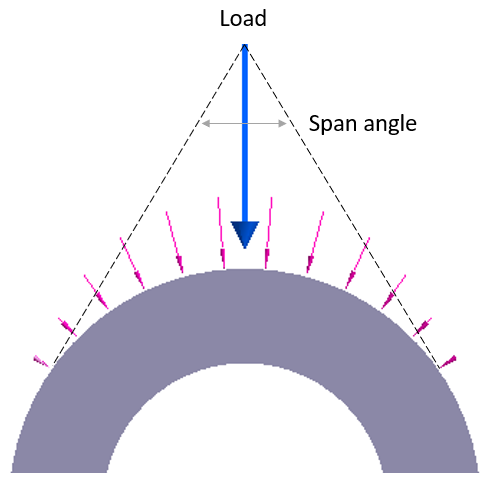

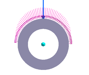

Under Load, specify the numerical value and the units for radial, axial, and
torque loads.
Use the Radial Direction and Span fields to adjust load
direction.
Note: You can also adjust the load direction using the Degree field or by
entering a reference XYZ vector direction.
Specify the Load span angle.
Note: Valid load span angles are 10 to 180 degrees.
Click Apply.
The load is applied as a pressure, whose magnitude is spread using a
sinusoidal distribution over the Load span angle. In Non-linear
Structural analysis, bearing pressure is assumed to be a follower load
as it follows the Part geometry change when large deformations occur.
Pressure always remains normal to the deformed face of a Part.
