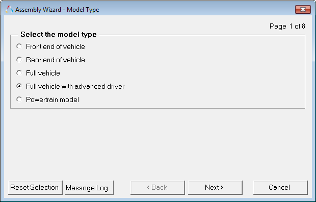

From the menu bar, select Model > Assembly Wizard.
In Script an Open Loop Acceleration Event, a linear torque map powertrain will be used to avoid the complexity of adding controllers for gear and clutch.Figure 4.
Select the Full vehicle with advanced driver
option.
This takes care of all the dependencies of the advanced driver.Figure 5.
