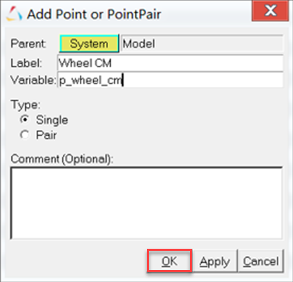

Add a Point to the Model
In this step, you will add a point to the model.

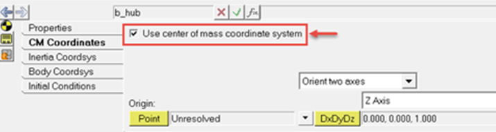

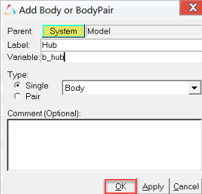

Add a Hub Body to the Model
In this step, you will add a body to the model and define the center of the Hub body.
Update the Mass and Inertia Properties of the Hub Body
In this step, you will update the mass and inertia properties of the Hub body.

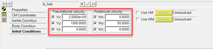

Set the Initial Conditions for the Hub Body
In this step, you will set the initial conditions for the Hub body.

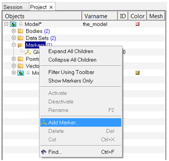

Add a Marker to the Model
In this step, you will add a marker to the model.

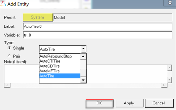

Add an AutoTire Entity to the Model
In this step, you will add and autotire entity to the model.
