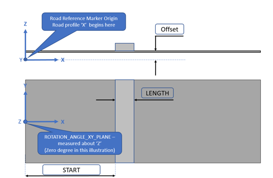

The TNO Plank Road is represented by flat road with a single cleat (cuboid obstacle) that can be oriented in perpendicular or oblique direction related to the X-axis of the Road Reference Marker.
Figure 2. Plank Road Oriented by the Road Reference Marker
The Offset is the distance of the ground with respect to the Z-axis of the Road Reference Marker. Length measures the width of the plank along X-axis. Rotation angle XY plane is the positive X-axis of the road with respect to the inertial frame. START parameter indicates the distance along the X-axis of the road from the origin to the start of the plank.

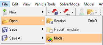

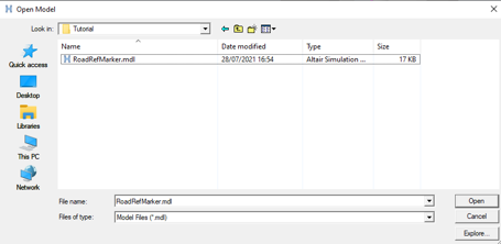

  1. From the Start menu, select Altair 2023 > MotionView.
  2. Click File > Open > Model and load the RoadRefMarker.mdl file.
    Figure 3.
    Figure 4.

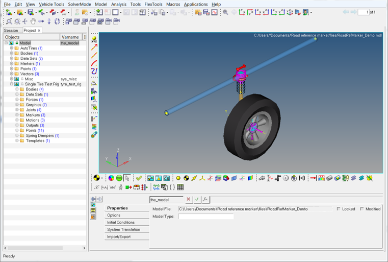

  3. Click Open
    The model is displayed in MotionView.
    Figure 5.

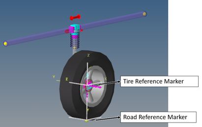

    Note that the Road Reference marker is located at the contact patch of the tire.

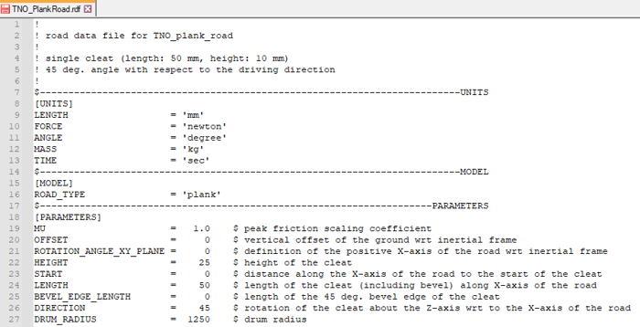

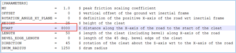

  4. The Auto Tire sub-system has the TNO_PlankRoad.rdf file as the Road property file.
    Figure 7.
  5. The image below shows the parameters available in the road property file.
    Figure 8.
    Parameters Description
    HEIGHT Height of the cleat.
    START Distance along the X-axis of the road from the origin to the start of the cleat (in other words, travelling from the origin the tire will hit the cleat at START).
    LENGTH Length of the cleat (including bevel) along the X-axis of the road.
    BEVEL_EDGE_LENGTH Length of the 45 deg. Bevel edge of the cleat.
    DIRECTION Rotation of the cleat about the Z-axis with respect to the Y-axis of the road. If the cleat is placed crosswise, DIRECTION = 0. If the cleat is along the X-axis, DIRECTION = 90.
    Note: Refer to TNO MF-SWIFT/MF-Tyre Documentation for additional information.
Change the START Parameter in the Road File and Verify the Results
In this step, the road start point will be shifted 4000mm along X in the property file, however in MotionView the Road Reference Marker remains at the same position.

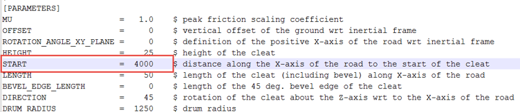

  1. Change the START parameter to 4000 in the TNO_PlankRoad.rdf file.

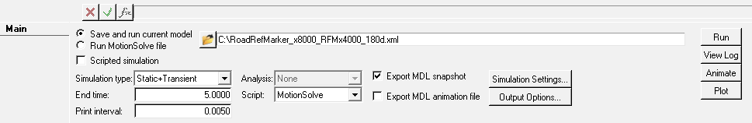

  2. On the Model-Main toolbar, click the Run icon to open the Run Solver panel.
  3. Browse and locate the required file path to save and run the current model.
    Figure 10.

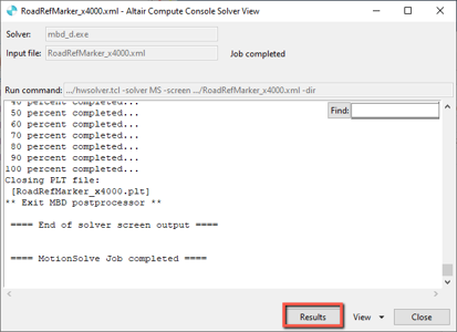

  4. Click the Run button (located on the far right side of the panel).
    MotionSolve is invoked in the background and runs the simulation.
  5. After the MotionSolve run is complete, click on Results.

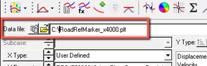

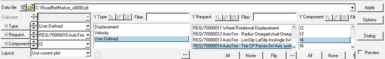

  7. Use the Data file browser to locate the .plt file saved in the MotionSolve simulation.
    Figure 13.

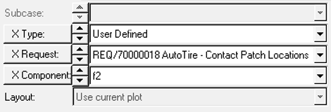

  8. Define the X-axis by selecting the following options as shown below.
    Figure 14.
    X Type User Defined
    X Request REQ/70000018 AutoTire- Contact Patch Locations
    X Component f2
  9. Define the Y-axis by selecting the following options.
    Figure 15.
    Y Type User Defined
    Y Request REQ/70000014 AutoTire- Tire CP Forces (W-Axis system)
    Y Component f4

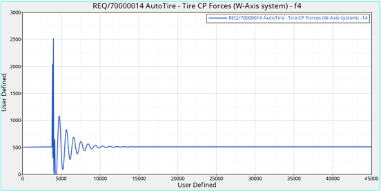

  10. Click the Apply button to obtain the following plots.
    Figure 16.
    The plot displays the Tire force (Y-axis) vs Contact patch location. The curve indicates the oscillation starting at 4000mm along the X-axis, meaning the tire reaches the obstacle at 4000mm.
Change the START Parameter to 8000 in the Road File and Verify the Results
In this step, the road start point will be shifted 8000mm along X in the property file keeping the Road Reference Marker at the same position.
  1. Change the START parameter to 8000 in the TNO_PlankRoad.rdf file.

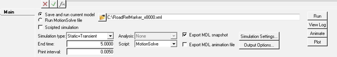

  2. On the Model-Main toolbar in MotionView, click the (Run) icon to open the Run Solver panel.
    Figure 18.

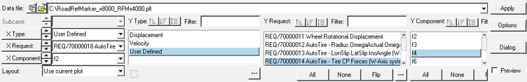

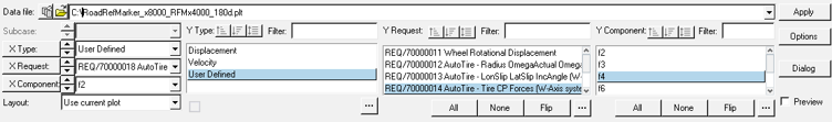

  4. In the same HyperGraph session, browse and locate the new .plt file in the Data file field.
    Figure 19.
  5. Repeat the X and Y-axis selections.
    Figure 20.
    X Type User Defined
    X Component f2
    Y Type User Defined
    Y Component f4

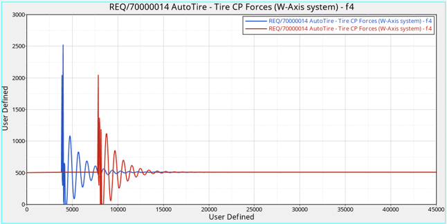

  6. Click the Apply button to visualize the two plots overlayed.
    Figure 21.
    The plot shows the modifications on Start parameter in the Road Property File. The blue curve indicates the obstacle at 4000mm along the X-axis, while the red curve shows the obstacle at 8000mm.

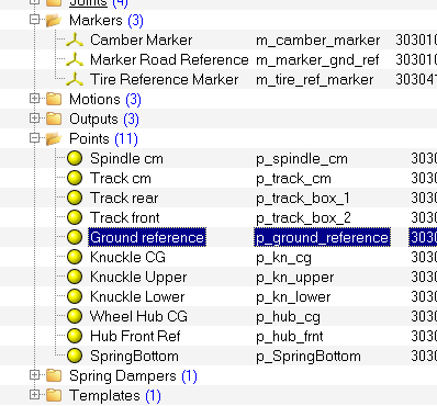

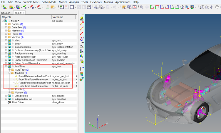

  1. In the MotionView model, click on the Marker Road Reference in the browser.
    Figure 22.
  2. The Road Reference Marker's origin uses the Ground reference point.
    Figure 23.
  3. Click on the Ground reference point from the Project Browser.
    Figure 24.
  4. In the panel area, change the X coordinate value to 4000.
    Figure 25.

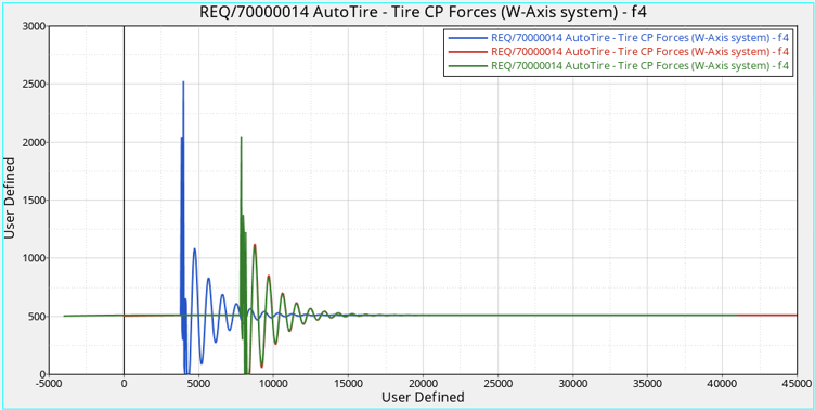

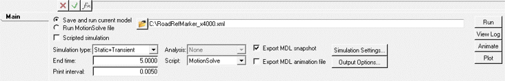

  5. On the General Actions toolbar, click the (Run) icon to open the Run Solver panel.
  6. Click the Run button and run the simulation indicating a different name for the results file.
    Figure 26.
  7. In the HyperGraph session, browse and locate the respective plot file from the <working directory> in the Data file field.
    Figure 27.
  8. Repeate the X and Y-axis selections.
    Figure 28.
    X Type User Defined
    X Component f2
    Figure 29.
    Y Type User Defined
    Y Component f4

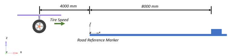

  9. Click the Apply button to visualize the three plots overlayed.
    Figure 30.
    The green curve shows the results of modifying the Road Reference Marker 4000mm keeping the start at 8000mm. You may notice that plot indicates the obstacles at 8000mm as in Step 3, but the starting point is not 0mm as before but -4000mm in X. The explanation for this is shown in the image below. The Road Reference Marker works as the reference for the road, since the marker was moved, the contact patch is now behind the reference, hence starting at a negative value.
    Figure 31.

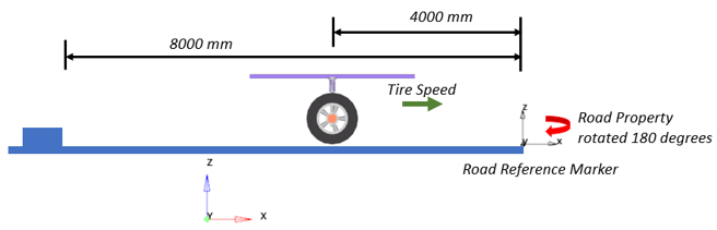

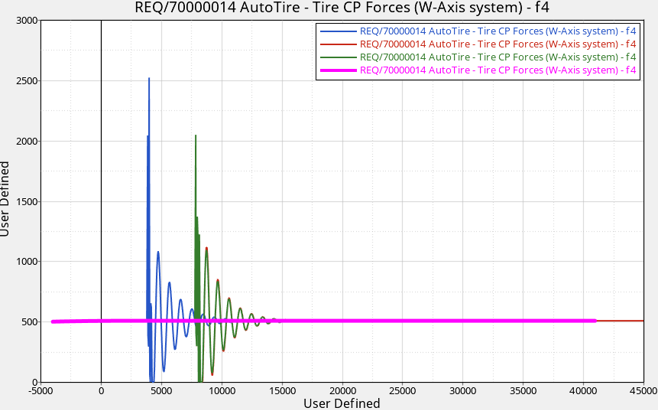

Change the Rotation Angle XY Plane to 180 and Verify the Results
In this step, the Road Property File will be rotated 180 degrees using Rotation Angle. Keep the Road Property File Start parameter at 8000 mm and the Road Reference Marker positioned at 4000 mm along X.

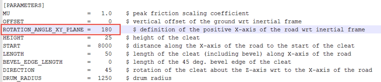

  1. Change the ROTATION_ANGLE_XY_PLANE parameter to 180 in the TNO_PlankRoad.rdf file.
    Figure 32.
  2. Click the Run button and run the simulation indicating a different name for the results.
    Figure 33.
  3. In the HyperGraph session, browse and locate the respective plot file from the <working directory> in the Data file field.
    Figure 34.
  4. Repeat the X and Y-axis selections.
    Figure 35.
    X Type User Defined
    X Component f2
    Y Type User Defined
    Y Component f4
  5. Click the Apply button to visualize the four plot overlayed.
    Figure 36.
    The pink curve shows the results of rotating the Road Property File 180 degrees. It can be observed that there are no oscillations and the tire does not reach the obstacle. The explanation for this is shown in the image below. When rotating the road, the cleat moves behind the tire and opposite to the tire direction.
    Figure 37.
