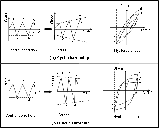

Cyclic Stress-Strain Curve
Material exhibits different behavior under cyclic load compared with that of
monotonic load. Generally, there are four kinds of response:
Stable state
Cyclic hardening
Cyclic softening
Softening or hardening depending on strain range
Which response will occur depends on its nature and initial condition of heat
treatment. The figure below illustrates the effect of cyclic hardening and cyclic
softening where the first two hysteresis loops of two different materials are
plotted. In both cases, the strain is constrained to change in fixed range, while
the stress is allowed to change arbitrarily. If the stress amplitude increases
relative to the former cycle under fixed strain range, as shown in Material cyclic
response (a), it is called cyclic hardening; otherwise, it is called
cyclic softening (b). Figure 1. Material cyclic response (a) Cyclic hardening; (b) Cyclic
softening
Cyclic response of material can also be described by specifying the stress
amplitude and leaving strain unconstrained. If the strain amplitude increases
relative to the former cycle under fixed stress range, it is called cyclic
softening; otherwise, it is called cyclic hardening. In fact, the cyclic behavior of
material will reach a steady state after a short time which generally occupies less
than 10 percent of the material total life. Through specifying different strain

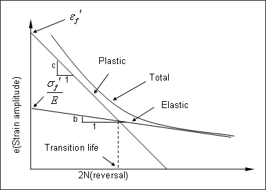

Almost a century ago, Basquin observed the linear relationship between stress and
fatigue life in log scale when the stress is limited. He put forward the following
fatigue formula controlled by stress:
(10)
Where, is stress amplitude, fatigue strength coefficient, b fatigue strength
exponent. Later in the 1950s, Coffin and Manson independently proposed that plastic
strain may also be related with fatigue life by a simple power law:
(11)
Where, is plastic strain amplitude,
fatigue ductility coefficient,
fatigue ductility exponent. Morrow
combined the work of Basquin, Coffin and Manson to consider both elastic strain and
plastic strain contribution to the fatigue life. He found out that the total strain
has more direct correlation with fatigue life. By applying Hooke Law, Basquin rule
can be rewritten as:
(12)
Where, is elastic strain amplitude.
Total strain amplitude, which is the sum of the elastic strain and plastic stain,
therefore, can be described by applying Basquin formula and Coffin-Manson
formula:
(13)
Where, is the total strain amplitude,
the other variable is the same with above.
