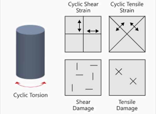

Critical Plane Approach
Experiments show that cracks nucleate and grow on specific planes known as critical
planes. The Critical Plane Approach captures the physical nature of damage in its
damage assessment process.
Depending on the material and stress states, the critical planes can be either
maximum shear planes or maximum tensile stress planes. Therefore, to assess damage
from multiaxial loads, two separate damage models are required. One is for crack
growth due to shear, and the other is for crack growth due to tension. Figure 1. Cracks driven by Shear and Tensile Stress Figure 2. Cyclic, Torsion, Shear Strain, Tensile Strain, Shear and Tensile
damage

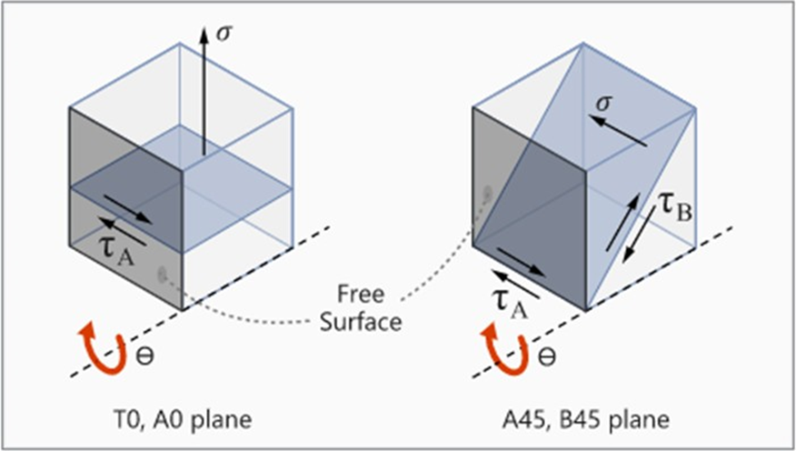

You can use any damage model the critical plane approach. The damage models require a
search for the most damaging plane. There are two possible damaging (or failure)
modes. One is tensile crack growth, which occurs on planes that are perpendicular to
the free surface. The angle θ is the angle that a crack is observed on the surface
relative to the σx direction. The second failure system is shear crack growth, which
occurs on planes oriented 45 degrees to the surface. Both in-plane and out-of-plane
shear stresses are considered on this plane. θ can take on any value on the surface.
The shear stress τA is an in-plane shear stress and causes microcracks to grow along
the surface. The maximum out-of-plane shear, τB occurs on a plane that is oriented
at 45 degrees from the free surface and causes microcracks to grow into the
surface. Figure 3. In-Plane Shear Stress and Normal Stress at 90 Degree Plane; In-Plane and
Out-of-Plane Shear Stress at a 45 Degree Plane
