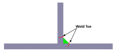

Predicted or likely failure (fatigue crack) locations at the weld toe are marked. These are the locations where the fatigue damage will be evaluated.
Figure 1. Fillet weld cross-section showing likely failure locations

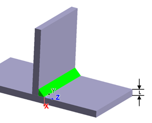

The seam weld fatigue damage calculation in SimSolid uses a structural stress at the location of interest using the stress linearization method (link to SimSolid linearized stress documentation) and the bending ratio associated with that stress. Linearized stresses are obtained in a local coordinate system along the stress linearization segment. The local coordinate system is based on the start and end points of the segment as shown in Figure 2. The X-axis of the system is along the segment from entry to exit points. The other two axes are calculated as follows:
  • If the local X-axis is not parallel to the global Y-axis:(1)

From the extracted stress values above, the average membrane stress tensor plus the ending bending stress tensors at the entry and exit points are calculated using numerical integration.(3)
σ i m = 1 T ∫ − T / 2 T / 2 σ i d x MathType@MTEF@5@5@+= feaahqart1ev3aaatCvAUfeBSjuyZL2yd9gzLbvyNv2CaerbuLwBLn hiov2DGi1BTfMBaeXatLxBI9gBaerbd9wDYLwzYbItLDharqqtubsr 4rNCHbGeaGqiVu0Je9sqqrpepC0xbbL8F4rqqrFfpeea0xe9Lq=Jc9 vqaqpepm0xbba9pwe9Q8fs0=yqaqpepae9pg0FirpepeKkFr0xfr=x fr=xb9adbaqaaeGaciGaaiaabeqaamaabaabaaGcbaGaeq4Wdm3aa0 baaSqaaiaadMgaaeaacaWGTbaaaOGaeyypa0ZaaSaaaeaacaaIXaaa baGaamivaaaadaWdbaqaamaaDaaaleaacqGHsislcaWGubGaai4lai aaikdaaeaacaWGubGaai4laiaaikdaaaGccqaHdpWCdaWgaaWcbaGa amyAaaqabaGccaWGKbGaamiEaaWcbeqab0Gaey4kIipaaaa@48F3@
(4)
σ i S b = − 6 T 2 ∫ − T / 2 T / 2 σ i x d x MathType@MTEF@5@5@+= feaahqart1ev3aaatCvAUfeBSjuyZL2yd9gzLbvyNv2CaerbuLwBLn hiov2DGi1BTfMBaeXatLxBI9gBaerbd9wDYLwzYbItLDharqqtubsr 4rNCHbGeaGqiVu0Je9sqqrpepC0xbbL8F4rqqrFfpeea0xe9Lq=Jc9 vqaqpepm0xbba9pwe9Q8fs0=yqaqpepae9pg0FirpepeKkFr0xfr=x fr=xb9adbaqaaeGaciGaaiaabeqaamaabaabaaGcbaGaeq4Wdm3aa0 baaSqaaiaadMgacaWGtbaabaGaamOyaaaakiabg2da9iabgkHiTmaa laaabaGaaGOnaaqaaiaadsfadaahaaWcbeqaaiaaikdaaaaaaOWaa8 qaaeaadaqhaaWcbaGaeyOeI0Iaamivaiaac+cacaaIYaaabaGaamiv aiaac+cacaaIYaaaaOGaeq4Wdm3aaSbaaSqaaiaadMgaaeqaaOGaam iEaiaadsgacaWG4baaleqabeqdcqGHRiI8aaaa@4CA2@
(5)
σ i E b = − σ i S b MathType@MTEF@5@5@+= feaahqart1ev3aaatCvAUfeBSjuyZL2yd9gzLbvyNv2CaerbuLwBLn hiov2DGi1BTfMBaeXatLxBI9gBaerbd9wDYLwzYbItLDharqqtubsr 4rNCHbGeaGqiVu0Je9sqqrpepC0xbbL8F4rqqrFfpeea0xe9Lq=Jc9 vqaqpepm0xbba9pwe9Q8fs0=yqaqpepae9pg0FirpepeKkFr0xfr=x fr=xb9adbaqaaeGaciGaaiaabeqaamaabaabaaGcbaGaeq4Wdm3aa0 baaSqaaiaadMgacaWGfbaabaGaamOyaaaakiabg2da9iabgkHiTiab eo8aZnaaDaaaleaacaWGPbGaam4uaaqaaiaadkgaaaaaaa@411C@

  • L MathType@MTEF@5@5@+= feaahqart1ev3aaatCvAUfeBSjuyZL2yd9gzLbvyNv2CaerbuLwBLn hiov2DGi1BTfMBaeXatLxBI9gBaerbd9wDYLwzYbItLDharqqtubsr 4rNCHbGeaGqiVu0Je9sqqrpepC0xbbL8F4rqqrFfpeea0xe9Lq=Jc9 vqaqpepm0xbba9pwe9Q8fs0=yqaqpepae9pg0FirpepeKkFr0xfr=x fr=xb9adbaqaaeGaciGaaiaabeqaamaabaabaaGcbaGaamitaaaa@36C4@ is equal to the i t h MathType@MTEF@5@5@+= feaahqart1ev3aaatCvAUfeBSjuyZL2yd9gzLbvyNv2CaerbuLwBLn hiov2DGi1BTfMBaeXatLxBI9gBaerbd9wDYLwzYbItLDharqqtubsr 4rNCHbGeaGqiVu0Je9sqqrpepC0xbbL8F4rqqrFfpeea0xe9Lq=Jc9 vqaqpepm0xbba9pwe9Q8fs0=yqaqpepae9pg0FirpepeKkFr0xfr=x fr=xb9adbaqaaeGaciGaaiaabeqaamaabaabaaGcbaGaamyAamaaCa aaleqabaGaamiDaiaadIgaaaaaaa@38F4@ Length of the stress linearization segment.
  • x MathType@MTEF@5@5@+= feaahqart1ev3aaatCvAUfeBSjuyZL2yd9gzLbvyNv2CaerbuLwBLn hiov2DGi1BTfMBaeXatLxBI9gBaerbd9wDYLwzYbItLDharqqtubsr 4rNCHbGeaGqiVu0Je9sqqrpepC0xbbL8F4rqqrFfpeea0xe9Lq=Jc9 vqaqpepm0xbba9pwe9Q8fs0=yqaqpepae9pg0FirpepeKkFr0xfr=x fr=xb9adbaqaaeGaciGaaiaabeqaamaabaabaaGcbaGaamiEaaaa@36F0@ is equal to the position of a point along the segment.

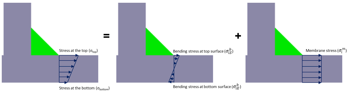

Figure 3.
Hence, the stress at the top and the bottom surface is derived from the below equations:(6)
σ t o p = σ i m + σ i S b MathType@MTEF@5@5@+= feaahqart1ev3aaatCvAUfeBSjuyZL2yd9gzLbvyNv2CaerbuLwBLn hiov2DGi1BTfMBaeXatLxBI9gBaerbd9wDYLwzYbItLDharqqtubsr 4rNCHbGeaGqiVu0Je9sqqrpepC0xbbL8F4rqqrFfpeea0xe9Lq=Jc9 vqaqpepm0xbba9pwe9Q8fs0=yqaqpepae9pg0FirpepeKkFr0xfr=x fr=xb9adbaqaaeGaciGaaiaabeqaamaabaabaaGcbaGaeq4Wdm3aaS baaSqaaiaadshacaWGVbGaamiCaaqabaGccqGH9aqpcqaHdpWCdaqh aaWcbaGaamyAaaqaaiaad2gaaaGccqGHRaWkcqaHdpWCdaqhaaWcba GaamyAaiaadofaaeaacaWGIbaaaaaa@452D@
(7)
σ bottom = σ i m − σ iS b (since  σ iE b =− σ iS b ) MathType@MTEF@5@5@+= feaahqart1ev3aaatCvAUfeBSjuyZL2yd9gzLbvyNv2CaerbuLwBLn hiov2DGi1BTfMBaeXatLxBI9gBaerbd9wDYLwzYbItLDharqqtubsr 4rNCHbGeaGqiVu0Je9sqqrpepC0xbbL8F4rqqrFfpeea0xe9Lq=Jc9 vqaqpepm0xbba9pwe9Q8fs0=yqaqpepae9pg0FirpepeKkFr0xfr=x fr=xb9adbaqaaeGaciGaaiaabeqaamaabaabaaGcbaGaeq4Wdm3aaS baaSqaaiaadkgacaWGVbGaamiDaiaadshacaWGVbGaamyBaaqabaGc cqGH9aqpcqaHdpWCdaqhaaWcbaGaamyAaaqaaiaad2gaaaGccqGHsi slcqaHdpWCdaqhaaWcbaGaamyAaiaadofaaeaacaWGIbaaaOGaaiik aiaabohacaqGPbGaaeOBaiaabogacaqGLbGaaeiiaiabeo8aZnaaDa aaleaacaWGPbGaamyraaqaaiaadkgaaaGccqGH9aqpcqGHsislcqaH dpWCdaqhaaWcbaGaamyAaiaadofaaeaacaWGIbaaaOGaaiykaaaa@59E3@

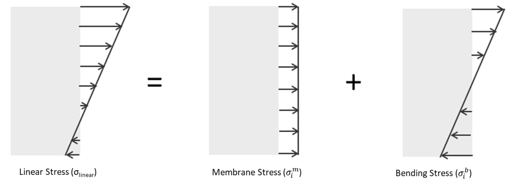

Note: Therefore, the calculation method used in the seam weld analysis engine is equally applicable to stresses calculated from either solid or thin-shell models. This generates top and bottom surface stresses in the same form as would be generated from a thin-shell model.
Figure 4.

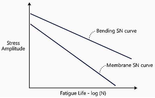

Experiments show that two types of SN curves are required to perform seam weld fatigue analysis based on a method suggested by M. Fermér, M Andréasson, and B Frodin. Based on lab tests, two SN curves were plotted (Figure 5). The upper curve is obtained in tests where the maximum stress is dominated by bending moment and the lower curve is obtained from tests where membrane force dominates the maximum stress.
Figure 5.
The upper and lower curves are referred to as bending S-N curve and membrane S-N curve, respectively. It is recommended that membrane S-N curve should be used when membrane stress dominates in an element and a bending S-N curve should be used when bending stress dominates. Interpolation between the two curves may be carried out depending on the degree of bending dominance.(8)

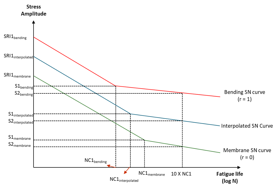

Interpolation between Membrane and Bending S-N Curves
Figure 6.
The linear interpolation method, as shown in Figure 6, uses the value of the interpolation factor (IF). For the interpolated curve, the calculation is done as follows, for the Fatigue Strength coefficient value (SRI1):(12)
SRI1interpolated = SRI1membrane + (SRI1bending – SRI1membrane) ∙ IF
This defines the stress level at 1 cycle.(13)
Nc1interpolated = 10(log10Nc1membrane + (log10 Nc1bending – log10(Nc1membrane) ∙IF))
(14)
S1interpolated = S1membrane + (S1bending – S1membrane) ∙ IF
This defines the stress level at Nc1interpolated cycles. These two points define the first section of the curve up to Nc1interpolated cycles. The last section is defined by finding a third point as follows. A life value is defined being 10 times greater of the Nc1 values for the stiff and flexible curves. From these, we can calculate S2bending and S2membrane. From these, we can interpolate to get S2interpolated which defines the high cycle part of the curve.(15)
S2interpolated = S2membrane + (S2bending – S2membrane). IF

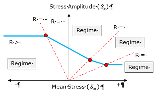

Based on FKM-Guidelines, the Haigh diagram is divided into four regimes based on the Stress ratio (R=Smin/Smax) values. The corrected value is then used to choose the SN curve for the damage and life calculation stage.
The FKM equations below illustrate the calculation of Corrected Stress Amplitude ( S e A MathType@MTEF@5@5@+= feaahqart1ev3aaatCvAUfeBSjuyZL2yd9gzLbvyNv2CaerbuLwBLn hiov2DGi1BTfMBaeXatLxBI9gBaerbd9wDYLwzYbItLDharqqtubsr 4rNCHbGeaGqiVu0Je9sqqrpepC0xbbL8F4rqqrFfpeea0xe9Lq=Jc9 vqaqpepm0xbba9pwe9Q8fs0=yqaqpepae9pg0FirpepeKkFr0xfr=x fr=xb9adbaqaaeGaciGaaiaabeqaamaabaabaaGcbaGaam4uamaaDa aaleaacaWGLbaabaGaamyqaaaaaaa@38A8@ ). The actual value of stress used in the Damage calculations is the Corrected stress Amplitude (which is 2 ⋅ S e A MathType@MTEF@5@5@+= feaahqart1ev3aaatCvAUfeBSjuyZL2yd9gzLbvyNv2CaerbuLwBLn hiov2DGi1BTfMBaeXatLxBI9gBaerbd9wDYLwzYbItLDharqqtubsr 4rNCHbGeaGqiVu0Je9sqqrpepC0xbbL8F4rqqrFfpeea0xe9Lq=Jc9 vqaqpepm0xbba9pwe9Q8fs0=yqaqpepae9pg0FirpepeKkFr0xfr=x fr=xb9adbaqaaeGaciGaaiaabeqaamaabaabaaGcbaGaaGOmaiabgw SixlaadofadaqhaaWcbaGaamyzaaqaaiaadgeaaaaaaa@3BAE@ ). These equations apply for SN curves that you input.
  • Regime 1 (R>1.0): S e A = S a ( 1 − M ) MathType@MTEF@5@5@+= feaahqart1ev3aaatCvAUfeBSjuyZL2yd9gzLbvyNv2CaerbuLwBLn hiov2DGi1BTfMBaeXatLxBI9gBaerbd9wDYLwzYbItLDharqqtubsr 4rNCHbGeaGqiVu0Je9sqqrpepC0xbbL8F4rqqrFfpeea0xe9Lq=Jc9 vqaqpepm0xbba9pwe9Q8fs0=yqaqpepae9pg0FirpepeKkFr0xfr=x fr=xb9adbaqaaeGaciGaaiaabeqaamaabaabaaGcbaGaam4uamaaDa aaleaacaWGLbaabaGaamyqaaaakiabg2da9iaadofadaWgaaWcbaGa amyyaaqabaGccaGGOaGaaGymaiabgkHiTiaad2eacaGGPaaaaa@3F7F@
  • Regime 2 ( − ∞ ≤ R ≤ 0.0 MathType@MTEF@5@5@+= feaahqart1ev3aaatCvAUfeBSjuyZL2yd9gzLbvyNv2CaerbuLwBLn hiov2DGi1BTfMBaeXatLxBI9gBaerbd9wDYLwzYbItLDharqqtubsr 4rNCHbGeaGqiVu0Je9sqqrpepC0xbbL8F4rqqrFfpeea0xe9Lq=Jc9 vqaqpepm0xbba9pwe9Q8fs0=yqaqpepae9pg0FirpepeKkFr0xfr=x fr=xb9adbaqaaeGaciGaaiaabeqaamaabaabaaGcbaGaeyOeI0Iaey OhIuQaeyizImQaamOuaiabgsMiJkaaicdacaGGUaGaaGimaaaa@3EB8@ ): S e A = S a + M * S m MathType@MTEF@5@5@+= feaahqart1ev3aaatCvAUfeBSjuyZL2yd9gzLbvyNv2CaerbuLwBLn hiov2DGi1BTfMBaeXatLxBI9gBaerbd9wDYLwzYbItLDharqqtubsr 4rNCHbGeaGqiVu0Je9sqqrpepC0xbbL8F4rqqrFfpeea0xe9Lq=Jc9 vqaqpepm0xbba9pwe9Q8fs0=yqaqpepae9pg0FirpepeKkFr0xfr=x fr=xb9adbaqaaeGaciGaaiaabeqaamaabaabaaGcbaGaam4uamaaDa aaleaacaWGLbaabaGaamyqaaaakiabg2da9iaadofadaWgaaWcbaGa amyyaaqabaGccqGHRaWkcaWGnbGaaiOkaiaadofadaWgaaWcbaGaam yBaaqabaaaaa@4004@
  • Regime 3 (0.0<R<0.5): S e A = ( 1 + M ) S a + ( M / 3 ) * S m 1 + M / 3 MathType@MTEF@5@5@+= feaahqart1ev3aaatCvAUfeBSjuyZL2yd9gzLbvyNv2CaerbuLwBLn hiov2DGi1BTfMBaeXatLxBI9gBaerbd9wDYLwzYbItLDharqqtubsr 4rNCHbGeaGqiVu0Je9sqqrpepC0xbbL8F4rqqrFfpeea0xe9Lq=Jc9 vqaqpepm0xbba9pwe9Q8fs0=yqaqpepae9pg0FirpepeKkFr0xfr=x fr=xb9adbaqaaeGaciGaaiaabeqaamaabaabaaGcbaGaam4uamaaDa aaleaacaWGLbaabaGaamyqaaaakiabg2da9iaacIcacaaIXaGaey4k aSIaamytaiaacMcadaWcaaqaaiaadofadaWgaaWcbaGaamyyaaqaba GccqGHRaWkcaGGOaGaamytaiaac+cacaaIZaGaaiykaiaacQcacaWG tbWaaSbaaSqaaiaad2gaaeqaaaGcbaGaaGymaiabgUcaRiaad2eaca GGVaGaaG4maaaaaaa@4A8E@
  • Regime 4 ( R ≥ 0.5 MathType@MTEF@5@5@+= feaahqart1ev3aaatCvAUfeBSjuyZL2yd9gzLbvyNv2CaerbuLwBLn hiov2DGi1BTfMBaeXatLxBI9gBaerbd9wDYLwzYbItLDharqqtubsr 4rNCHbGeaGqiVu0Je9sqqrpepC0xbbL8F4rqqrFfpeea0xe9Lq=Jc9 vqaqpepm0xbba9pwe9Q8fs0=yqaqpepae9pg0FirpepeKkFr0xfr=x fr=xb9adbaqaaeGaciGaaiaabeqaamaabaabaaGcbaGaamOuaiabgw MiZkaaicdacaGGUaGaaGynaaaa@3ABB@ ): S e A = 3 S a ( 1 + M ) 2 3 + M MathType@MTEF@5@5@+= feaahqart1ev3aaatCvAUfeBSjuyZL2yd9gzLbvyNv2CaerbuLwBLn hiov2DGi1BTfMBaeXatLxBI9gBaerbd9wDYLwzYbItLDharqqtubsr 4rNCHbGeaGqiVu0Je9sqqrpepC0xbbL8F4rqqrFfpeea0xe9Lq=Jc9 vqaqpepm0xbba9pwe9Q8fs0=yqaqpepae9pg0FirpepeKkFr0xfr=x fr=xb9adbaqaaeGaciGaaiaabeqaamaabaabaaGcbaGaam4uamaaDa aaleaacaWGLbaabaGaamyqaaaakiabg2da9maalaaabaGaaG4maiaa dofadaWgaaWcbaGaamyyaaqabaGccaGGOaGaaGymaiabgUcaRiaad2 eacaGGPaWaaWbaaSqabeaacaaIYaaaaaGcbaGaaG4maiabgUcaRiaa d2eaaaaaaa@43A5@
