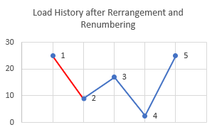

1, 2, 3, and 4 are the four peaks and valleys. Point 4 is the peak stress in
the load history and moves to the front during rearrangement as shown in Figure 3. After
rearrangement, the peaks and valleys are renumbered.Figure 3.
Next, pick the first three stress values (1, 2, and 3) and determine if a cycle is
present. If represents the stress value, point I, then
Since , no cycle is extracted from point 1 to 2. Now
consider the next three points as follows:

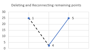

, so a cycle is extracted from point 2 to 3. Since a
cycle has been extracted, delete the two points from the graph. Figure 4.
Apply the same process to the remaining points:
In this case, so another cycle is extracted from point 1 to 4.
These two points are discarded. There are five points remaining, therefore the
rainflow counting process is complete.

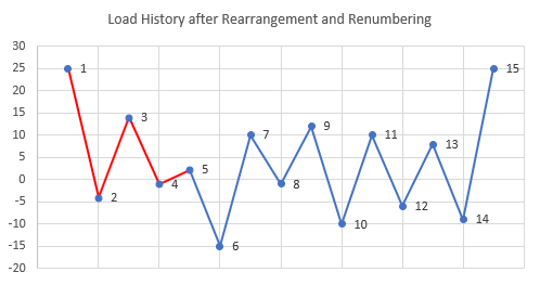

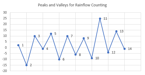

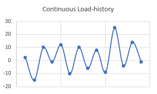

Consider the load history below: Figure 5.
Since this load history is continuous, it is converted into a load history
consisting of peaks and valleys only, as follows: Figure 6.
Load point 11 is the highest valued load, so the load history is now rearranged and
renumbered as follows: Figure 7.
The load history is rearranged so all points including and after the highest
load are moved to the beginning of the load history and are removed from the end of
the load history.
