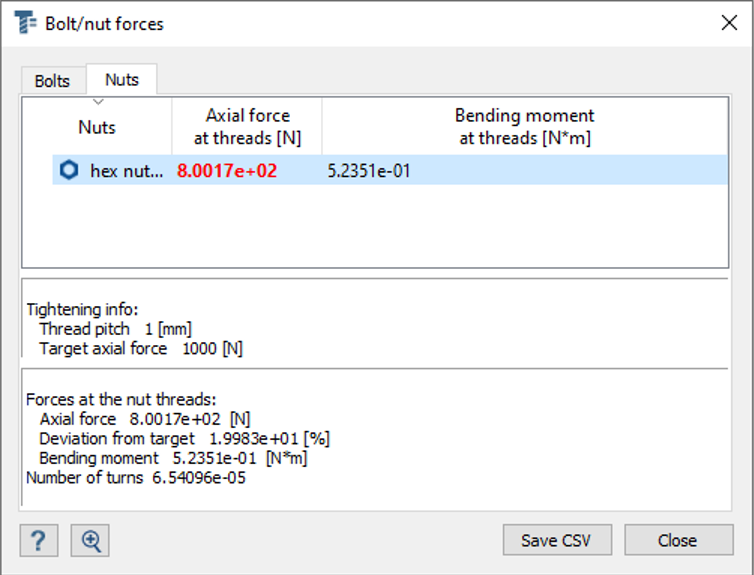

Action Process View bolt forces - On the workbench toolbar, click the
 (Bolt/nut resultant forces)
                                    icon. - In the modeling window, click on either a nut or a bolt to see forces listed in the Bolt/nut forces dialog.

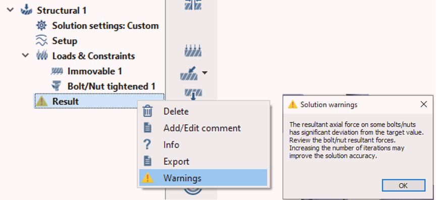

Note: When the resultant axial force of the nut deviates by over 10 percent, the following occurs:- In the Project Tree, a warning icon appears
                                next to the Results branch. Right-click on the
                                    Results and select
                                    Warnings to view.
Figure 1. - In the Bolt/Nut
                            forces dialog, nuts with significant deviation are marked in
                        red and deviation from the target is listed.
