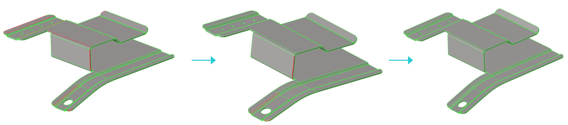

- Use the View Controls toolbar to evaluate model integrity.

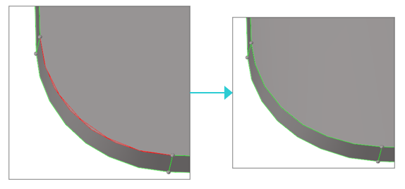

- Delete the surface that overhangs the round corner using the Split tool.

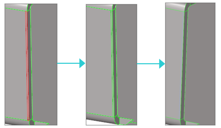

- Create surfaces to fill gaps in the model using the Patch tool.
- Combine free edges using the Stitch tool and change tolerance.
- Reload the model and quickly combine free edges using higher tolerance.
- Reload the model and use the Surface Repair tool to adjust the topology.

Delete Overhanging Surface
In this step, you will delete the surface that overhangs the round corner using the Split tool.
Create Surfaces
In this step, you will create surfaces to fill gaps in the model using the Patch tool.
Combine Free Edges
In this step, you will combine free edges using the Stitch tool and change tolerance.
