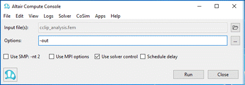

From Compute Console (ACC)
The Compute Console (ACC) provides an interactive Graphical User Interface (GUI) that allows you to select input files for OptiStruct runs. It also allows you to define run options, activate multiple processor SMP and/or MPI runs. Any required environment variables for OptiStruct runs are predefined when the Compute Console (ACC) is used to submit jobs.
On Windows, the Compute Console (ACC) can be started by selecting Start > Altair 2023 > Compute Console.
With this utility, you can start multiple solver runs, queue successive runs, submit runs to a remote server (standalone Linux host or PBS cluster) and also maintains a history of solutions. On Unix platforms, this utility can be started from the command line as:
<install_dir>/altair/hwsolvers/scripts/<solver name> -gui
For more information and to access the Altair Compute Console (ACC) help, navigate to Help > Compute Console Manual from the Altair Compute Console (ACC) GUI.
