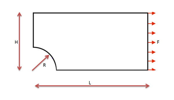

Test No. VS08 Find the maximum stress of a plate with a
    hole.
    Definition
      Due to symmetry, only ¼ section was analyzed (Figure 1).
      The units are SI.
      Sliding constraints applied to the left, back, and bottom faces.
      The load is 5000N applied to the right face.*
      The model parameters are:
            - Parameters
            - Value
            - L
            - 100mm
            - H
            - 50mm
            - R
            - 20mm
            - F
            - 100N/mm2
            - Thickness
            - 1mm
      The material properties are:
            - Properties
            - Value
            - Modulus of Elasticity
            - 2.1e+11
            - Poisson's Ratio
            - 0.3
