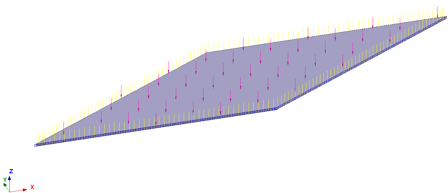

A skew plate (Figure 1) is subjected to uniform pressure.

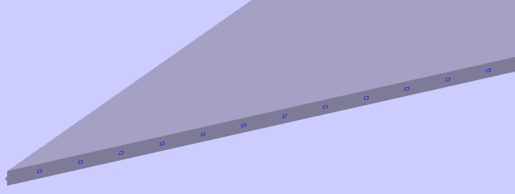

The load is 0.7 KPa. The plate is simply supported at the perimeter: Uz = 0 along edges AB, BC, CD, and AD. Ux = Uy = 0 at point A and Uy = 0 at point B to prevent rigid body motion.

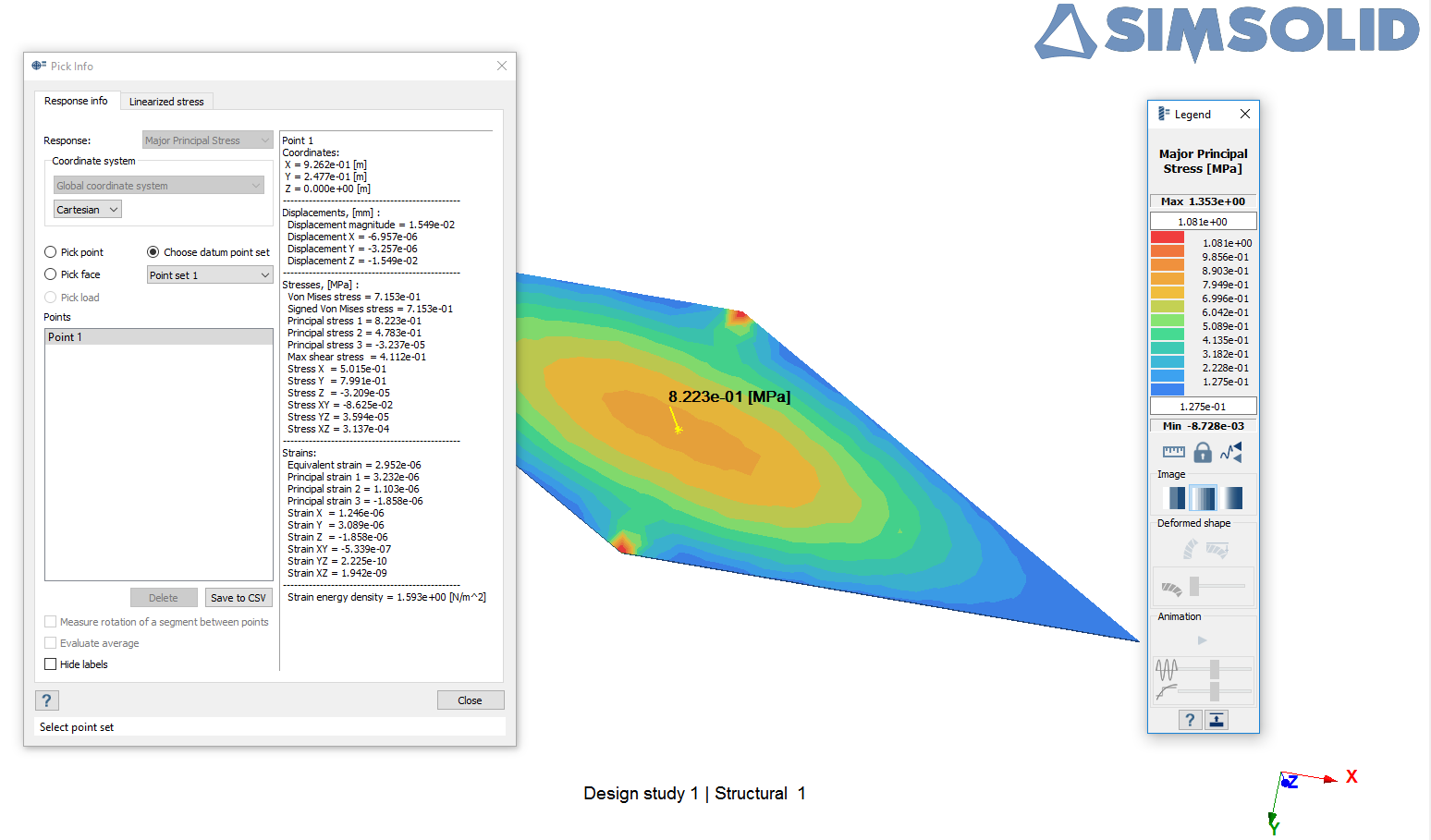

Reference Solution* | SimSolid | % Difference | |
Maximum Principle Stress [MPa] | 8.0200E-01 | 8.223E-01 | 2.5% |
