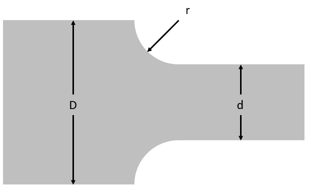

Test No. VS15 Find maximum normal stress for two
    configurations of a filleted bar.
    Definition
      Stress concentration is given by:
(1)
      The following table outlines the two configurations of the loads on the bar.
Table 1.
                | Dimension |
                Configuration 1 |
                Configuration 2 |
                | D |
                33 mm |
                45 mm |
                | d |
                30 mm |
                30 mm |
                | r |
                1.5 mm |
                6 mm |
                | t |
                2 mm |
                2 mm |
                | D/d |
                1.10 |
                1.50 |
                | r/d |
                0.05 |
                0.20 |
                | Kt |
                ~2 |
                ~1.75 |
      The material properties are:
            - Properties
            - Value
            - Modulus of Elasticity
            - 2.1e+11 Pa
            - Poisson's Ratio
            - 0.3
    Results
Run
SimSolid analysis with 3 adaptive passes, Adapt to features and thin
        solids on. The following table summarizes the stress results.
                Reference  |
                SimSolid |
                % Difference |
                | Max Prin. Stress - Configuration 1 |
                2.00 |
                2.04 |
                2.00% |
                | Max Prin. Stress - Configuration 2 |
                1.80 |
                1.84 |
                2.22% |
