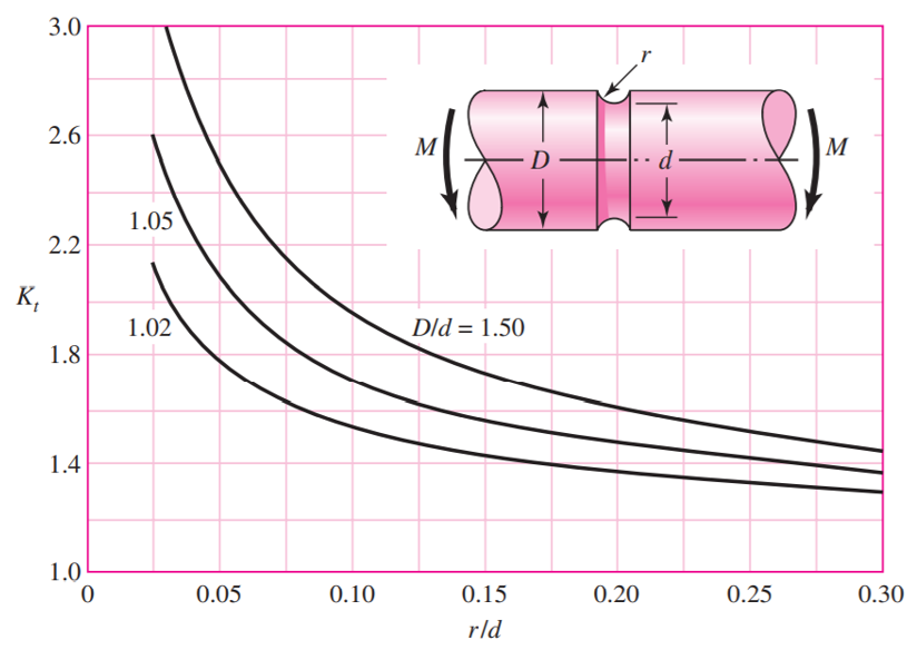

Test No. VS17 Find the stress concentration in a grooved shaft.
Definition
The shaft is fixed on one end. A bending moment of 98125 N-mm is applied on the other end. Bending stress is calculated as 1 MPa using the equation below.(1)
σ0=Mc/l
Where,
c
d/2
l
πd4/64
The units are SI.
The model parameters are:
Value
r
25 mm
D
150 mm
d
100 mm
r/d
0.25
D/d
1.5
Results
The following table summarizes the stress results.
  Theory1 SimSolid % Difference
σy Bending Stress [MPa] 1.5 1.5 NIL
1
Page 1030 , Shigley’s Mechanical Engineering Design, Ninth Edition, Richard G Budynass and J. Keith Nisbett
