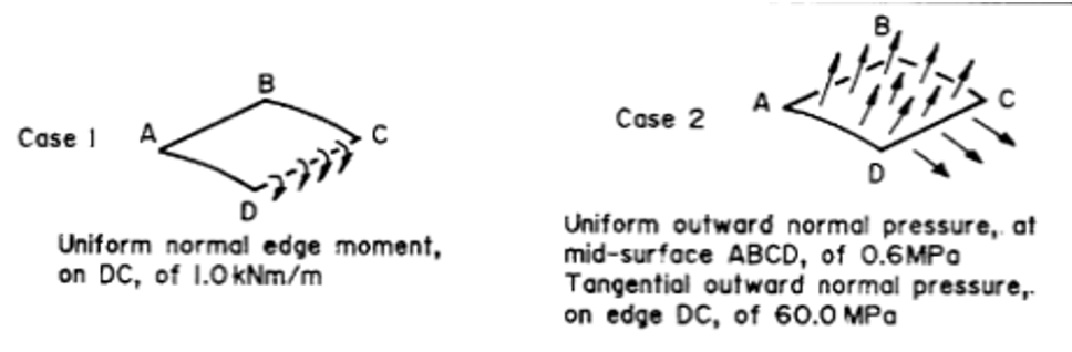

Test No. VS22 Find outer surface tangential stress for a cylindrical shell.

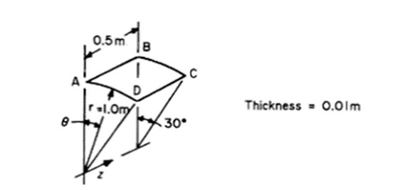

- Boundary Conditions
 - Edges AB
 - All translations and rotations are zero
 - Edge AD and edge BC
 - Symmetry about rθ plane
- Property
 - Value
 - Young's Modulus
 - 2.1e5 MPa
 - Poisson's Ratio
 - 0.3

| Tangential stress at Point E | Reference1 | SimSolid | % Difference |
| Case 1 | 60 MPa | 59.2 MPa | ~1 |
| Case 2 | 60 MPa | 58.7 MPa | ~2 |
