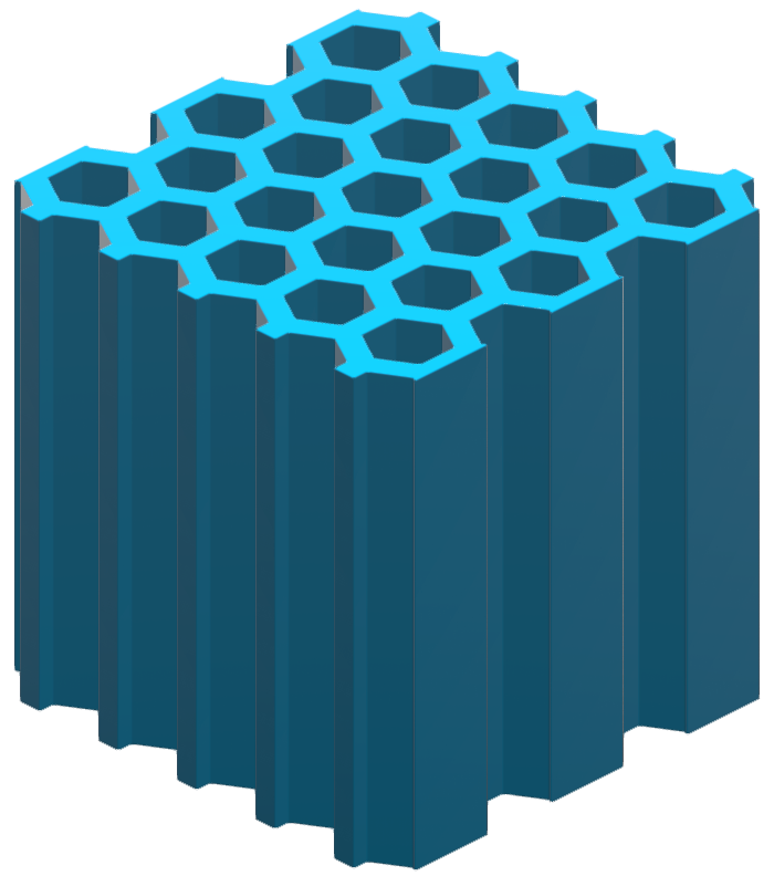

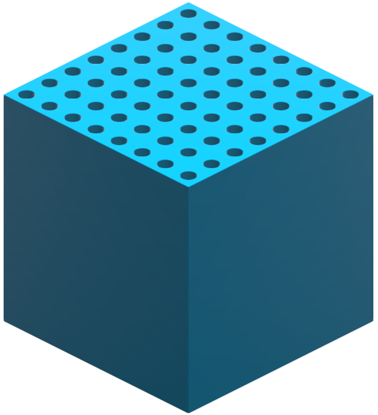

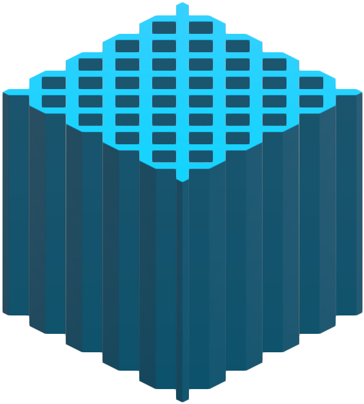

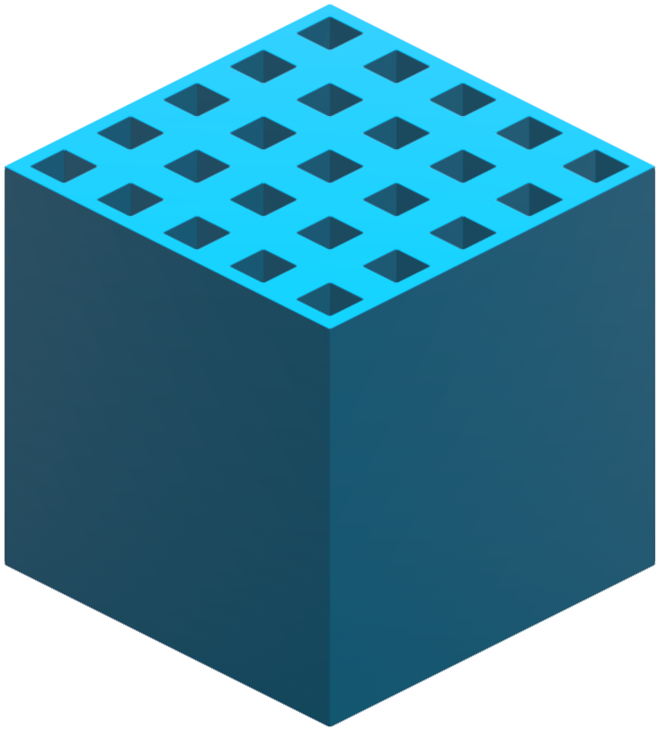

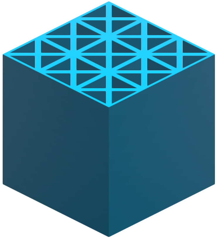

Option Description Cell - Type Select a cell type. - Hexagon
- Diamond
- Rectangle
- Triangle
- Isogrid
- Circle
