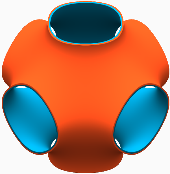

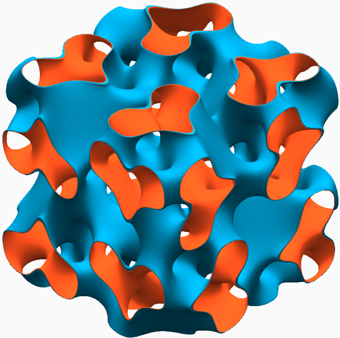

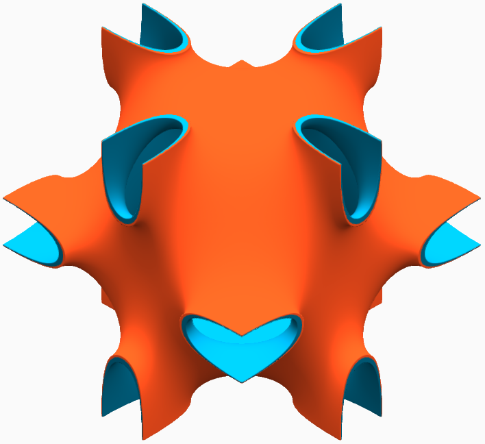

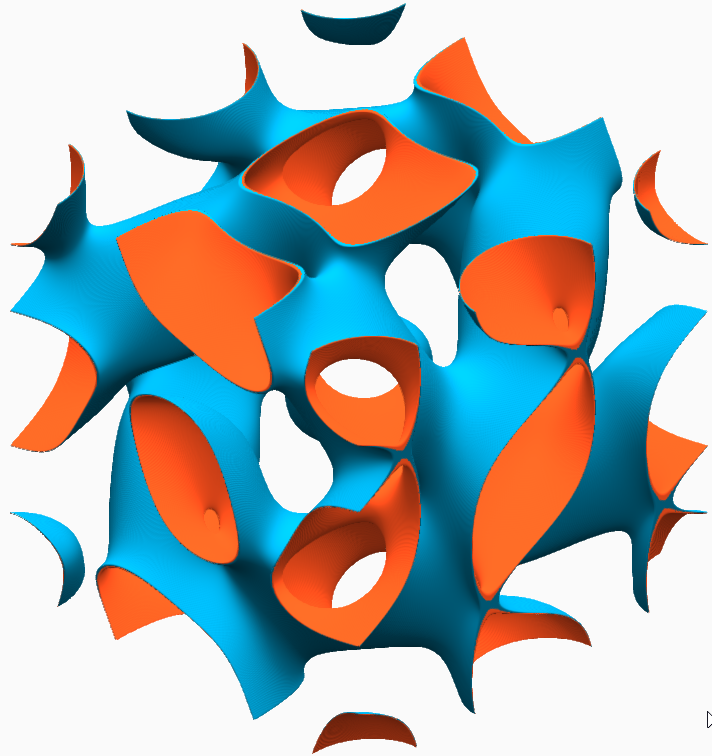

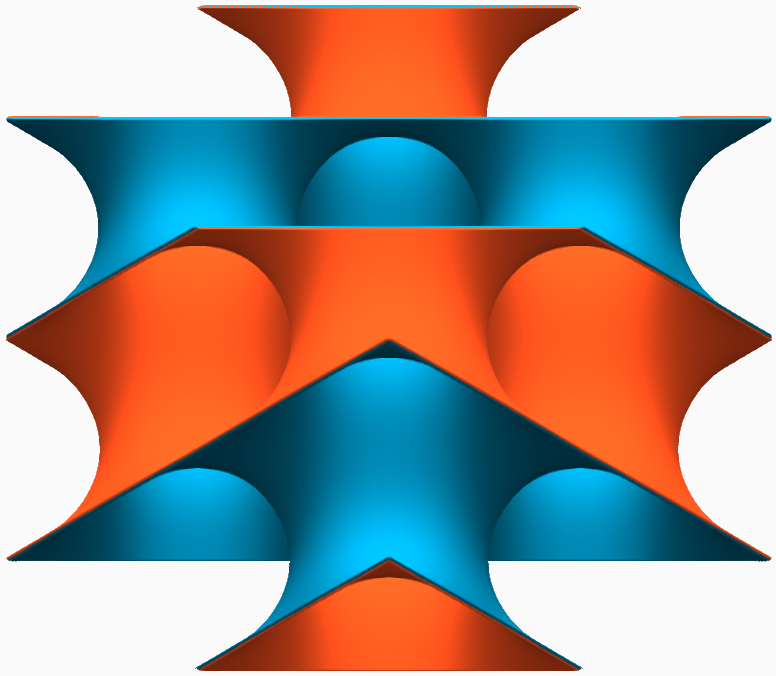

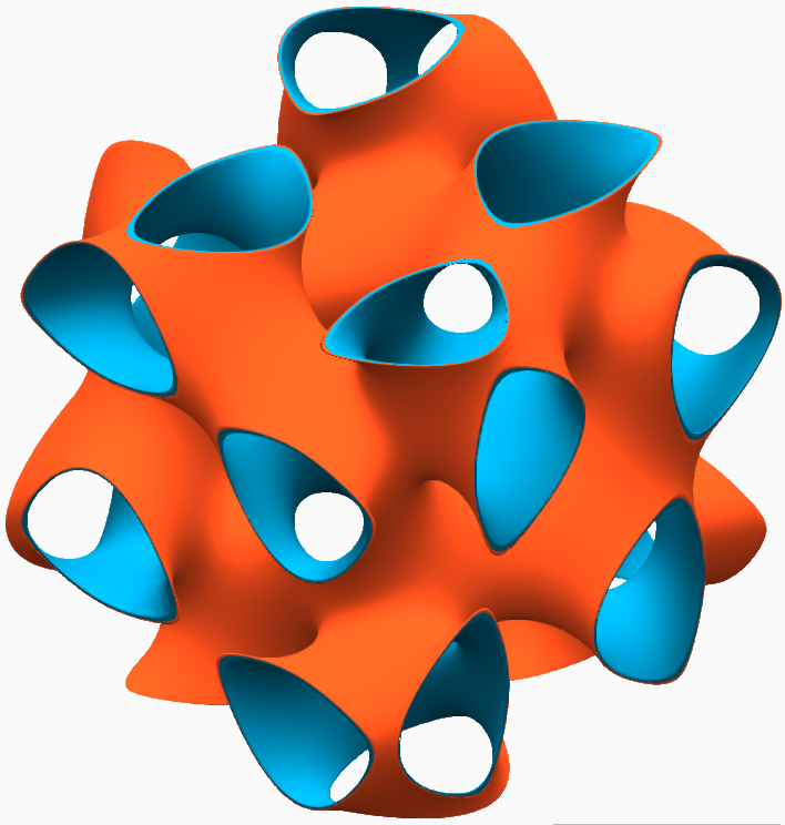

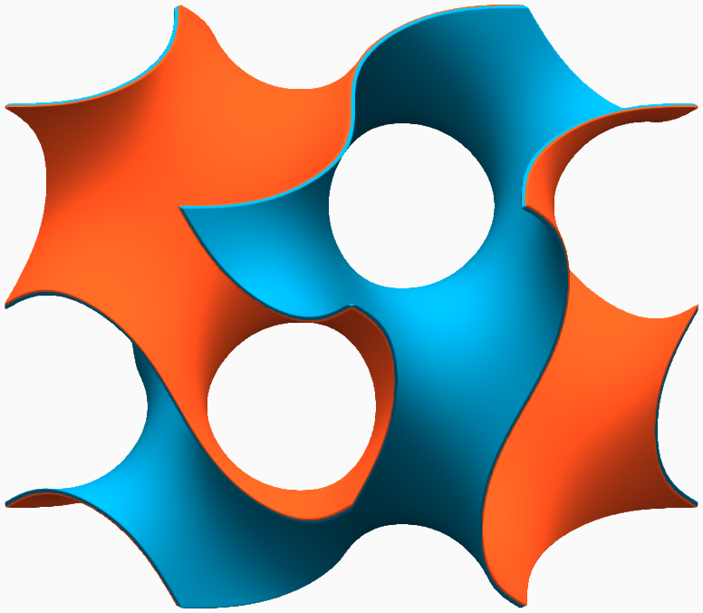

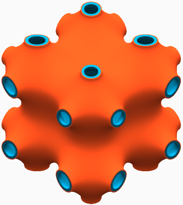

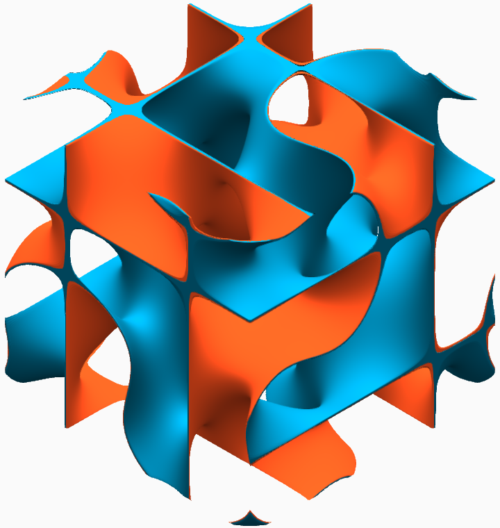

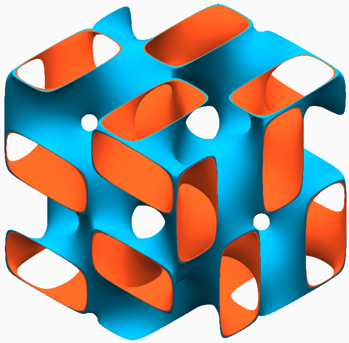

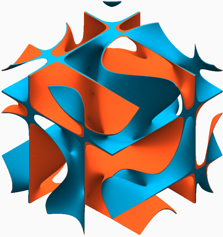

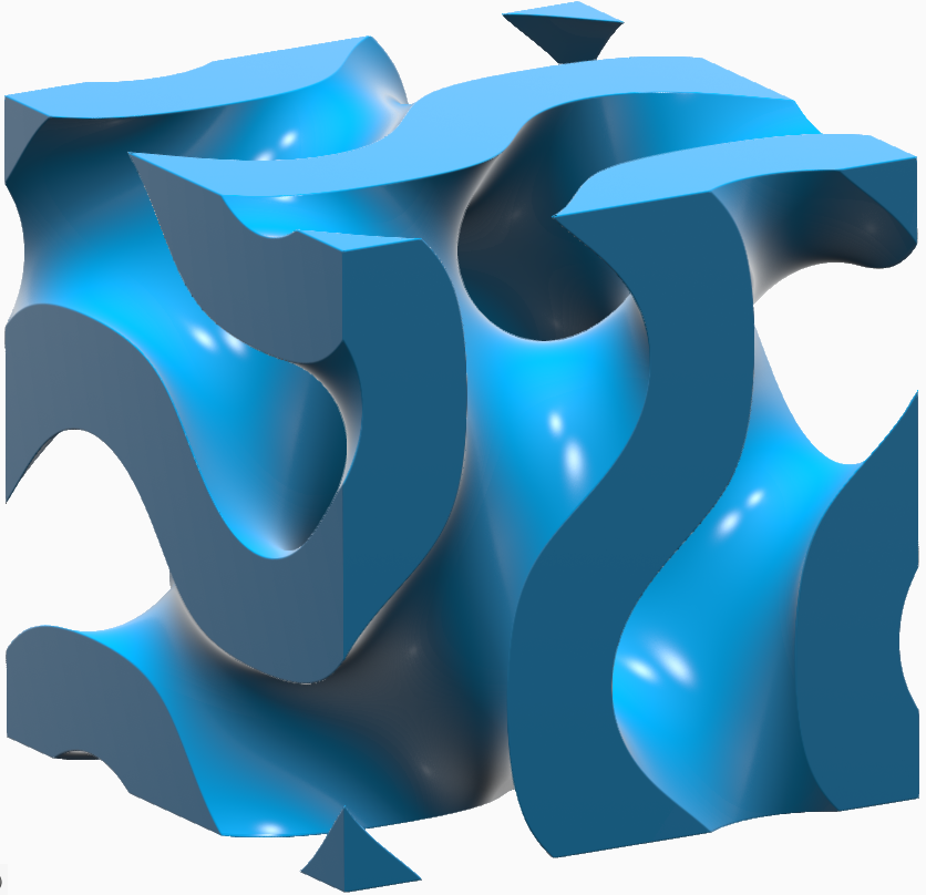

Option Description Surface - Unit Cell Select a unit cell type. In the following images, the surface that creates the lattice has been shown with blue coloring on one side of the surface and orange coloring on the other. These infinitely thin surfaces are transformed into solid volumes using the Surface Type options (Single and Double), which are described in the next section. - Gyroid
- Schwarz P

- Neovius

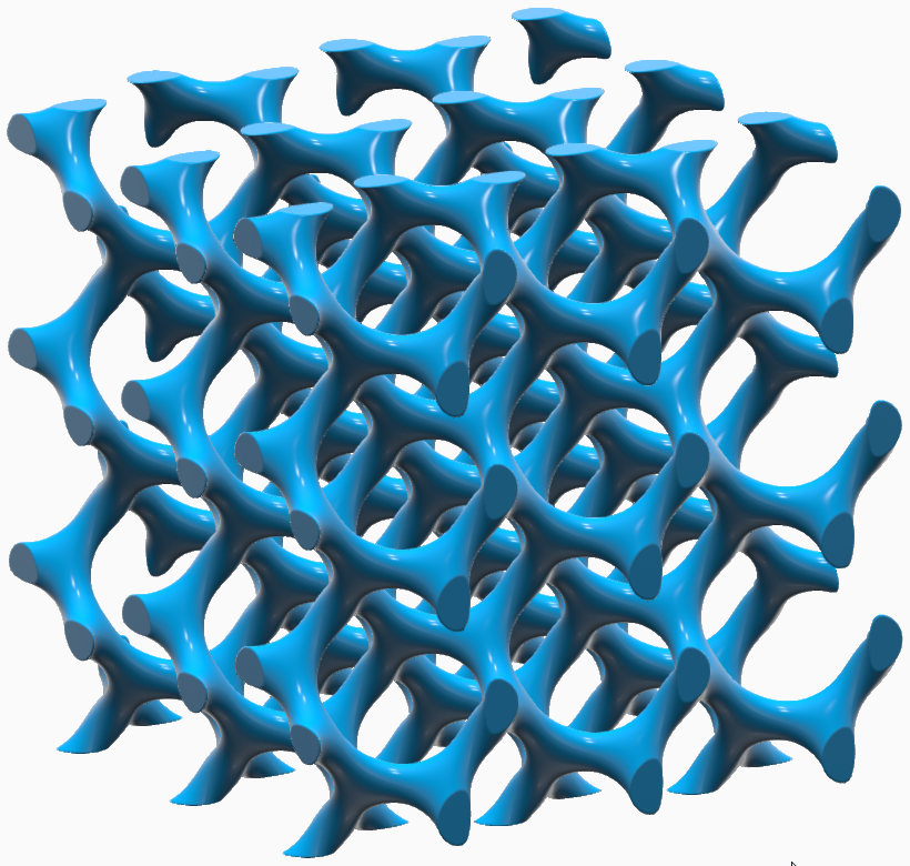

Surface - Type Select between a single or double surface lattice. - Single: Create a single, fully connected volume where one side of the surface is defined as being solid material.
