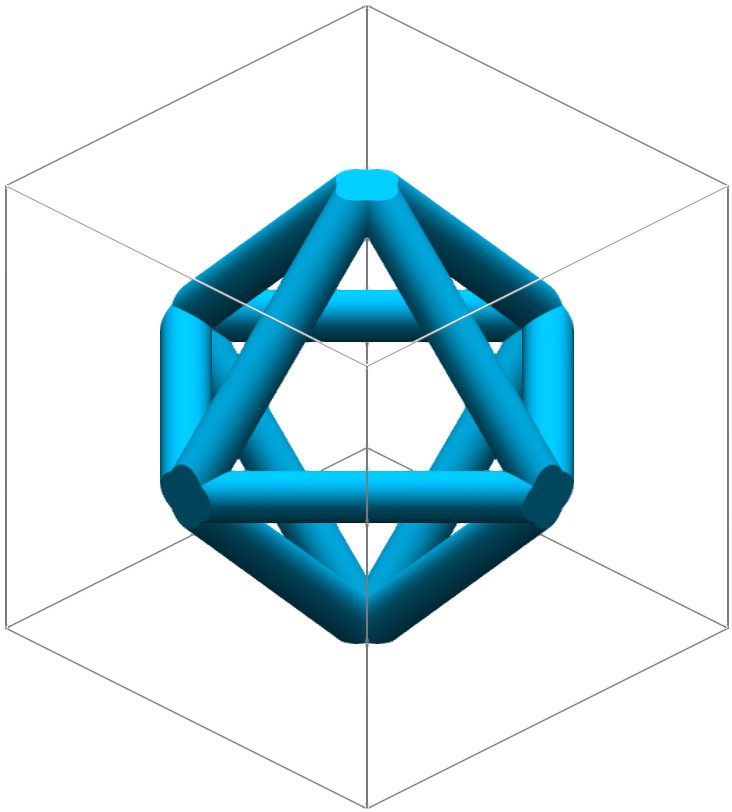

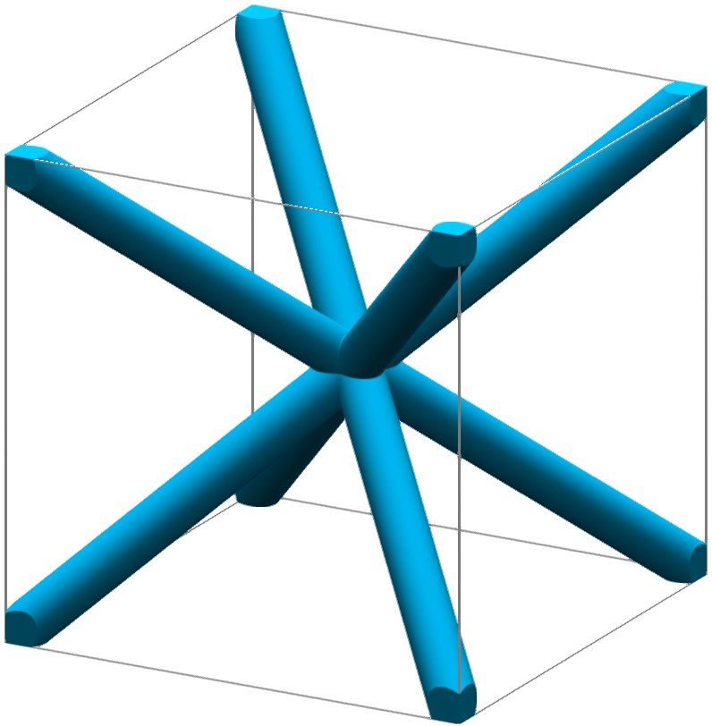

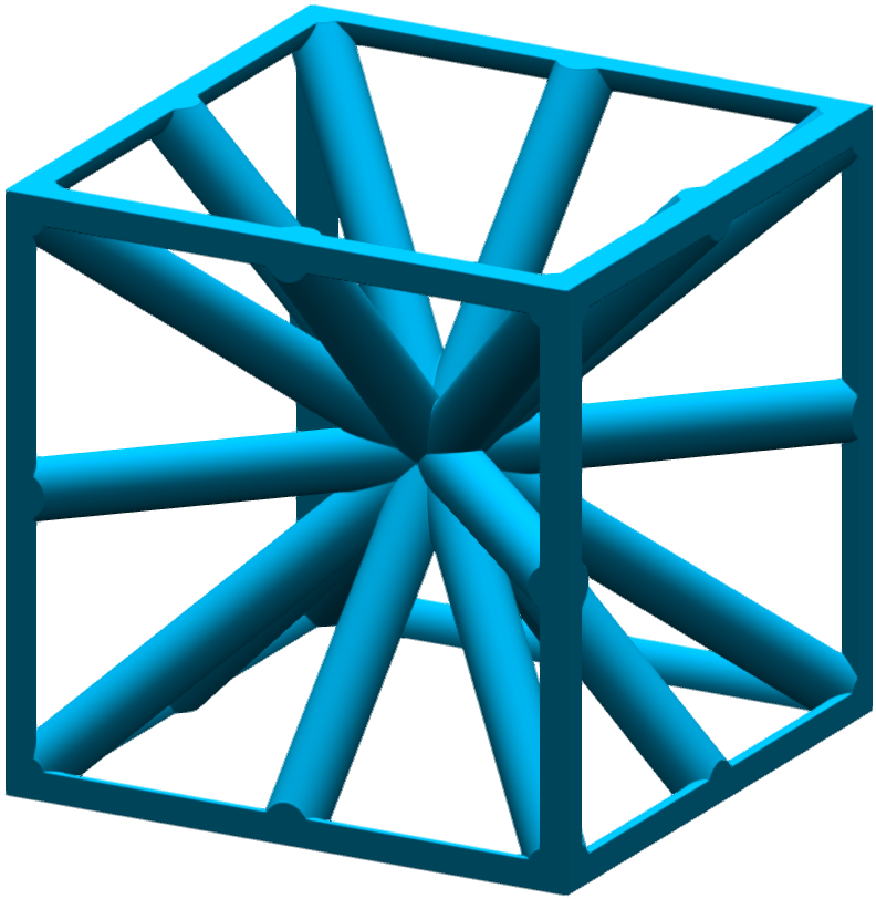

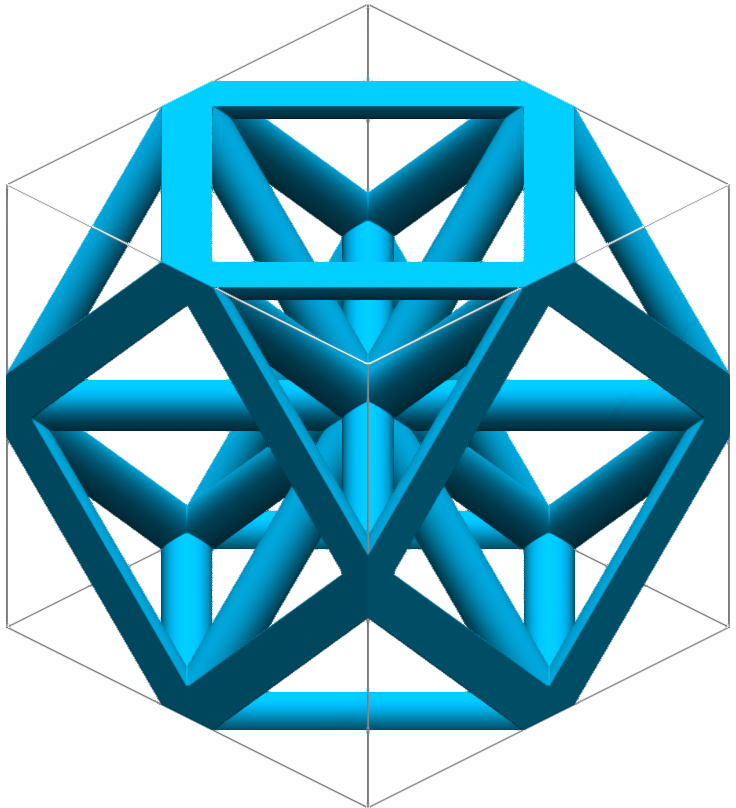

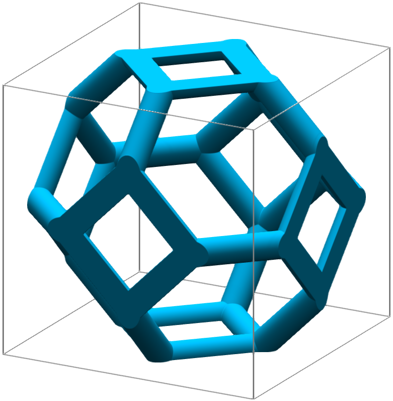

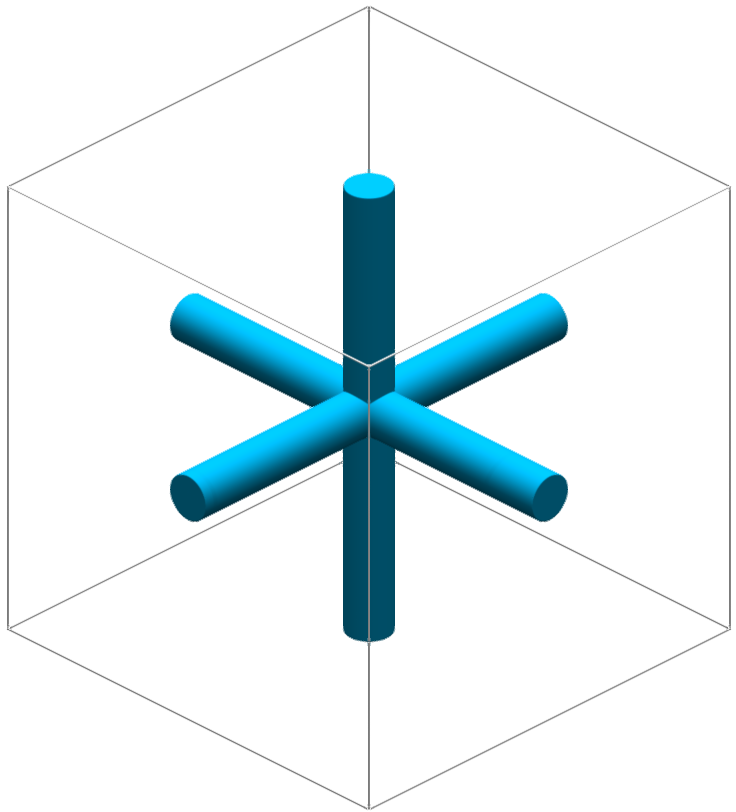

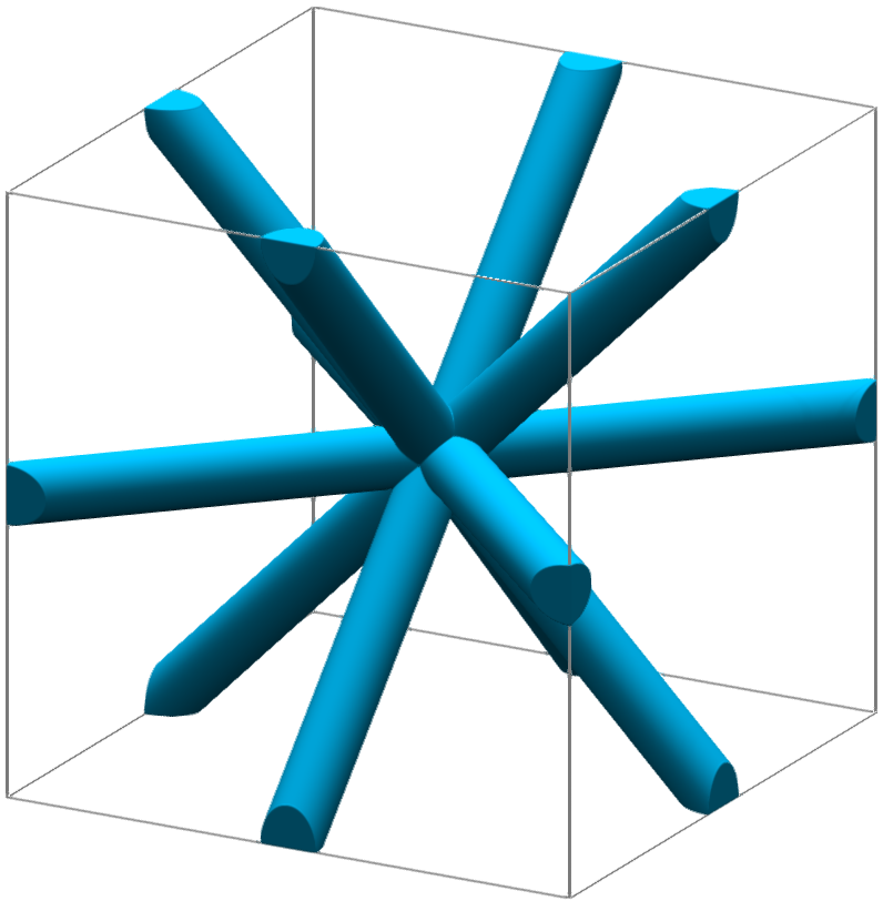

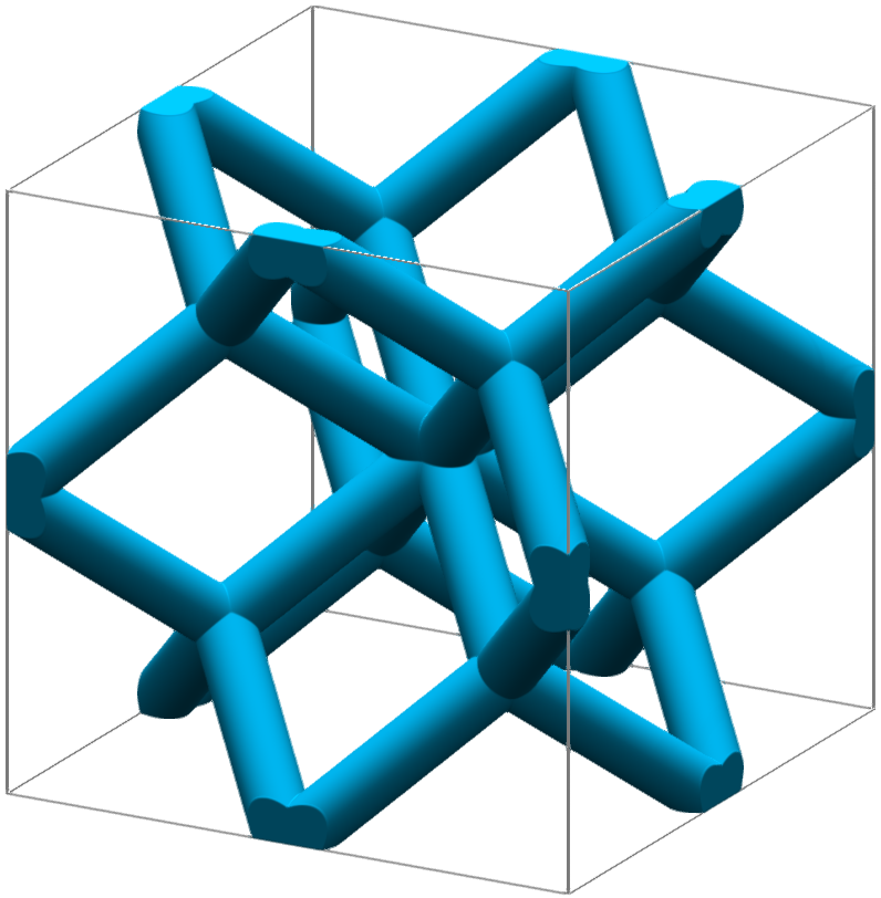

Option Description Cell - Type Select a cell type. - Body-Centered Cubic
- Face-Centered Primitive
- Face-Centered
Cubic
- Cubic Primitive
- Isotruss
- Octagon
- Hex Truss
- Kelvin Cell
- Flourite
- Diamond
- Truncated Cube
- Octet
- Create Unit Cell

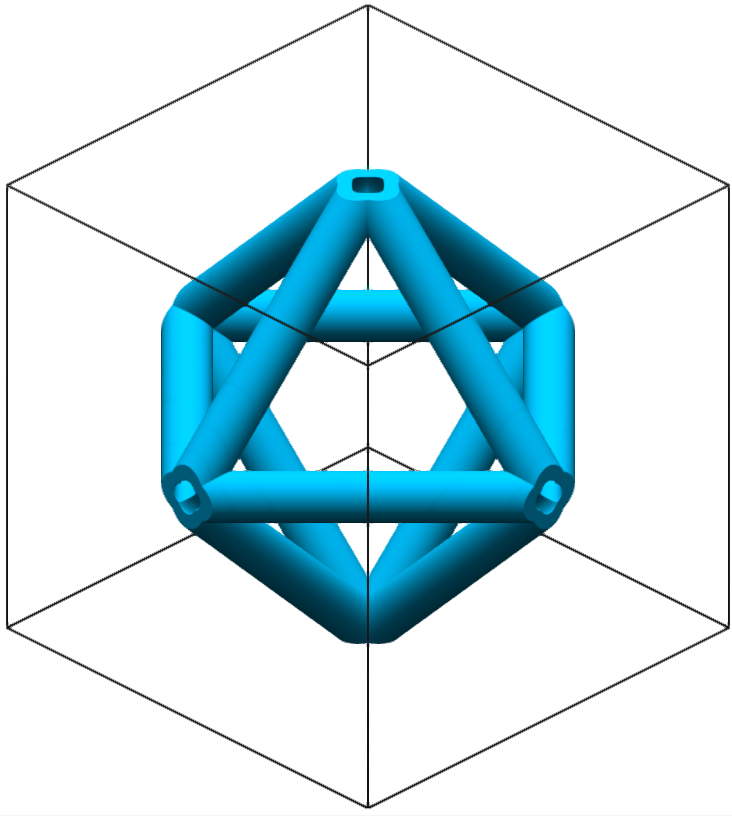

Cell - Type Select between solid or hollow struts. - Solid: Create solid
struts.
- Hollow: Create hollow
struts.

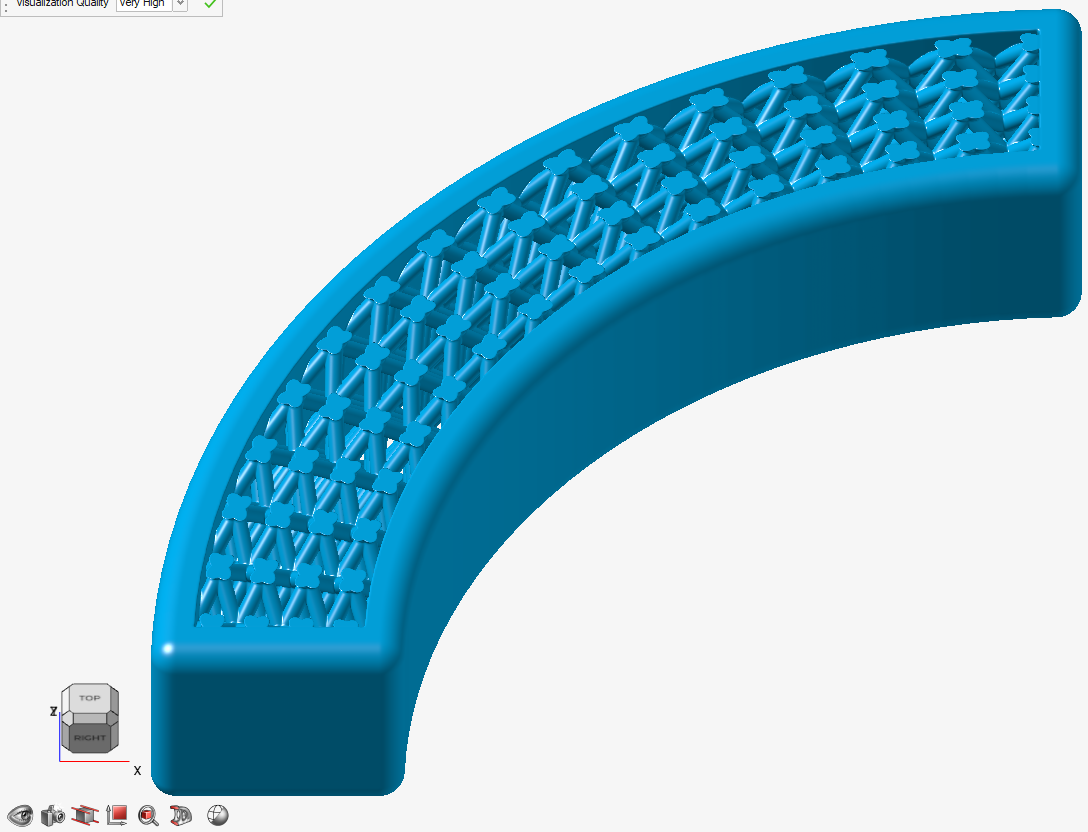

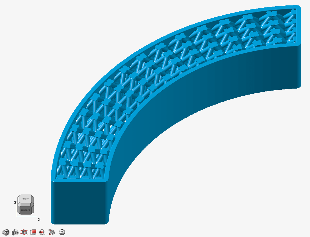

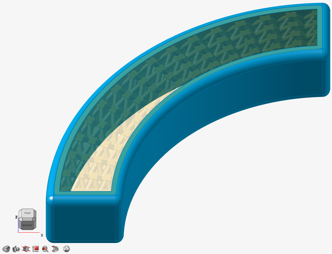

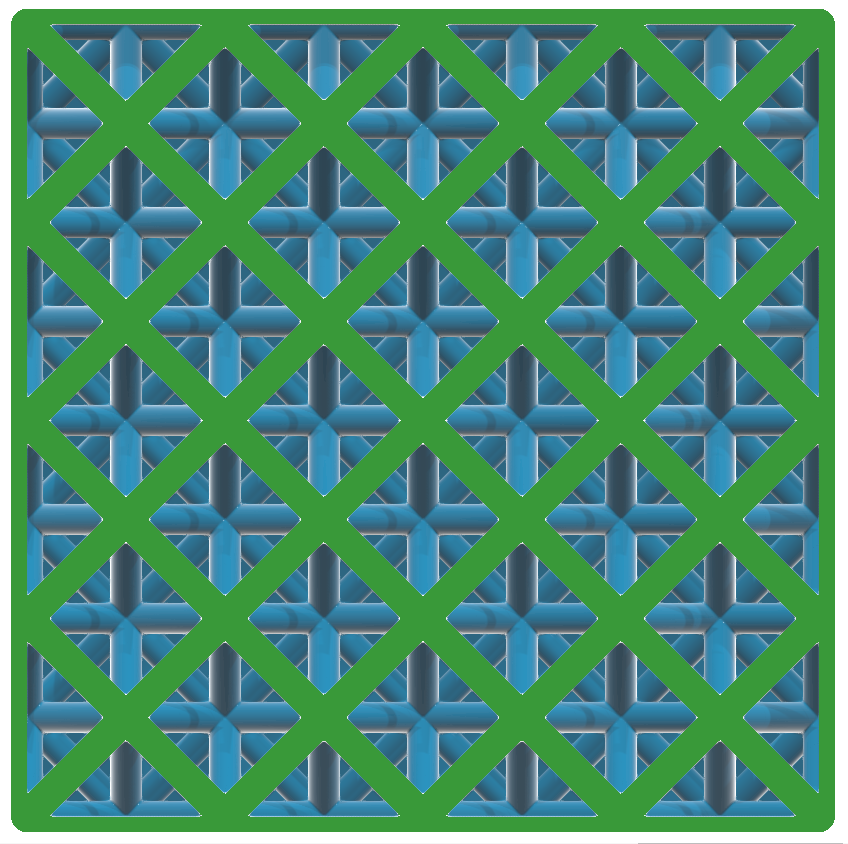

Select the Outer Body tab.
- Select a type of outer body.
- None: Don't create an outer body.
- Shell: Create an offset shell with an optional
trimming body.
Option Description Direction Select an offset direction for the shell. - Outward: Offset the shell outward from the lattice, increasing the size of the overall object.
- Inward: Offset the shell inward, consuming some of the lattice but maintaining the overall dimensions of the lattice.
- Both: Offset the shell both inward and outward.
Symmetry Symmetrically offset the shell inward and outward by the same distance. Outer Thickness Define the outward shell's offset thickness. Thickness can be entered directly, controlled with a variable, or controlled in each position in space using a field (field-driven design).
Inner Thickness Define the inward shell's offset thickness. Thickness can be entered directly, controlled with a variable, or controlled in each position in space using a field (field-driven design).

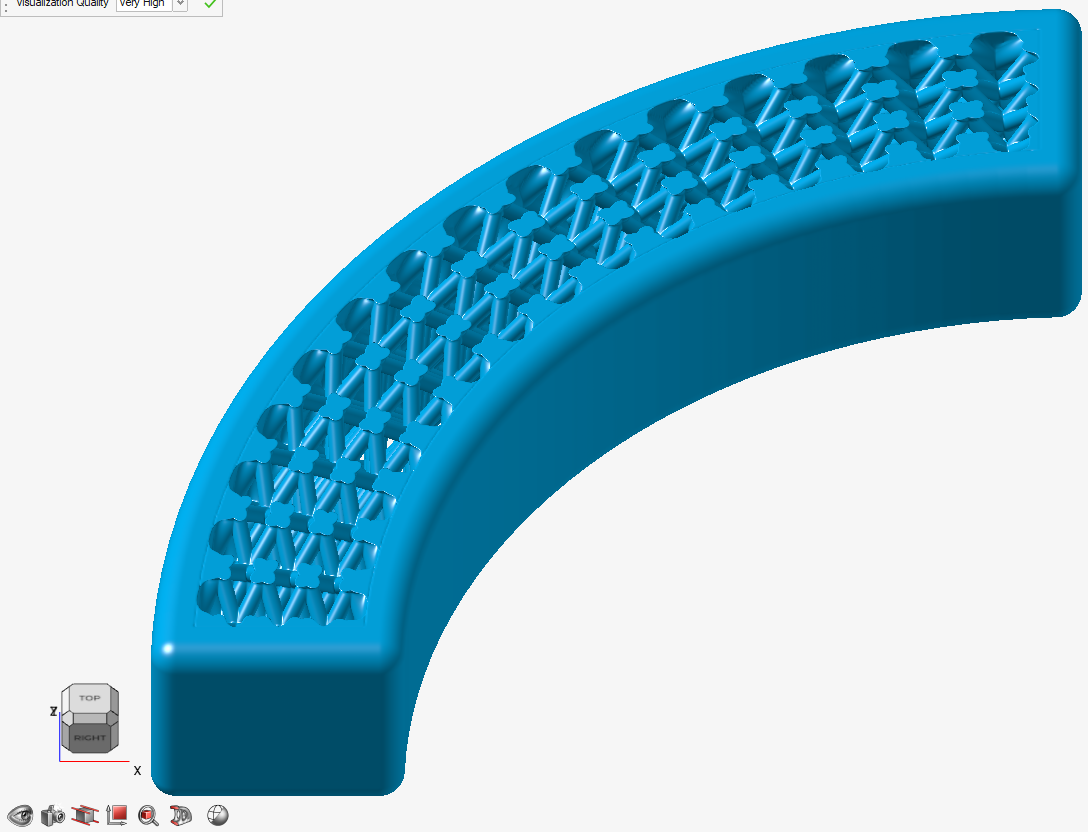

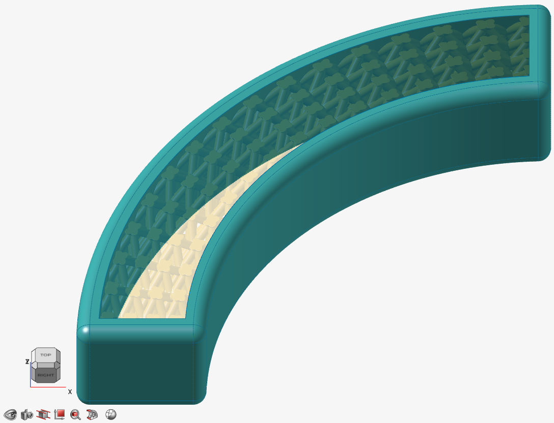

Trimming Body Select a body that's used to trim the shell. This can be used to trim areas of the shell, which is useful for fitting the lattice and its shell into a predefined volume, or when you want to expose some of the lattice so that it is not covered by a shell. In this example, a BRep body is chosen as the trimming body to expose some of the lattice. This image shows how the outward shell applied to the lattice overlaps with the trimming body.
Once the trimming is applied, some of the outward shell is cut away, exposing the lattice wherever the shell protrudes beyond the confines of the trimming body.

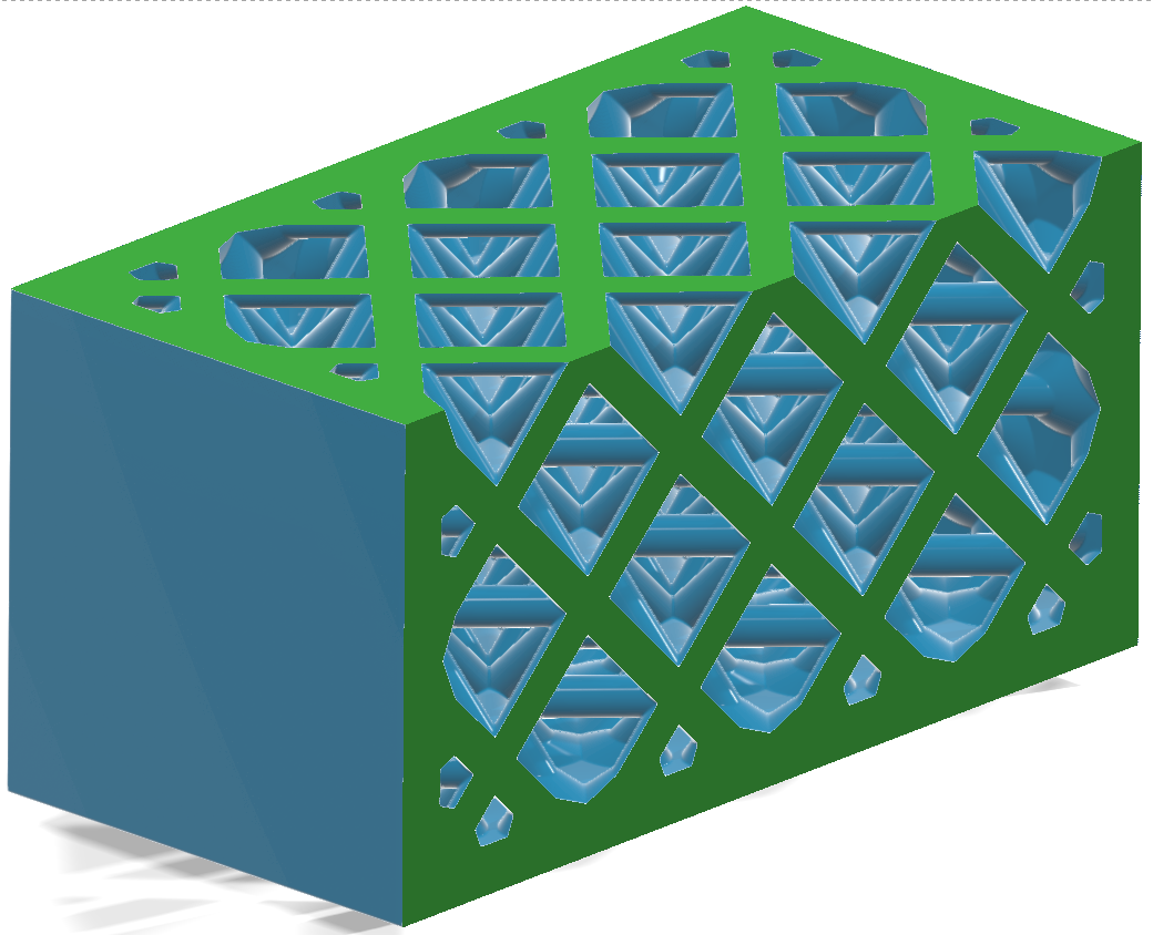

- Combine: Combine the outer body with the lattice
body, directly, without creating a shell that surrounds the
lattice
Option Description Combine Body Select a body to combine the planar lattice with. This body should be close to, or overlap with, the lattice.
Transition Choose the type of transition between the outer body and lattice body. - Sharp: The lattice
abruptly joins the surrounding outer body.
- Fillet: The lattice
blends into the outer body using a fillet. If you
selected this option, define the fillet
Radius.
- Chamfer: The lattice
blends into the outer body using a chamfer. If you
selected this option, define the chamfer
Distance.
For Fillet, the distance is the radius of the fillet and, for Chamfer, the distance is the setback of the chamfer. The distance can be entered directly, controlled with a variable, or controlled in each position in space using a field (field-driven design).
