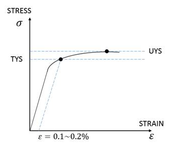

Figure 1.Many steels, especially heat-treated materials, do not have a well-defined elastic limit. In this case, the yield strength is usually defined at the point where the plastic strain is about 0.1% to 0.2%

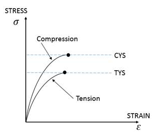

 - Brittle Materials
 - In brittle materials, failure takes place by fracture, therefore the
                            criteria of failure is different from that for ductile materials. The
                            fracture stress in compression is much larger than that in tension.
