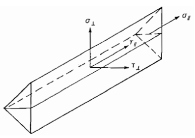

    Equivalent stress is calculated based on the below equation.(1) σ ⊥ 2 + 3 ( τ ⊥ 2 + τ ∥ 2 ) 0.5 MathType@MTEF@5@5@+= feaahqart1ev3aaatCvAUfeBSjuyZL2yd9gzLbvyNv2CaerbuLwBLn hiov2DGi1BTfMBaeXatLxBI9gBaerbd9wDYLwzYbItLDharqqtubsr 4rNCHbGeaGqiVu0Je9sqqrpepC0xbbL8F4rqqrFfpeea0xe9Lq=Jc9 vqaqpepm0xbba9pwe9Q8fs0=yqaqpepae9pg0FirpepeKkFr0xfr=x fr=xb9adbaqaaeGaciGaaiaabeqaamaabaabaaGcbaWaamWaaeaacq aHdpWCdaWgaaWcbaaccaGae8xPI4fabeaakmaaCaaaleqabaGaaGOm aaaakiabgUcaRiaaiodacaGGOaGaeqiXdq3aaSbaaSqaaiab=vQiEb qabaGcdaahaaWcbeqaaiaaikdaaaGccqGHRaWkcqaHepaDdaWgaaWc baGaeSyjIafabeaakmaaCaaaleqabaGaaGOmaaaakiaacMcaaiaawU facaGLDbaadaahaaWcbeqaaiaaicdacaGGUaGaaGynaaaaaaa@4B65@ Equivalent stress should be lesser than the standard values calculated. An example based on EN 1993-1-8 Eurocode 3 gives the following equation.(2) σ ⊥ 2 +3( τ ⊥ 2 + τ ∥ 2 ) 0.5 ≤ f u /( β w γ M2 ) MathType@MTEF@5@5@+= feaahqart1ev3aaatCvAUfeBSjuyZL2yd9gzLbvyNv2CaerbuLwBLn hiov2DGi1BTfMBaeXatLxBI9gBaerbd9wDYLwzYbItLDharqqtubsr 4rNCHbGeaGqiVu0Je9sqqrpepC0xbbL8F4rqqrFfpeea0xe9Lq=Jc9 vqaqpepm0xbba9pwe9Q8fs0=yqaqpepae9pg0FirpepeKkFr0xfr=x fr=xb9adbaqaaeGaciGaaiaabeqaamaabaabaaGcbaWaamWaaeaacq aHdpWCdaWgaaWcbaaccaGae8xPI4fabeaakmaaCaaaleqabaGaaGOm aaaakiabgUcaRiaaiodacaGGOaGaeqiXdq3aaSbaaSqaaiab=vQiEb qabaGcdaahaaWcbeqaaiaaikdaaaGccqGHRaWkcqaHepaDdaWgaaWc baGaeSyjIafabeaakmaaCaaaleqabaGaaGOmaaaakiaacMcaaiaawU facaGLDbaadaahaaWcbeqaaiaaicdacaGGUaGaaGynaaaakiabgsMi JkaadAgadaWgaaWcbaGaamyDaaqabaGccaGGVaGaaiikaiabek7aIn aaBaaaleaacaWG3baabeaakiabeo7aNnaaBaaaleaacaWGnbGaaGOm aaqabaGccaGGPaaaaa@5789@ Where,
    σ ⊥ MathType@MTEF@5@5@+= feaahqart1ev3aaatCvAUfeBSjuyZL2yd9gzLbvyNv2CaerbuLwBLn hiov2DGi1BTfMBaeXatLxBI9gBaerbd9wDYLwzYbItLDharqqtubsr 4rNCHbGeaGqiVu0Je9sqqrpepC0xbbL8F4rqqrFfpeea0xe9Lq=Jc9 vqaqpepm0xbba9pwe9Q8fs0=yqaqpepae9pg0FirpepeKkFr0xfr=x fr=xb9adbaqaaeGaciGaaiaabeqaamaabaabaaGcbaGaeq4Wdm3aaS baaSqaaiabgwQiEbqabaaaaa@3993@
    Normal stress perpendicular to the throat
    τ ⊥ MathType@MTEF@5@5@+= feaahqart1ev3aaatCvAUfeBSjuyZL2yd9gzLbvyNv2CaerbuLwBLn hiov2DGi1BTfMBaeXatLxBI9gBaerbd9wDYLwzYbItLDharqqtubsr 4rNCHbGeaGqiVu0Je9sqqrpepC0xbbL8F4rqqrFfpeea0xe9Lq=Jc9 vqaqpepm0xbba9pwe9Q8fs0=yqaqpepae9pg0FirpepeKkFr0xfr=x fr=xb9adbaqaaeGaciGaaiaabeqaamaabaabaaGcbaGaeqiXdq3aaS baaSqaaiabgwQiEbqabaaaaa@3995@
    Shear stress (in the plane of the throat) perpendicular to the axis of the weld
    τ ∥ MathType@MTEF@5@5@+= feaahqart1ev3aaatCvAUfeBSjuyZL2yd9gzLbvyNv2CaerbuLwBLn hiov2DGi1BTfMBaeXatLxBI9gBaerbd9wDYLwzYbItLDharqqtubsr 4rNCHbGeaGqiVu0Je9sqqrpepC0xbbL8F4rqqrFfpeea0xe9Lq=Jc9 vqaqpepm0xbba9pwe9Q8fs0=yqaqpepae9pg0FirpepeKkFr0xfr=x fr=xb9adbaqaaeGaciGaaiaabeqaamaabaabaaGcbaGaeqiXdq3aaS baaSqaaiablwIiqbqabaaaaa@390C@
    Shear stress (in the plane of the throat) parallel to the axis of the weld
