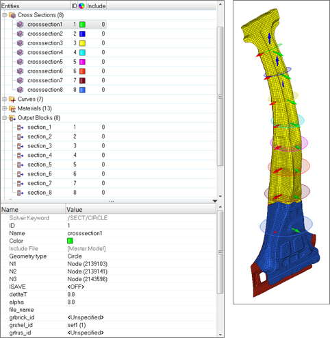

Radioss Cards
| Card | Description |
| /SECT | A section is a set of nodes and a set of
elements. 注: Block Format
Keyword
| /SECT/CIRCLE | A section is a set of nodes and a set of elements.
Sets are built automatically, by intersecting the concerned groups of elements with
a disc. 注: Block Format
Keyword
| /SECT/PARAL | A section is a set of nodes and a set of elements.
a parallelogram. 注: Block Format
Keyword
Create Cross Sections
Create cross sections using the Cross Section Assistant.
![]() 図 1. Radioss Cross Section |
