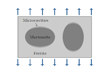

    • Void nucleation (creation of microcavities), decreasing at low triaxiality.(2)
      d f n = { A s   d ε p ,     ε p ε n     and     τ 0 A s   ( 1 + 3 τ ) d ε p ,   ε p ε n     and   1 3 τ < 0 0 ,   ε p < ε n     and     τ <   1 3 MathType@MTEF@5@5@+= feaagKart1ev2aaatCvAUfeBSjuyZL2yd9gzLbvyNv2CaerbuLwBLn hiov2DGi1BTfMBaeXatLxBI9gBaerbd9wDYLwzYbItLDharqqtubsr 4rNCHbGeaGqiVCI8FfYJH8YrFfeuY=Hhbbf9v8qqaqFr0xc9pk0xbb a9q8WqFfeaY=biLkVcLq=JHqpepeea0=as0Fb9pgeaYRXxe9vr0=vr 0=vqpWqaaeaabiGaciaacaqabeaadaqaaqaaaOqaaabaaaaaaaaape GaamizaiaadAgapaWaaSbaaSqaa8qacaWGUbaapaqabaGcpeGaeyyp a0Zaaiqaa8aabaqbaeqabmqaaaqaa8qacaWGbbWdamaaBaaaleaape Gaam4CaaWdaeqaaOWdbiaacckacaWGKbGaeqyTdu2damaaBaaaleaa peGaamiCaaWdaeqaaOWdbiaacYcacaGGGcGaaeiiaiabew7aL9aada WgaaWcbaWdbiaadchaa8aabeaak8qacqGHLjYScqaH1oqzpaWaaSba aSqaa8qacaWGUbaapaqabaGcpeGaaiiOaiaacckacaqGHbGaaeOBai aabsgacaGGGcGaaiiOaiabes8a0jabgwMiZkaaicdaa8aabaWdbiaa dgeapaWaaSbaaSqaa8qacaWGZbaapaqabaGcpeGaaiiOamaabmaapa qaa8qacaaIXaGaey4kaSIaaG4maiabes8a0bGaayjkaiaawMcaaiaa dsgacqaH1oqzpaWaaSbaaSqaa8qacaWGWbaapaqabaGcpeGaaiilai aabccacqaH1oqzpaWaaSbaaSqaa8qacaWGWbaapaqabaGcpeGaeyyz ImRaeqyTdu2damaaBaaaleaapeGaamOBaaWdaeqaaOWdbiaacckaca GGGcGaaeyyaiaab6gacaqGKbGaaiiOaiabgkHiTmaalaaapaqaa8qa caaIXaaapaqaa8qacaaIZaaaaiabgsMiJkabes8a0jabgYda8iaaic daa8aabaWdbiaaicdacaGGSaGaaeiiaiabew7aL9aadaWgaaWcbaWd biaadchaa8aabeaak8qacqGH8aapcqaH1oqzpaWaaSbaaSqaa8qaca WGUbaapaqabaGcpeGaaiiOaiaacckacaqGHbGaaeOBaiaabsgacaGG GcGaaiiOaiabes8a0jabgYda8iaacckacqGHsisldaWcaaWdaeaape GaaGymaaWdaeaapeGaaG4maaaaaaaacaGL7baaaaa@9488@
      Where, τ is the stress triaxiality defined as:(3)
      τ =   T r ( σ ) 3   σ e q MathType@MTEF@5@5@+= feaagKart1ev2aqatCvAUfeBSjuyZL2yd9gzLbvyNv2CaerbuLwBLn hiov2DGi1BTfMBaeXatLxBI9gBaerbd9wDYLwzYbItLDharqqtubsr 4rNCHbGeaGqiVCI8FfYJH8YrFfeuY=Hhbbf9v8qqaqFr0xc9pk0xbb a9q8WqFfeaY=biLkVcLq=JHqpepeea0=as0Fb9pgeaYRXxe9vr0=vr 0=vqpWqaaeaabiGaciaacaqabeaadaqaaqaaaOqaaabaaaaaaaaape GaeqiXdqNaeyypa0JaaiiOamaalaaapaqaa8qacaWGubGaamOCamaa bmaapaqaaGqad8qacaWFdpaacaGLOaGaayzkaaaapaqaa8qacaaIZa GaaiiOaiabeo8aZ9aadaWgaaWcbaWdbiaadwgacaWGXbaapaqabaaa aaaa@44F2@
      Figure 1. Nucleation of cavities

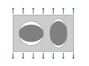

    • Void growth at high triaxiality:(4)
      d f g = ( 1 f t )   T r ( ε p ) MathType@MTEF@5@5@+= feaagKart1ev2aqatCvAUfeBSjuyZL2yd9gzLbvyNv2CaerbuLwBLn hiov2DGi1BTfMBaeXatLxBI9gBaerbd9wDYLwzYbItLDharqqtubsr 4rNCHbGeaGqiVCI8FfYJH8YrFfeuY=Hhbbf9v8qqaqFr0xc9pk0xbb a9q8WqFfeaY=biLkVcLq=JHqpepeea0=as0Fb9pgeaYRXxe9vr0=vr 0=vqpWqaaeaabiGaciaacaqabeaadaqaaqaaaOqaaabaaaaaaaaape GaamizaiaadAgapaWaaSbaaSqaa8qacaWGNbaapaqabaGcpeGaeyyp a0ZaaeWaa8aabaWdbiaaigdacqGHsislcaWGMbWdamaaBaaaleaape GaamiDaaWdaeqaaaGcpeGaayjkaiaawMcaaiaacckacaWGubGaamOC amaabmaapaqaaGqad8qacaWF1oWdamaaBaaaleaapeGaamiCaaWdae qaaaGcpeGaayjkaiaawMcaaaaa@4738@
      Figure 2. Growth of cavities at high triaxiality

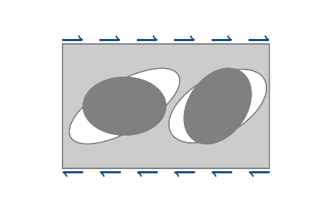

    • Additional shear void growth at low triaxiality which is shear dominated: (5)
      d f s h = K w f t   w ( θ )   S   : ε p σ e q MathType@MTEF@5@5@+= feaagKart1ev2aqatCvAUfeBSjuyZL2yd9gzLbvyNv2CaerbuLwBLn hiov2DGi1BTfMBaeXatLxBI9gBaerbd9wDYLwzYbItLDharqqtubsr 4rNCHbGeaGqiVCI8FfYJH8YrFfeuY=Hhbbf9v8qqaqFr0xc9pk0xbb a9q8WqFfeaY=biLkVcLq=JHqpepeea0=as0Fb9pgeaYRXxe9vr0=vr 0=vqpWqaaeaabiGaciaacaqabeaadaqaaqaaaOqaaabaaaaaaaaape GaamizaiaadAgapaWaaSbaaSqaa8qacaWGZbGaamiAaaWdaeqaaOWd biabg2da9iaadUeapaWaaSbaaSqaa8qacaWG3baapaqabaGcpeGaam Oza8aadaWgaaWcbaWdbiaadshaa8aabeaak8qacaGGGcGaam4Damaa bmaapaqaa8qacqaH4oqCaiaawIcacaGLPaaacaGGGcWaaSaaa8aaba acbmWdbiaa=nfacaWFGcGaaiOoaiaa=v7apaWaaSbaaSqaa8qacaWG WbaapaqabaaakeaapeGaeq4Wdm3damaaBaaaleaapeGaamyzaiaadg haa8aabeaaaaaaaa@5006@
      Where, w ( θ ) MathType@MTEF@5@5@+= feaagKart1ev2aqatCvAUfeBSjuyZL2yd9gzLbvyNv2CaerbuLwBLn hiov2DGi1BTfMBaeXatLxBI9gBaerbd9wDYLwzYbItLDharqqtubsr 4rNCHbGeaGqiVCI8FfYJH8YrFfeuY=Hhbbf9v8qqaqFr0xc9pk0xbb a9q8WqFfeaY=biLkVcLq=JHqpepeea0=as0Fb9pgeaYRXxe9vr0=vr 0=vqpWqaaeaabiGaciaacaqabeaadaqaaqaaaOqaaabaaaaaaaaape Gaam4Damaabmaapaqaa8qacqaH4oqCaiaawIcacaGLPaaaaaa@3A66@ is a weight function depending on the Lode angle: (6)
      w ( θ ) = 1 ( cos ( 3 θ ) ) 2 MathType@MTEF@5@5@+= feaagKart1ev2aqatCvAUfeBSjuyZL2yd9gzLbvyNv2CaerbuLwBLn hiov2DGi1BTfMBaeXatLxBI9gBaerbd9wDYLwzYbItLDharqqtubsr 4rNCHbGeaGqiVCI8FfYJH8YrFfeuY=Hhbbf9v8qqaqFr0xc9pk0xbb a9q8WqFfeaY=biLkVcLq=JHqpepeea0=as0Fb9pgeaYRXxe9vr0=vr 0=vqpWqaaeaabiGaciaacaqabeaadaqaaqaaaOqaaabaaaaaaaaape Gaam4Damaabmaapaqaa8qacqaH4oqCaiaawIcacaGLPaaacqGH9aqp caaIXaGaeyOeI0YaaeWaa8aabaWdbiaabogacaqGVbGaae4Camaabm aapaqaa8qacaaIZaGaeqiUdehacaGLOaGaayzkaaaacaGLOaGaayzk aaWdamaaCaaaleqabaWdbiaaikdaaaaaaa@46AD@
      Figure 3. Growth of cavities at low triaxiality

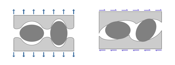

      To represent the cavities coalescence when a critical void volume fraction f c MathType@MTEF@5@5@+= feaagKart1ev2aqatCvAUfeBSjuyZL2yd9gzLbvyNv2CaerbuLwBLn hiov2DGi1BTfMBaeXatLxBI9gBaerbd9wDYLwzYbItLDharqqtubsr 4rNCHbGeaGqiVCI8FfYJH8YrFfeuY=Hhbbf9v8qqaqFr0xc9pk0xbb a9q8WqFfeaY=biLkVcLq=JHqpepeea0=as0Fb9pgeaYRXxe9vr0=vr 0=vqpWqaaeaabiGaciaacaqabeaadaqaaqaaaOqaaabaaaaaaaaape GaamOza8aadaWgaaWcbaWdbiaadogaa8aabeaaaaa@3839@ is reached by f t MathType@MTEF@5@5@+= feaagKart1ev2aqatCvAUfeBSjuyZL2yd9gzLbvyNv2CaerbuLwBLn hiov2DGi1BTfMBaeXatLxBI9gBaerbd9wDYLwzYbItLDharqqtubsr 4rNCHbGeaGqiVCI8FfYJH8YrFfeuY=Hhbbf9v8qqaqFr0xc9pk0xbb a9q8WqFfeaY=biLkVcLq=JHqpepeea0=as0Fb9pgeaYRXxe9vr0=vr 0=vqpWqaaeaabiGaciaacaqabeaadaqaaqaaaOqaaabaaaaaaaaape GaamOza8aadaWgaaWcbaWdbiaadogaa8aabeaaaaa@3839@ , the effective damage (which has an influence on the stress computation) f * MathType@MTEF@5@5@+= feaagKart1ev2aqatCvAUfeBSjuyZL2yd9gzLbvyNv2CaerbuLwBLn hiov2DGi1BTfMBaeXatLxBI9gBaerbd9wDYLwzYbItLDharqqtubsr 4rNCHbGeaGqiVCI8FfYJH8YrFfeuY=Hhbbf9v8qqaqFr0xc9pk0xbb a9q8WqFfeaY=biLkVcLq=JHqpepeea0=as0Fb9pgeaYRXxe9vr0=vr 0=vqpWqaaeaabiGaciaacaqabeaadaqaaqaaaOqaaabaaaaaaaaape GaamOza8aadaahaaWcbeqaa8qacaGGQaaaaaaa@37F1@ is introduced in the model and its expression depends on f t   MathType@MTEF@5@5@+= feaagKart1ev2aqatCvAUfeBSjuyZL2yd9gzLbvyNv2CaerbuLwBLn hiov2DGi1BTfMBaeXatLxBI9gBaerbd9wDYLwzYbItLDharqqtubsr 4rNCHbGeaGqiVCI8FfYJH8YrFfeuY=Hhbbf9v8qqaqFr0xc9pk0xbb a9q8WqFfeaY=biLkVcLq=JHqpepeea0=as0Fb9pgeaYRXxe9vr0=vr 0=vqpWqaaeaabiGaciaacaqabeaadaqaaqaaaOqaaabaaaaaaaaape GaamOza8aadaWgaaWcbaWdbiaadshaa8aabeaak8qacaGGGcaaaa@3988@ : (7)
      f * = f ( f t ) = { f t ,     f t < f c f c + ( 1 q 1 f c ) ( f t f c ) ( f R f c ) ,     f t f c MathType@MTEF@5@5@+= feaagKart1ev2aqatCvAUfeBSjuyZL2yd9gzLbvyNv2CaerbuLwBLn hiov2DGi1BTfMBaeXatLxBI9gBaerbd9wDYLwzYbItLDharqqtubsr 4rNCHbGeaGqiVCI8FfYJH8YrFfeuY=Hhbbf9v8qqaqFr0xc9pk0xbb a9q8WqFfeaY=biLkVcLq=JHqpepeea0=as0Fb9pgeaYRXxe9vr0=vr 0=vqpWqaaeaabiGaciaacaqabeaadaqaaqaaaOqaaabaaaaaaaaape GaamOza8aadaahaaWcbeqaa8qacaGGQaaaaOGaeyypa0JaamOzamaa bmaapaqaa8qacaWGMbWdamaaBaaaleaapeGaamiDaaWdaeqaaaGcpe GaayjkaiaawMcaaiabg2da9maaceaapaqaauaabeqaceaaaeaapeGa amOza8aadaWgaaWcbaWdbiaadshaa8aabeaak8qacaGGSaGaaiiOai aacckacaWGMbWdamaaBaaaleaapeGaamiDaaWdaeqaaOWdbiabgYda 8iaadAgapaWaaSbaaSqaa8qacaWGJbaapaqabaaakeaapeGaamOza8 aadaWgaaWcbaWdbiaadogaa8aabeaak8qacqGHRaWkdaqadaWdaeaa peWaaSGaa8aabaWdbiaaigdaa8aabaWdbiaadghapaWaaSbaaSqaa8 qacaaIXaaapaqabaaaaOWdbiabgkHiTiaadAgapaWaaSbaaSqaa8qa caWGJbaapaqabaaak8qacaGLOaGaayzkaaWaaSaaa8aabaWdbmaabm aapaqaa8qacaWGMbWdamaaBaaaleaapeGaamiDaaWdaeqaaOWdbiab gkHiTiaadAgapaWaaSbaaSqaa8qacaWGJbaapaqabaaak8qacaGLOa Gaayzkaaaapaqaa8qadaqadaWdaeaapeGaamOza8aadaWgaaWcbaWd biaadkfaa8aabeaak8qacqGHsislcaWGMbWdamaaBaaaleaapeGaam 4yaaWdaeqaaaGcpeGaayjkaiaawMcaaaaacaGGSaGaaiiOaiaaccka caWGMbWdamaaBaaaleaapeGaamiDaaWdaeqaaOWdbiabgwMiZkaadA gapaWaaSbaaSqaa8qacaWGJbaapaqabaaaaaGcpeGaay5Eaaaaaa@6E51@
      Where, f R MathType@MTEF@5@5@+= feaagKart1ev2aqatCvAUfeBSjuyZL2yd9gzLbvyNv2CaerbuLwBLn hiov2DGi1BTfMBaeXatLxBI9gBaerbd9wDYLwzYbItLDharqqtubsr 4rNCHbGeaGqiVCI8FfYJH8YrFfeuY=Hhbbf9v8qqaqFr0xc9pk0xbb a9q8WqFfeaY=biLkVcLq=JHqpepeea0=as0Fb9pgeaYRXxe9vr0=vr 0=vqpWqaaeaabiGaciaacaqabeaadaqaaqaaaOqaaabaaaaaaaaape GaamOza8aadaWgaaWcbaWdbiaadkfaa8aabeaaaaa@3828@ is the total void volume fraction at rupture for which f * = 1 / q 1 MathType@MTEF@5@5@+= feaagKart1ev2aqatCvAUfeBSjuyZL2yd9gzLbvyNv2CaerbuLwBLn hiov2DGi1BTfMBaeXatLxBI9gBaerbd9wDYLwzYbItLDharqqtubsr 4rNCHbGeaGqiVCI8FfYJH8YrFfeuY=Hhbbf9v8qqaqFr0xc9pk0xbb a9q8WqFfeaY=biLkVcLq=JHqpepeea0=as0Fb9pgeaYRXxe9vr0=vr 0=vqpWqaaeaabiGaciaacaqabeaadaqaaqaaaOqaaabaaaaaaaaape GaamOza8aadaahaaWcbeqaa8qacaGGQaaaaOGaeyypa0JaaGymaiaa c+cacaWGXbWdamaaBaaaleaapeGaaGymaaWdaeqaaaaa@3C7A@ .
      Figure 4. Coalescence of cavities

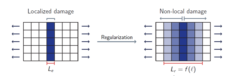

  2. By default I l o c = 1 MathType@MTEF@5@5@+= feaagKart1ev2aqatCvAUfeBSjuyZL2yd9gzLbvyNv2CaerbuLwBLn hiov2DGi1BTfMBaeXatLxBI9gBaerbd9wDYLwzYbItLDharqqtubsr 4rNCHbGeaGqiVCI8FfYJH8YrFfeuY=Hhbbf9v8qqaqFr0xc9pk0xbb a9q8WqFfeaY=biLkVcLq=JHqpepeea0=as0Fb9pgeaYRXxe9vr0=vr 0=vqpWqaaeaabiGaciaacaqabeaadaqaaqaaaOqaaabaaaaaaaaape Gaamysa8aadaWgaaWcbaWdbiaadYgacaWGVbGaam4yaaWdaeqaaOWd biabg2da9iaaigdaaaa@3BDC@ , the damage variable is calculated step by step using the local plastic strain values at each integration point. However, one may want to use non-local regularization which offers mesh size and the mesh orientation independent results (mesh convergence) for all meshes using the mesh size L e MathType@MTEF@5@5@+= feaagKart1ev2aqatCvAUfeBSjuyZL2yd9gzLbvyNv2CaerbuLwBLn hiov2DGi1BTfMBaeXatLxBI9gBaerbd9wDYLwzYbItLDharqqtubsr 4rNCHbGeaGqiVCI8FfYJH8YrFfeuY=Hhbbf9v8qqaqFr0xc9pk0xbb a9q8WqFfeaY=biLkVcLq=JHqpepeea0=as0Fb9pgeaYRXxe9vr0=vr 0=vqpWqaaeaabiGaciaacaqabeaadaqaaqaaaOqaaabaaaaaaaaape Gaamita8aadaWgaaWcbaWdbiaadwgaa8aabeaaaaa@3821@ less than equal to the maximum value set by you L e L e m a x MathType@MTEF@5@5@+= feaagKart1ev2aqatCvAUfeBSjuyZL2yd9gzLbvyNv2CaerbuLwBLn hiov2DGi1BTfMBaeXatLxBI9gBaerbd9wDYLwzYbItLDharqqtubsr 4rNCHbGeaGqiVCI8FfYJH8YrFfeuY=Hhbbf9v8qqaqFr0xc9pk0xbb a9q8WqFfeaY=biLkVcLq=JHqpepeea0=as0Fb9pgeaYRXxe9vr0=vr 0=vqpWqaaeaabiGaciaacaqabeaadaqaaqaaaOqaaabaaaaaaaaape Gaamita8aadaWgaaWcbaWdbiaadwgaa8aabeaak8qacqGHKjYOcaWG mbWdamaaDaaaleaapeGaamyzaaWdaeaapeGaamyBaiaadggacaWG4b aaaaaa@3EEB@ . This maximum mesh size L e m a x MathType@MTEF@5@5@+= feaagKart1ev2aqatCvAUfeBSjuyZL2yd9gzLbvyNv2CaerbuLwBLn hiov2DGi1BTfMBaeXatLxBI9gBaerbd9wDYLwzYbItLDharqqtubsr 4rNCHbGeaGqiVCI8FfYJH8YrFfeuY=Hhbbf9v8qqaqFr0xc9pk0xbb a9q8WqFfeaY=biLkVcLq=JHqpepeea0=as0Fb9pgeaYRXxe9vr0=vr 0=vqpWqaaeaabiGaciaacaqabeaadaqaaqaaaOqaaabaaaaaaaaape Gaamita8aadaqhaaWcbaWdbiaadwgaa8aabaWdbiaad2gacaWGHbGa amiEaaaaaaa@3B07@ is then the highest mesh size used for which results are mesh convergent.
    If one of the non-local formulations is used, ( I l o c > 1 ) MathType@MTEF@5@5@+= feaagKart1ev2aqatCvAUfeBSjuyZL2yd9gzLbvyNv2CaerbuLwBLn hiov2DGi1BTfMBaeXatLxBI9gBaerbd9wDYLwzYbItLDharqqtubsr 4rNCHbGeaGqiVCI8FfYJH8YrFfeuY=Hhbbf9v8qqaqFr0xc9pk0xbb a9q8WqFfeaY=biLkVcLq=JHqpepeea0=as0Fb9pgeaYRXxe9vr0=vr 0=vqpWqaaeaabiGaciaacaqabeaadaqaaqaaaOqaaabaaaaaaaaape GaaiikaiaadMeapaWaaSbaaSqaa8qacaWGSbGaam4Baiaadogaa8aa beaak8qacqGH+aGpcaaIXaGaaiykaaaa@3D37@ , the damage increments depend on a regularized nodal “non-local” plastic strain calculated on the entire mesh. The non-local plastic strain at nodes denoted ε p n l MathType@MTEF@5@5@+= feaagKart1ev2aqatCvAUfeBSjuyZL2yd9gzLbvyNv2CaerbuLwBLn hiov2DGi1BTfMBaeXatLxBI9gBaerbd9wDYLwzYbItLDharqqtubsr 4rNCHbGeaGqiVCI8FfYJH8YrFfeuY=Hhbbf9v8qqaqFr0xc9pk0xbb a9q8WqFfeaY=biLkVcLq=JHqpepeea0=as0Fb9pgeaYRXxe9vr0=vr 0=vqpWqaaeaabiGaciaacaqabeaadaqaaqaaaOqaaabaaaaaaaaape GaeqyTdu2damaaDaaaleaapeGaamiCaaWdaeaapeGaamOBaiaadYga aaaaaa@3AF7@ is computed accounting for its own gradient and its local counterpart ε p computed at the Gauss points following the set of equations: (10)
        R l e n 2     Δ ε p n l     γ   ε p n l ˙   +   ( ε p ε p n l ) =   ζ ε p n l ¨       ε p n l   .   n = 0   o n o n         Ω Γ MathType@MTEF@5@5@+= feaagKart1ev2aqatCvAUfeBSjuyZL2yd9gzLbvyNv2CaerbuLwBLn hiov2DGi1BTfMBaeXatLxBI9gBaerbd9wDYLwzYbItLDharqqtubsr 4rNCHbGeaGqiVCI8FfYJH8YrFfeuY=Hhbbf9v8qqaqFr0xc9pk0xbb a9q8WqFfeaY=biLkVcLq=JHqpepeea0=as0Fb9pgeaYRXxe9vr0=vr 0=vqpWqaaeaabiGaciaacaqabeaadaqaaqaaaOqaauaabeqaceaaae aaqaaaaaaaaaWdbiaacckacaGGGcGaamOua8aadaqhaaWcbaWdbiaa dYgacaWGLbGaamOBaaWdaeaapeGaaGOmaaaakiaacckacaGGGcGaeu iLdqKaeqyTdu2damaaDaaaleaapeGaamiCaaWdaeaapeGaamOBaiaa dYgaaaGccaGGGcGaeyOeI0IaaiiOaiabeo7aNjaacckapaWaaCbiae aapeGaeqyTdu2damaaDaaaleaapeGaamiCaaWdaeaapeGaamOBaiaa dYgaaaaapaqabeaapeGaaiy2caaakiaacckacqGHRaWkcaGGGcWaae Waa8aabaWdbiabew7aL9aadaWgaaWcbaWdbiaadchaa8aabeaak8qa cqGHsislcqaH1oqzpaWaa0baaSqaa8qacaWGWbaapaqaa8qacaWGUb GaamiBaaaaaOGaayjkaiaawMcaaiabg2da9iaacckacqaH2oGEpaWa aCbiaeaapeGaeqyTdu2damaaDaaaleaapeGaamiCaaWdaeaapeGaam OBaiaadYgaaaaapaqabeaapeGaaiiQaaaakiaacckacaGGGcaapaqa a8qacuGHhis0paGbaSaapeGaaiiOaiabew7aL9aadaqhaaWcbaWdbi aadchaa8aabaWdbiaad6gacaWGSbaaaOGaaiiOaiaac6cacaGGGcGa bmOBa8aagaWca8qacqGH9aqpcaaIWaaaaiaacckapaqbaeqabiqaaa qaa8qacaWGVbGaamOBaaWdaeaapeGaam4Baiaad6gaaaGaaiiOaiaa cckacaGGGcGaaiiOa8aafaqabeGabaaabaWdbiabfM6axbWdaeaape Gaeu4KdCeaaaaa@8815@
    The parameters γ and ζ MathType@MTEF@5@5@+= feaagKart1ev2aqatCvAUfeBSjuyZL2yd9gzLbvyNv2CaerbuLwBLn hiov2DGi1BTfMBaeXatLxBI9gBaerbd9wDYLwzYbItLDharqqtubsr 4rNCHbGeaGqiVCI8FfYJH8YrFfeuY=Hhbbf9v8qqaqFr0xc9pk0xbb a9q8WqFfeaY=biLkVcLq=JHqpepeea0=as0Fb9pgeaYRXxe9vr0=vr 0=vqpWqaaeaabiGaciaacaqabeaadaqaaqaaaOqaaabaaaaaaaaape GaeqOTdOhaaa@37C9@ are automatically set. You have to set the parameter Rlen (or L e M A X MathType@MTEF@5@5@+= feaagKart1ev2aqatCvAUfeBSjuyZL2yd9gzLbvyNv2CaerbuLwBLn hiov2DGi1BTfMBaeXatLxBI9gBaerbd9wDYLwzYbItLDharqqtubsr 4rNCHbGeaGqiVCI8FfYJH8YrFfeuY=Hhbbf9v8qqaqFr0xc9pk0xbb a9q8WqFfeaY=biLkVcLq=JHqpepeea0=as0Fb9pgeaYRXxe9vr0=vr 0=vqpWqaaeaabiGaciaacaqabeaadaqaaqaaaOqaaiaadYeadaqhaa WcbaGaamyzaaqaaiaad2eacaWGbbGaamiwaaaaaaa@3A49@ - Comment 5) which defines a non-local “internal length” which corresponds to a radius of influence in the non-local variable computation. This defines the size of the non-local regularization band L r = f ( R l e n ) MathType@MTEF@5@5@+= feaagKart1ev2aqatCvAUfeBSjuyZL2yd9gzLbvyNv2CaerbuLwBLn hiov2DGi1BTfMBaeXatLxBI9gBaerbd9wDYLwzYbItLDharqqtubsr 4rNCHbGeaGqiVCI8FfYJH8YrFfeuY=Hhbbf9v8qqaqFr0xc9pk0xbb a9q8WqFfeaY=biLkVcLq=JHqpepeea0=as0Fb9pgeaYRXxe9vr0=vr 0=vqpWqaaeaabiGaciaacaqabeaadaqaaqaaaOqaaabaaaaaaaaape Gaamita8aadaWgaaWcbaWdbiaadkhaa8aabeaak8qacqGH9aqpcaWG MbWaaeWaa8aabaWdbiaadkfapaWaaSbaaSqaa8qacaWGSbGaamyzai aad6gaa8aabeaaaOWdbiaawIcacaGLPaaaaaa@3FFA@ (Figure 5).
    Figure 5. Non-local regularization principle

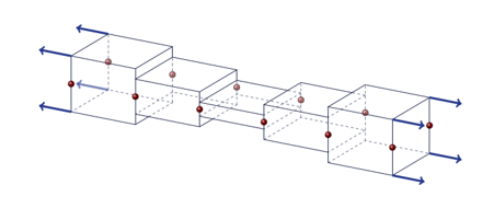

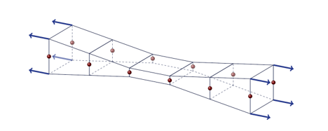

  6. When a non-local regularization is used for shell elements, an additional regularization is made on the thickness variation computation avoiding an additional localization issue. In the common local case (Figure 6), the compatibility of thickness between shell elements is not ensured due to the lack of kinematic equations in the z-direction, and the thickness variation is locally computed at Gauss points. By introducing the non-local plastic strain in the “in-thickness” strain increment, the compatibility is restored, (Figure 7). (15)
    Δ ε z z = ν 1 ν   ( Δ ε x x   Δ λ n l   n x x + Δ ε y y   Δ λ n l   n y y ) +   Δ λ n l   n z z MathType@MTEF@5@5@+= feaagKart1ev2aqatCvAUfeBSjuyZL2yd9gzLbvyNv2CaerbuLwBLn hiov2DGi1BTfMBaeXatLxBI9gBaerbd9wDYLwzYbItLDharqqtubsr 4rNCHbGeaGqiVCI8FfYJH8YrFfeuY=Hhbbf9v8qqaqFr0xc9pk0xbb a9q8WqFfeaY=biLkVcLq=JHqpepeea0=as0Fb9pgeaYRXxe9vr0=vr 0=vqpWqaaeaabiGaciaacaqabeaadaqaaqaaaOqaaabaaaaaaaaape GaaeiLdiabew7aL9aadaWgaaWcbaWdbiaadQhacaWG6baapaqabaGc peGaeyypa0JaeyOeI0YaaSaaa8aabaWdbiabe27aUbWdaeaapeGaaG ymaiabgkHiTiabe27aUbaacaGGGcWaaeWaa8aabaWdbiabfs5aejab ew7aL9aadaWgaaWcbaWdbiaadIhacaWG4baapaqabaGcpeGaaiiOai abgkHiTiabfs5aejabeU7aS9aadaWgaaWcbaWdbiaad6gacaWGSbaa paqabaGcpeGaaiiOaiaad6gapaWaaSbaaSqaa8qacaWG4bGaamiEaa WdaeqaaOWdbiabgUcaRiabfs5aejabew7aL9aadaWgaaWcbaWdbiaa dMhacaWG5baapaqabaGcpeGaaiiOaiabgkHiTiabfs5aejabeU7aS9 aadaWgaaWcbaWdbiaad6gacaWGSbaapaqabaGcpeGaaiiOaiaad6ga paWaaSbaaSqaa8qacaWG5bGaamyEaaWdaeqaaaGcpeGaayjkaiaawM caaiabgUcaRiaacckacqqHuoarcqaH7oaBpaWaaSbaaSqaa8qacaWG UbGaamiBaaWdaeqaaOWdbiaacckacaWGUbWdamaaBaaaleaapeGaam OEaiaadQhaa8aabeaaaaa@7537@
    Where, Δ λ n l = f ( ε p n l ) MathType@MTEF@5@5@+= feaagKart1ev2aqatCvAUfeBSjuyZL2yd9gzLbvyNv2CaerbuLwBLn hiov2DGi1BTfMBaeXatLxBI9gBaerbd9wDYLwzYbItLDharqqtubsr 4rNCHbGeaGqiVCI8FfYJH8YrFfeuY=Hhbbf9v8qqaqFr0xc9pk0xbb a9q8WqFfeaY=biLkVcLq=JHqpepeea0=as0Fb9pgeaYRXxe9vr0=vr 0=vqpWqaaeaabiGaciaacaqabeaadaqaaqaaaOqaaabaaaaaaaaape GaaeiLdiabeU7aS9aadaWgaaWcbaWdbiaad6gacaWGSbaapaqabaGc peGaeyypa0JaamOzamaabmaapaqaa8qacqaH1oqzpaWaa0baaSqaa8 qacaWGWbaapaqaa8qacaWGUbGaamiBaaaaaOGaayjkaiaawMcaaaaa @43C0@ is the non-local plastic multiplier.
    Figure 6. Transverse strain incompatibility (local)
    Figure 7. Transverse strain compatibility (non-local)
    Note: This last point implies that the identified parameters can be used on solid and shells, as results will be identical within the same range of stress triaxiality 2 3 η 2 3 MathType@MTEF@5@5@+= feaagKart1ev2aqatCvAUfeBSjuyZL2yd9gzLbvyNv2CaerbuLwBLn hiov2DGi1BTfMBaeXatLxBI9gBaerbd9wDYLwzYbItLDharqqtubsr 4rNCHbGeaGqiVu0Je9sqqrpepC0xbbL8F4rqqrFfpeea0xe9Lq=Jc9 vqaqpepm0xbba9pwe9Q8fs0=yqaqpepae9pg0FirpepeKkFr0xfr=x fr=xb9adbaqaaeGaciGaaiaabeqaamaabaabaaGcbaGaeyOeI0YaaS GaaeaacaaIYaaabaGaaG4maaaacqGHKjYOcqaH3oaAcqGHKjYOdaWc caqaaiaaikdaaeaacaaIZaaaaaaa@3F10@ .
