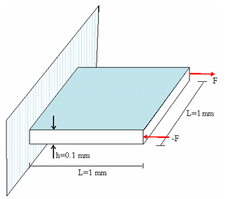

This example concerns the in-plane traction-comparison problem of an embedded plate subjected to two concentrated loads, as shown in Figure 2.
This example illustrates the role of the different shell element formulations with regard to the mesh.

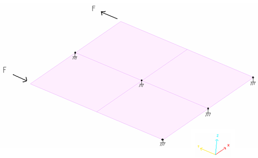

- Boundary conditions (/BCS)
The boundary conditions are such that the three nodes of a single side and the two middle ones are blocked, whereas the others are free with respect to the Y axis.
- Concentrated loads (/CLOAD)Two concentrated loads are applied on the corner points on opposing sides. They increase over time, as defined by the following function:
F(t) 0 10 10 t 0 200 400
Figure 1. Boundary Conditions and Loads

Model Description
Units: mm, ms, g, N, MPa
- Material Properties
- Value
- Initial density
- 7.8x10-3
- Young's modulus
- 210000
- Poisson ratio
- 0.3
Figure 2. Geometry of the Problem

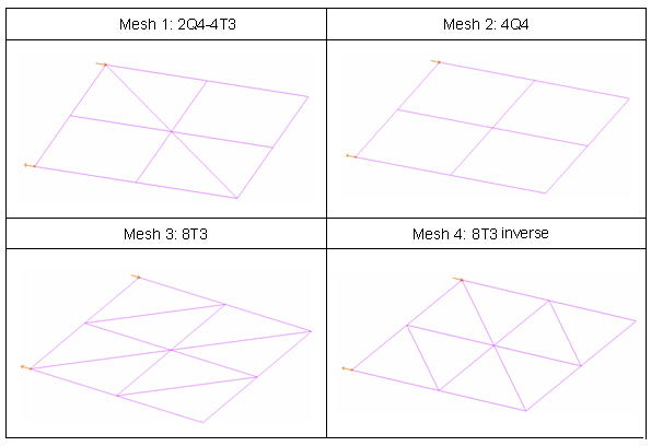

Model Method
- Mesh 1
- Two quadrilateral shells and four triangular shells (2Q4-4T3)
- Mesh 2
- Four quadrilateral shells (4Q4)
- Mesh 3
- Eight triangular shells (8T3)
- Mesh 4
- Eight triangular shells (8T3 inverse)
- QBAT formulation (Ishell =12)
- QEPH formulation (Ishell =24)
- Belytshcko & Tsay formulation (Ishell =1 or 3, hourglass control TYPE1, TYPE3)
- C0 and DKT18 formulations
Figure 3. Square Plate Meshes

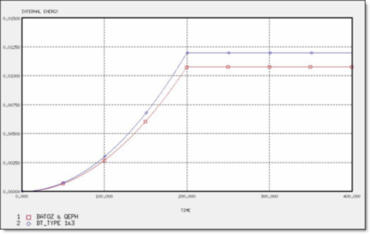

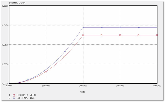

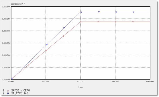

Energy Curves / Comparison for Element Formulations
Figure 4. Internal Energy for 2 x Q4 and 4 x T3 Elements
Figure 5. Y Displacement for 2 x Q4 and 4 x T3 Elements
Figure 6. Internal Energy for 4 x Q4 Elements

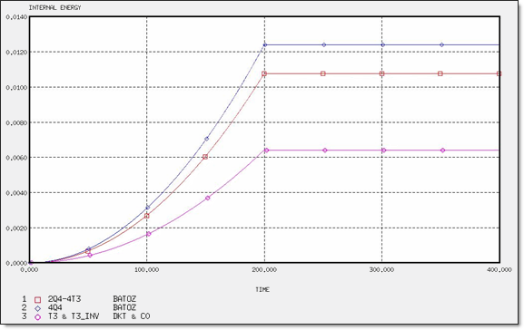

Energy Curves / Comparison for Mesh Definitions
Figure 7. Internal Energy for Different Meshes

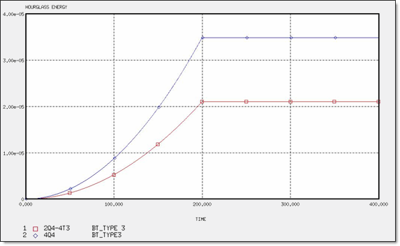

Figure 8. Hourglass Energy for Different Meshes
| Elastic Plate | 2Q4-4T3 | 4Q4 | 8T3 | 8T3_INV | ||||||
| QEPH | BT_TYPE 1 and 3 | BATOZ | QEPH | BT_TYPE 1 and 3 | BATOZ | DKT | CO | DKT | CO | |
| IEmax | 1.07 x 10-2 | 1.19 x 10-2 | 1.07 x 10-2 | 1.24 x 10-2 | 1.44 x 10-2 | 1.24 x 10-2 | 6.42 x 10-3 | 6.42 x 10-3 | 6.42 x 10-3 | 6.42 x 10-3 |
| HEmax | --- | 2.10 x 10-5 | -- | -- | 3.49 x 10-6 | -- | -- | -- | -- | -- |
| Dymax | 1.18 x 10-3 (Traction) | 1.38 x 10-3 (Traction) | 1.18 x 10-3 (Traction) | 1.24 x 10-3 | 1.44 x 10-3 | 1.24 x 10-3 | 6.42 x 10-3 | 6.42 x 10-3 | 6.42 x 10-3 | 6.42 x 10-3 |

- The quadrilateral shell elements QEPH and QBAT have the same in-plane behavior.
- The different types of hourglass formulations in the BT shell elements lead to the same results, as there is no out-of-plane deformation and the material is supposed to be elastic.
- The three in-plane behaviors of the DKT18 and T3C0 Radioss triangles are exactly the same, as both of the elements are used for the same membrane formulation.
- The triangles are stiffer than the quadrilateral elements and do not provide good results, especially when the mesh is coarse.
