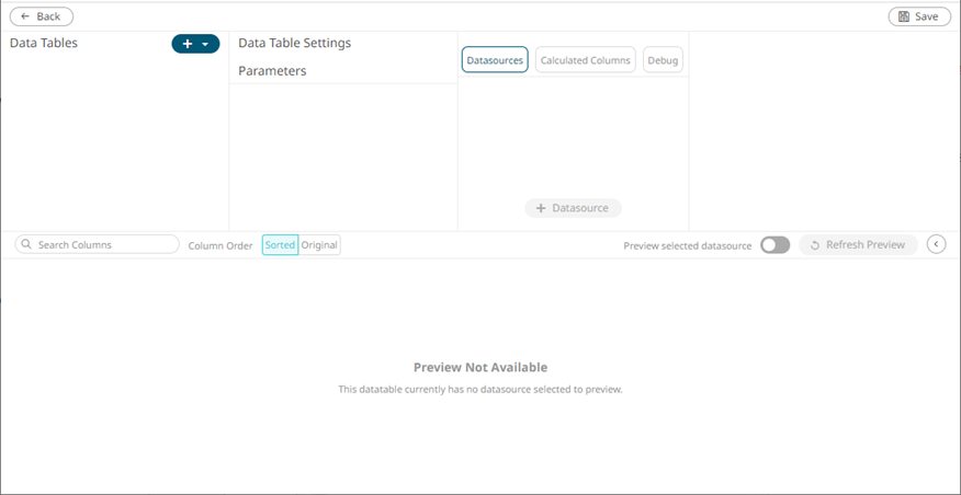

1.     On the Data Table pane, click
The Workbook Internal Data Table Editor view displays.
2.    On
	 the Data Tables pane, click
 and
	 select New Data Table:

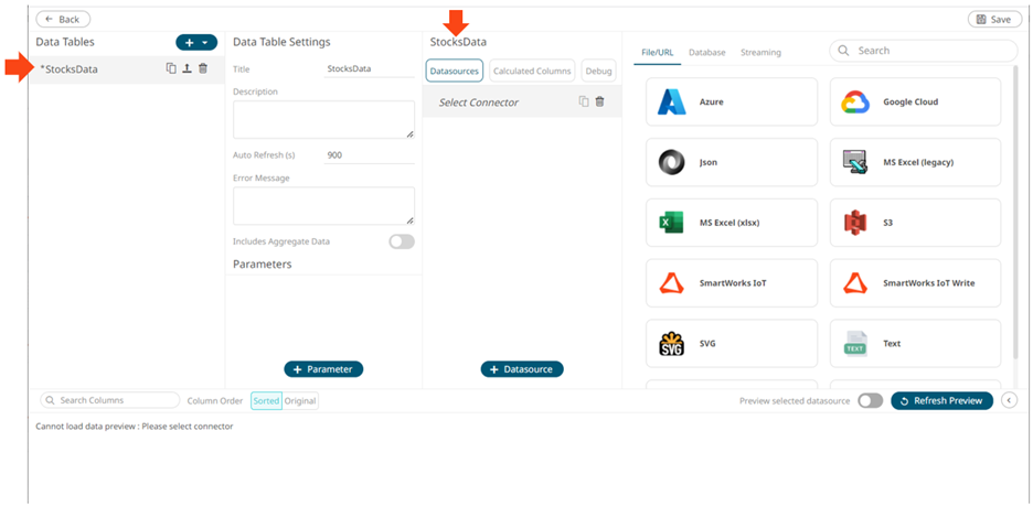

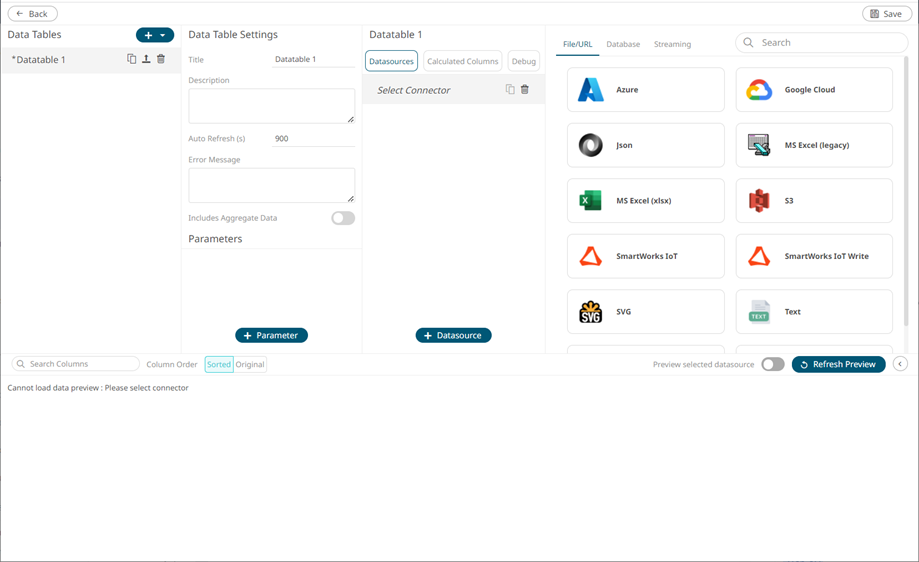

A new data table instance is created.
In the Connector List pane, some connectors require additional third-party software installation to be enabled. This typically requires adding JAR files to the Libfolder of the Tomcat installation and restarting Tomcat. For the supported Elasticsearch connectors, refer to the Elasticsearch Connectors Dependency Installation section. For the other connectors, refer to Panopticon Real Time Installation and Reference Guide for more information.

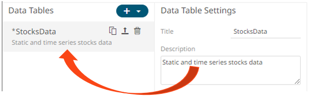

3.     On the Data Table Settings pane,
	 enter the Title of the data table and click
. The new name is applied to the data
	 table under the Data Tables pane and on the Data Sources
	 pane.
4. Enter the Description of the data table.
This is also displayed under the data table instance which can be helpful when selecting among the data tables in the list.

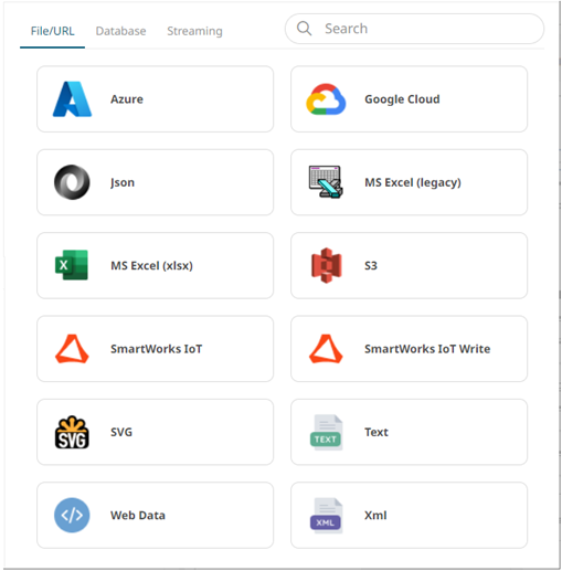

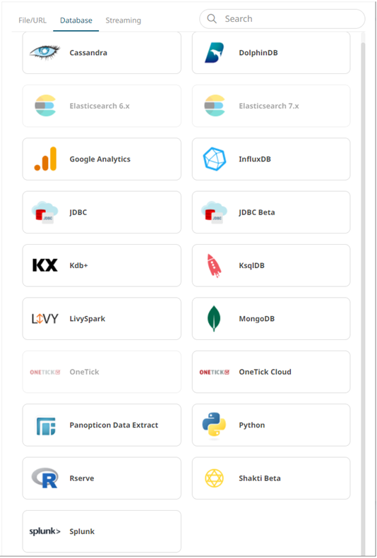

7. To add a data source, click a connector group tab.
· File/URL
Then select one of these data sources:
    · Azure  |
    · JSON  |
    · S3  |
    · SVG  |
    · Text  |
    · Web Data  |
    · XML  |
· Database
    · InfluxDB  |
    · JDBC  |
    · Kx kdb+  |
    · KsqlDB  |
    · MongoDB  |
    · OneTick  |
    · Python  |
    · Rserve  |
    · Splunk  |
· Streaming
    · ActiveMQ  |
    · AMPS  |
    · Kafka  |
    · MQTT  |
    · RabbitMQ  |
    · Solace  |

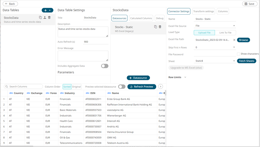

8. Tap the Preview Selected Data Source slider to turn it on and display the preview of the selected data source.
9. Then, you can either click:
 for static connectors
 for streaming connectors
The retrieved query/table/sheet/schema is displayed in the Data Sources pane. The system displays the preview data at the bottom of the screen.
Click
 to collapse the Data Preview
	 pane.
Click
 to expand the Data Preview
	 pane.

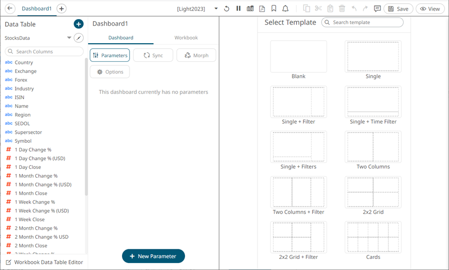

12.   Click
. You are returned to the Open
	 Workbook in Design Mode, with the new data table added in
	 the Data Table pane drop-down list.
