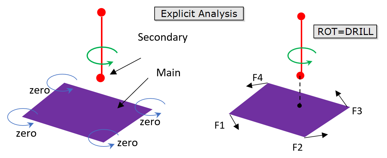

- The ROT option is
supported for both Implicit and Explicit analysis. For explicit analysis where
the main side is shell, if the DRILL option is specified for
ROT field of TIE and freeze
CONTACT entries, the moment on the secondary side will be
transferred to the main nodes as forces (instead of moments) as shown below. For
Explicit Analysis with main side as solids, this is active by default and the
ROT field has no effect.
Figure 1.The following table shows support information for N2S TIE or N2S FREEZE contact (except for N2S TIE/FREEZE contact with a CGAPG core).N2S TIE/FREEZE Contact Linear Static/Transient/Modal Nonlinear Static Nonlinear Transient SMDISP/LGDISP Implicit (SMDISP/LGDISP) Explicit Rotational DOF (Main side is shell) ROT = YES (Default)/NO ROT = YES (Default)/NO ROT = YES (Default)/NO ROT = YES (Default)/NO/DRILL Rotational DOF (Main side is solid) ROT = YES (Default)/NO ROT = YES (Default)/NO ROT = YES (Default)/NO ROT = DRILL is always active and other options are not supported. - This card is represented as a group in HyperMesh.
